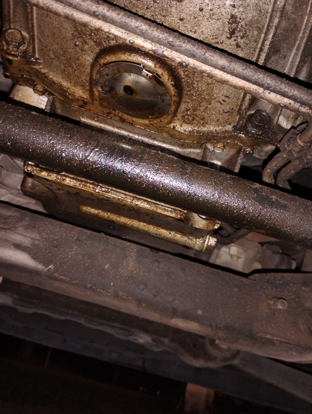

Please help me identify what this is

That's an inspection cover, soaked with a fluid leak. I'm actually surprised how dry that crossmember below it is compared to everything else above it.
Thank you, should the round thing have play in it. When I touch it, it moves up and down.

looks like a possible rear main leak, take that inspection plate cover off and look up in there with a flashlight and tilt mirror and see if the oil is coming from the center of the rear of the engine, if it is dry up in there then the leak is from somewhere else such as the oil pan seal or oil filter adapter plate, valve covers, etc
