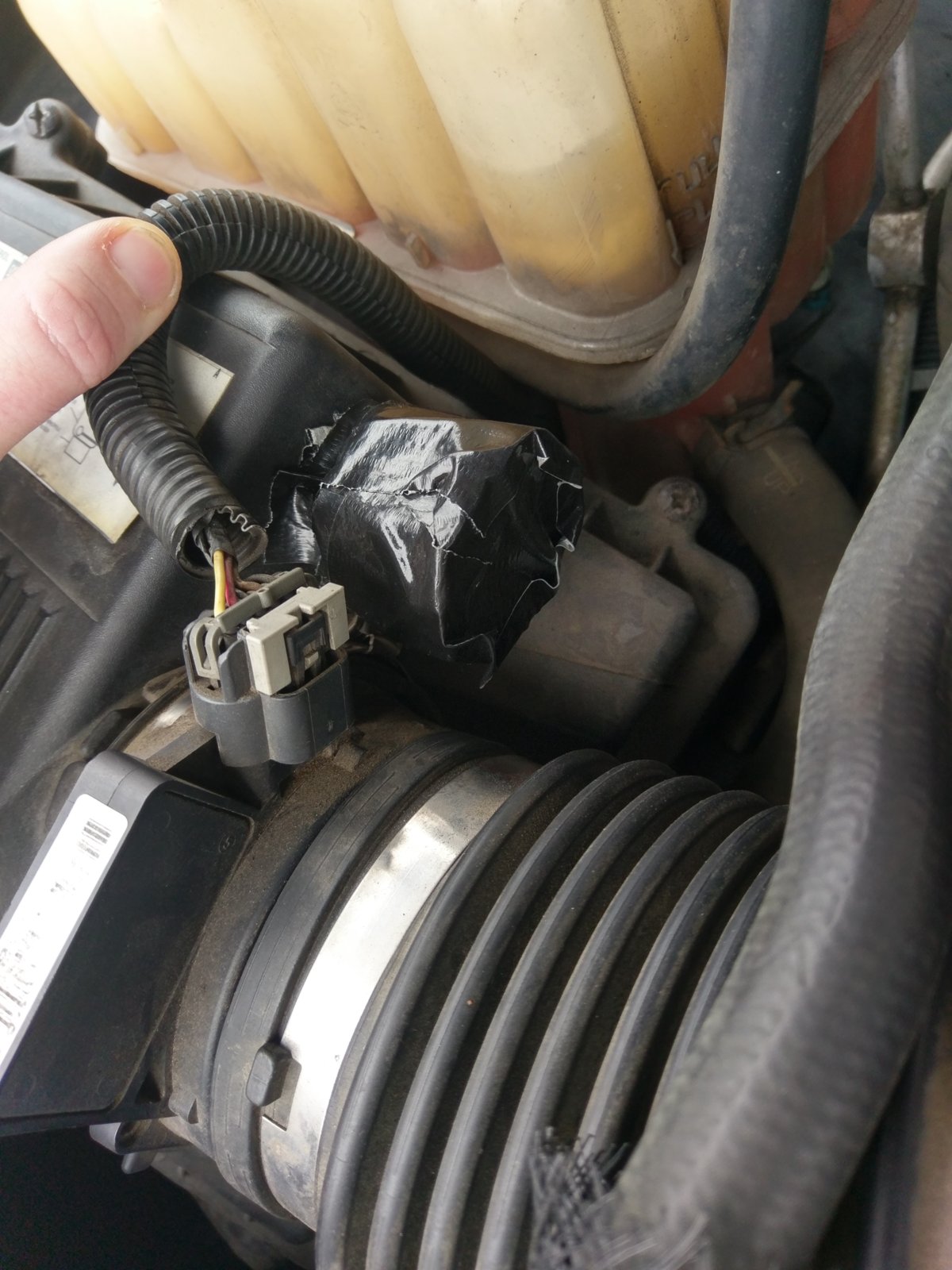

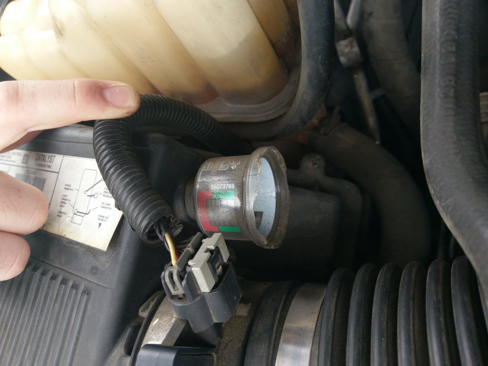

So me and my friend were looking under the hood of my truck and we noticed this on the side of the air intake box:
The top was broken off, so we did this:
We covered it in duck tape to see if that stops the noise or not. I plan on replacing the part either way, I just want to see if this fixes it or not, I'll let you know after this test drive lol.
