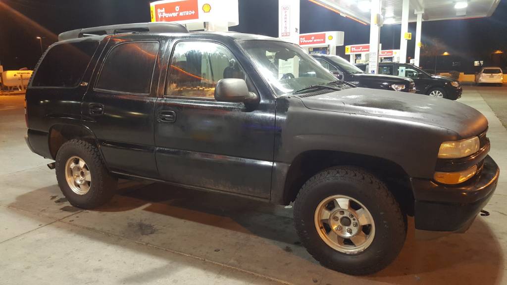

Sorry for post title I don't know how else to title it. I bought truck, former owner PlastiDip'ed it with rattle cans. It's WAY too thin, won't peal and wont come off with a pressure washer.
Right now I'm soaking a sponge in gas, then applying the gas to the side of the truck. I immediately afterwards apply liberal coating of simple green along with dish soap to rinse off the mess plastiDip leaves. Lastly I go over it with a clay bar.
This process is VERY tedious, additionally, I'm afraid of what it might do to my plastic trip. The guy literally Plasti dipped the mirrors, window trim, EVERYTHING.
Is there a better way to do this?
The pic below is the bumper I got MOST of the plasti Dip off of. Took better part of a day. The plastic trim on bottom still has plastidip on it though.

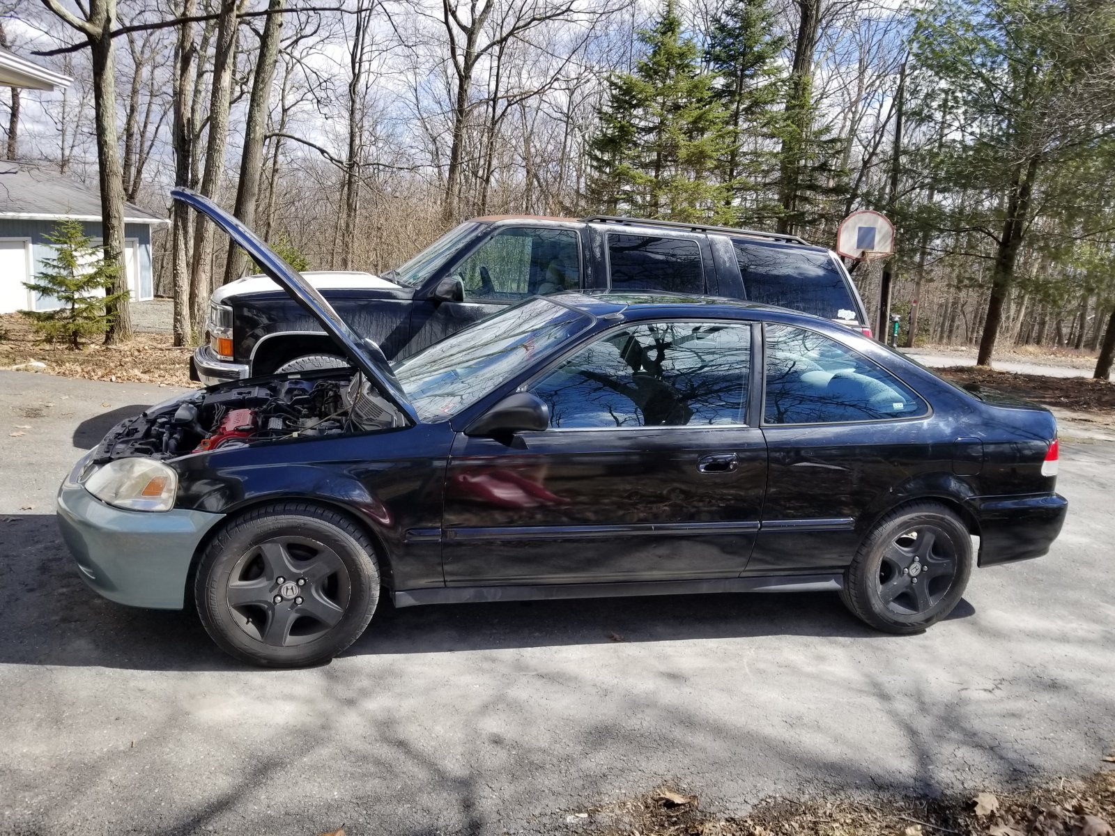

if your still fighting with this i literally just finished my own plastidip hell. wd-40 and paper towels worked magic for mine. i recently bought a 2000 civic coupe for a work beater and some kid coated the rims. first rim i fought with for days with different products the internet claimed worked. found a post mentioning wd40 so i gave it a shot and the remaining residue wiped right off. the next 2 rims i peeled off what i could and sprayed and it wiped right off again. the last rim i said F it and doused the whole rim with wd40. trick there was after i wiped off the excess use a second dry paper towel and start wiping. came right off like elmers glue when you were a kid rubbing it off of your hands. 4 rims 45min

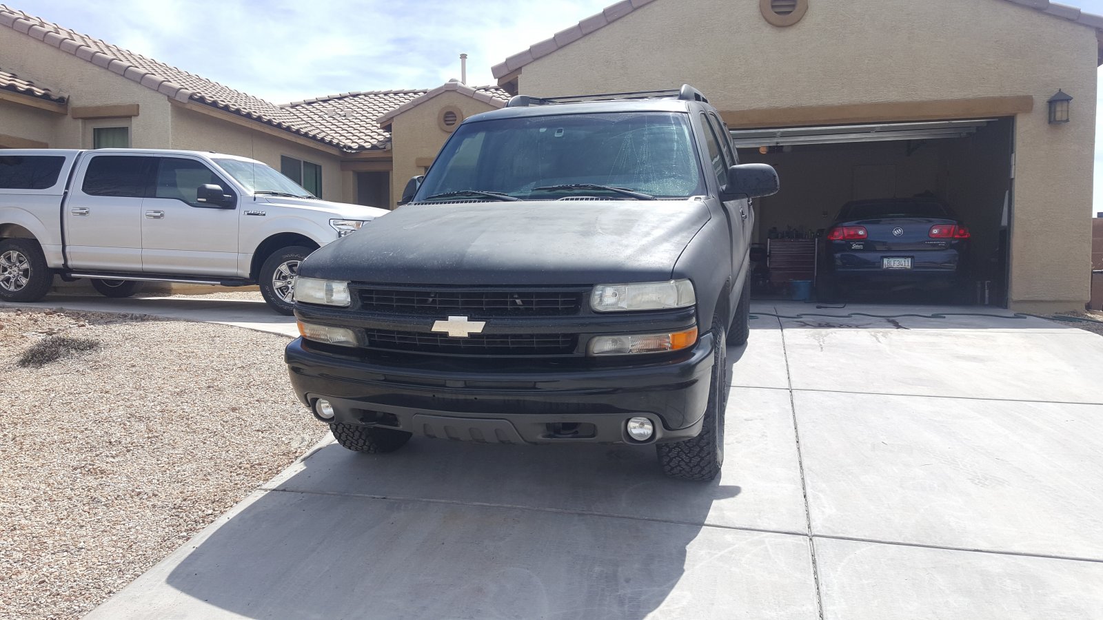

I will have to spray more on and try that as well as the wd 40... the gas fumes may kill me by the time i am done otherwise. But is cominh along :)
One side is partially done, other is still untouched.

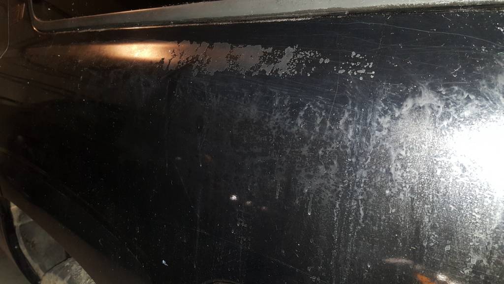

WD40 is way to go no questions asked. My scenario definately required a pressure washer too. However required a couple more things...
1. I applied spray can WD40. Let sun bake it in for a couple minutes.
2. Hit with high pressure from pressure washer. Came off like butter.
3. I used dish soap and simple green solution with pressure washer.
I found if I waited longer than a couple minutes after applying wd40, then the plastidip wouldnt come off.
Also, it mostly came off. There is still a nasy residue to get off. (See pic some of that is damaged clearcoat too. Residue is shows up near flash pop, and is all ofver the truck.) Assuming I buff it with more WD40?
Next, the hood is impossible. Not even WD40 cwas making much of a dent :(
