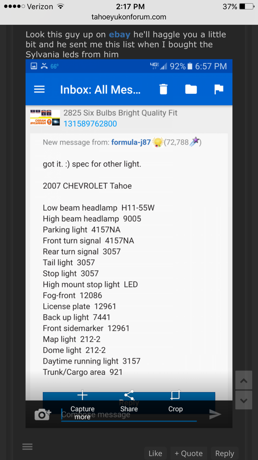

Anybody got a list of bulbs? (fearing I may miss one or more in the wholesale swap attempt)

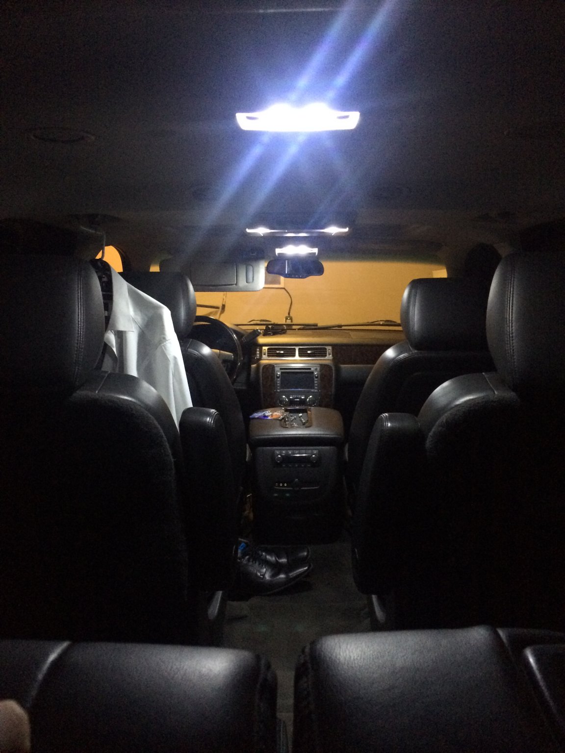

Before and after this is the IJDM TOY kit and these lights dim as they should and they look great i love them i also did the rear plate, side mirrors and flip down vanity mirrors

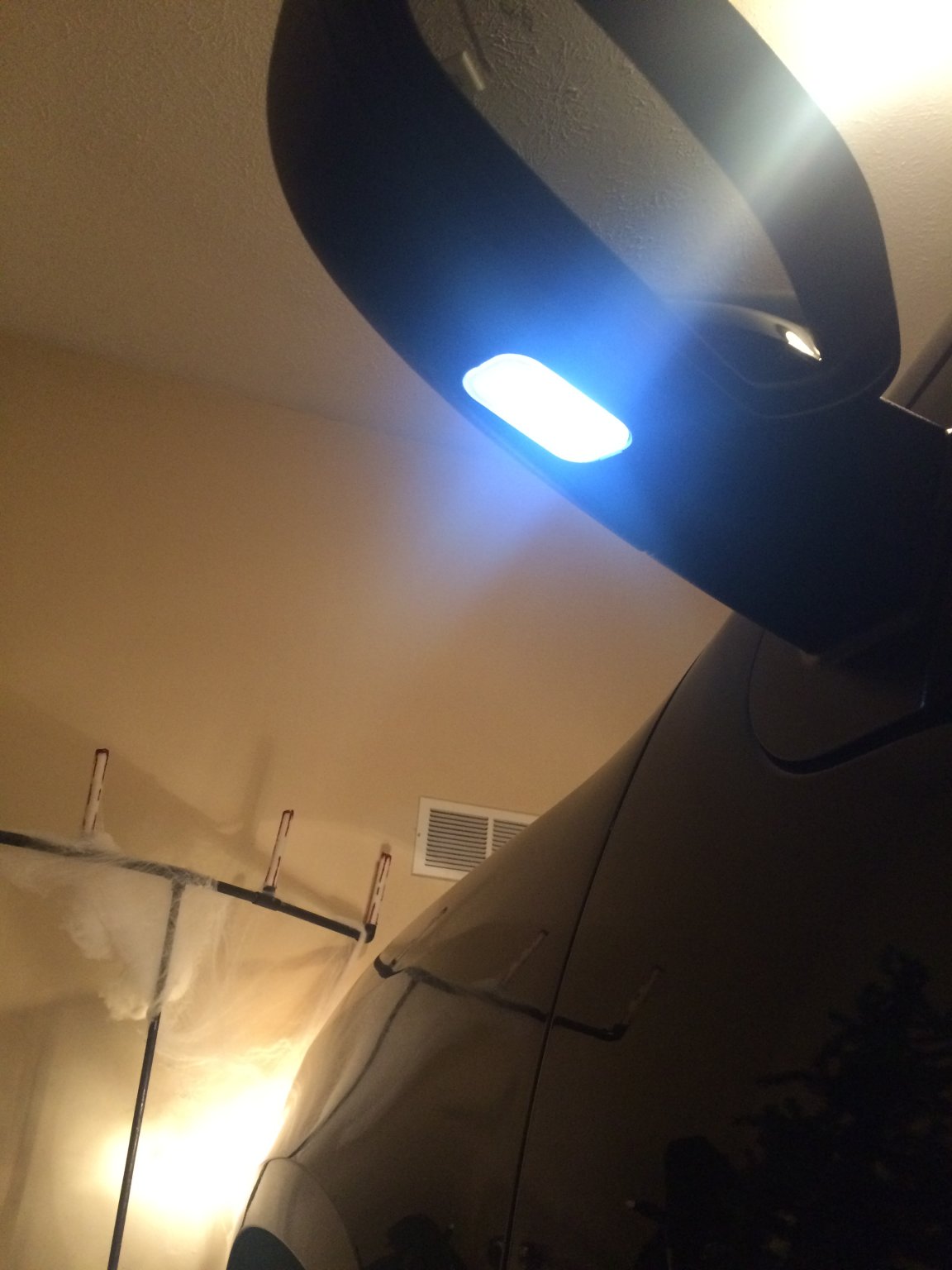

Attached are pics of LED lights I installed tonight. I only attached two pictures but I installed all interior dome lights, both vanity mirror lights, both puddle lights, and the license plate lights. It's LED all around.
Esky smoked tail lights are coming in Thursday, and 5% tint all around will be install Friday (I have 20% now).
24" Black Gloss rims coming next month.
***Ignore the Halloween decoration in my garage on the second picture!
View attachment 60192 View attachment 60193
