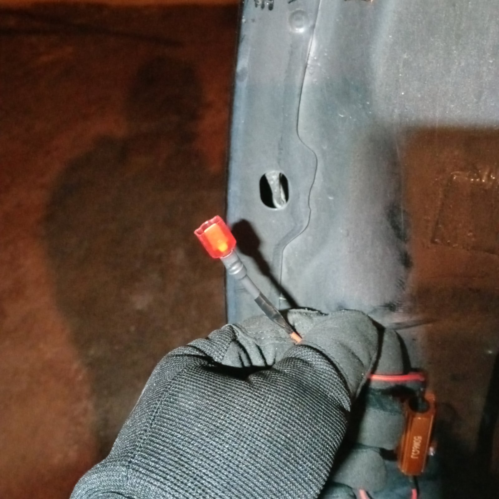

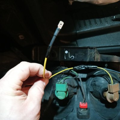

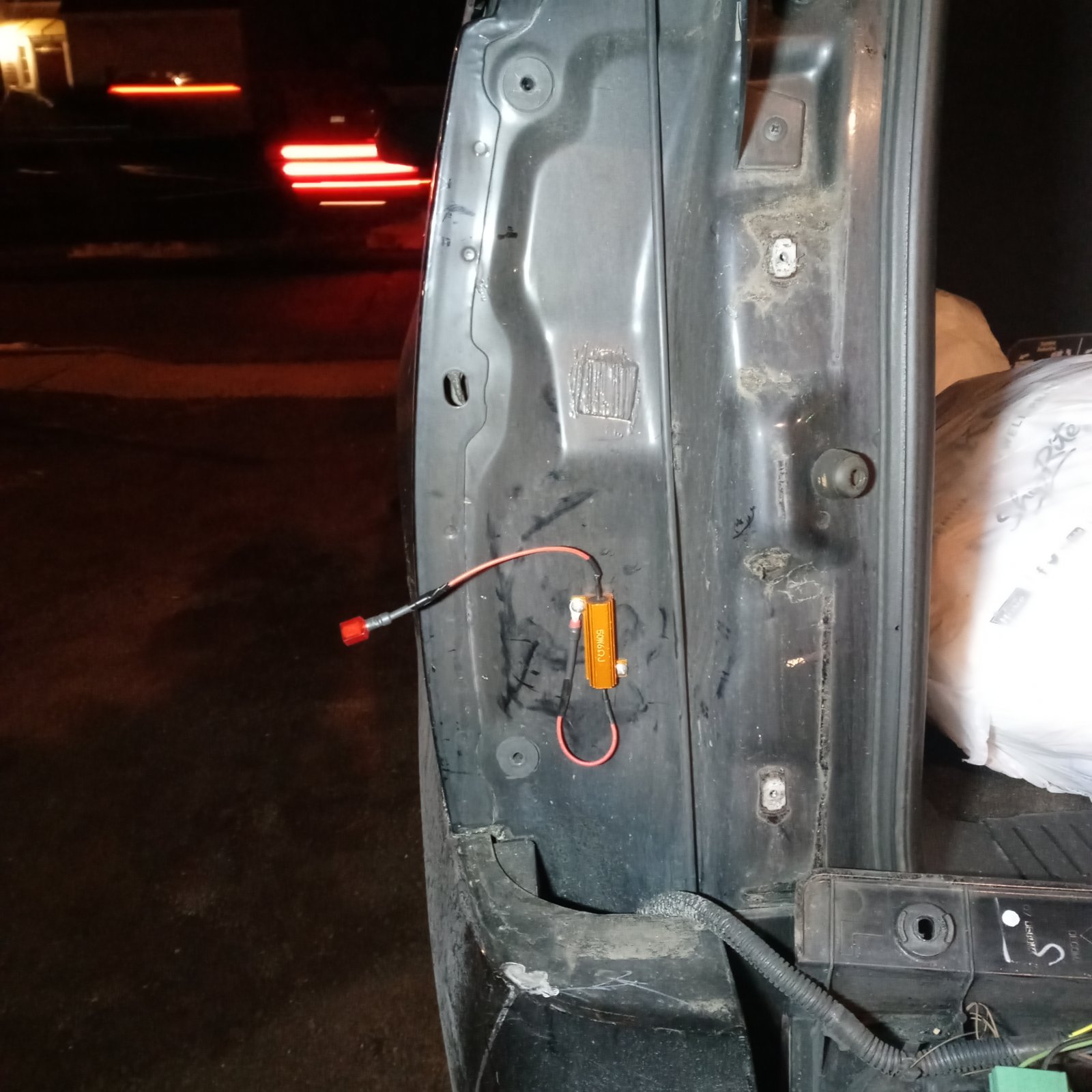

So I have solved the hyper flash on my 2014 Yukon XL after a full LED conversation.
Yes I did have to use resistors but only on the rear tails. The front signals I have switch backs with the built in CANBUS that works great. I did get CANBUS tails but that didn't do the trick and LASFIT also says on their Amazon page they will hyper flash with GMC's. So I am not sure if resistors and a regular LED tails will not hyper flash. When I didn't have resistors there was no hyper flash with Hazards only when I did left or right turns.

Resistors: 6ohm 50W ARTR
Both the LASFIT and JDM ASTAR tails have a great lumen difference between running lights and brake/turn. That was my fear with LEDs, that there would be no difference. So I would recommend those both 100%.
Quick overview of my install of the resistors. I soldered the splice with bladed connects so if I ever have to remove the resistors from the circuit. I also put an eye end and attached via the body screw for ground. Hey one less wire to splice.
I will get more pictures of the lights working but when I finished wiring the resistors it was 10:30 and about 19*.
