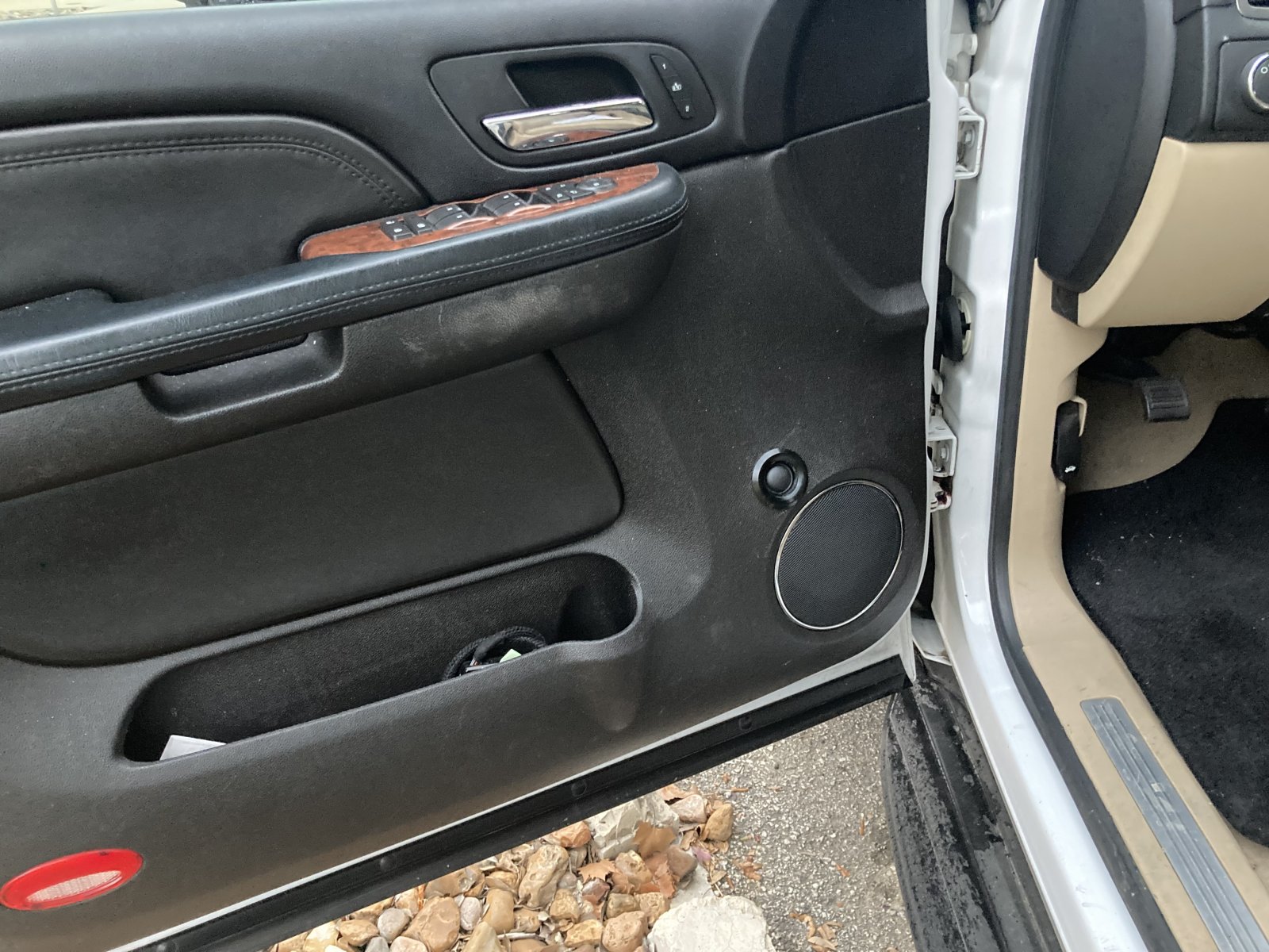

-Sealed up(mostly) both Front L&R doors for audio purposes then deadened all 4 inner door surfaces
-Escalade Black front and rear door panels

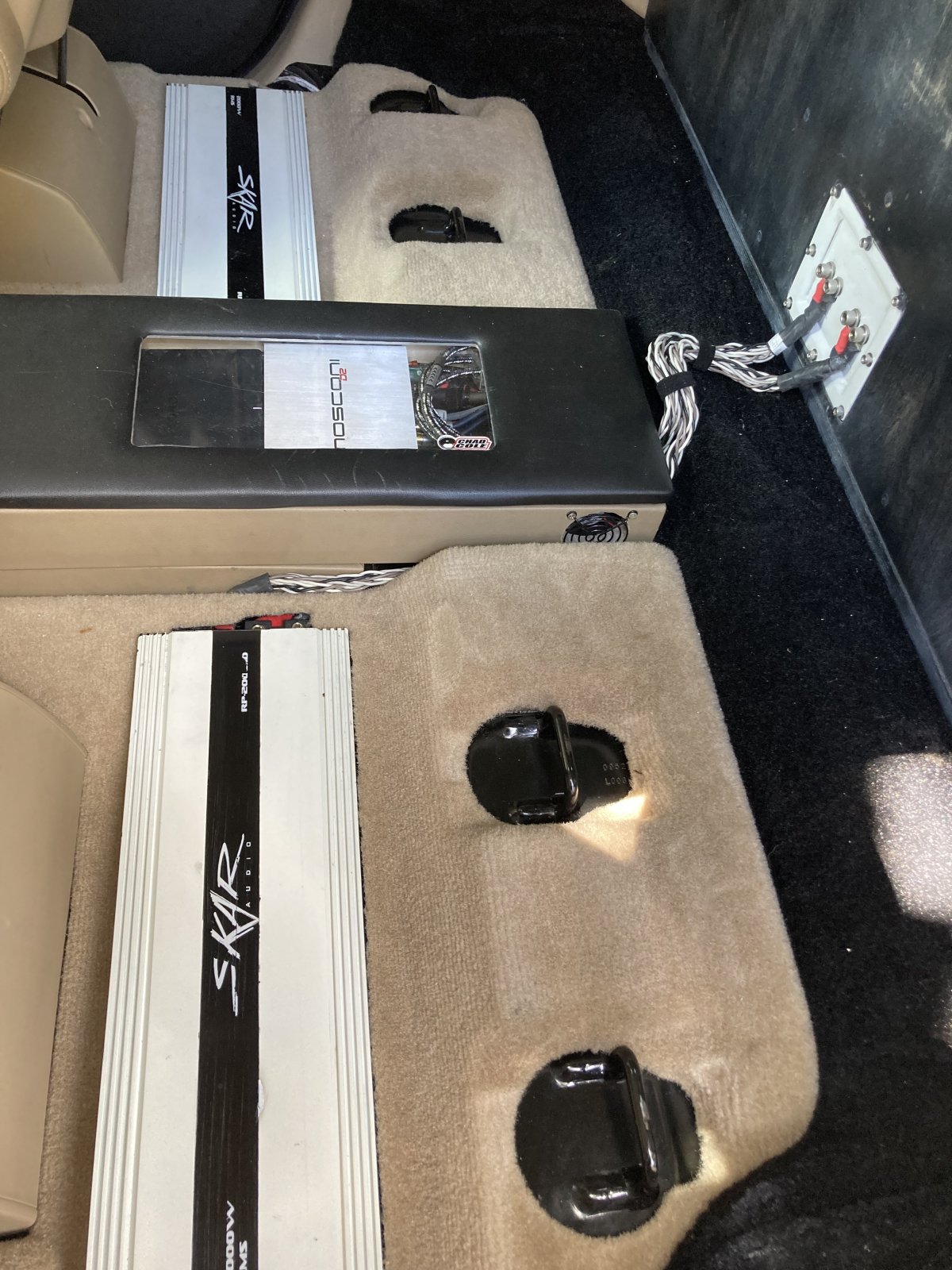

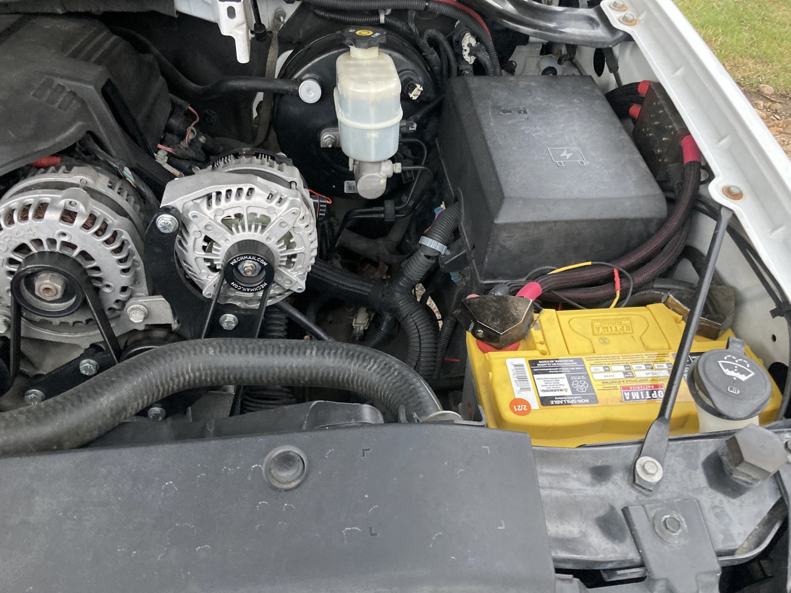

-installed 2nd 300amp Mechman alternator dedicated to the audio system
-2nd Optima Yellow top battery dedicated to audio
-2 runs of 1/0 gauge & 1-2 gauge runs of OFC wire to amplification and processing
-Hybrid audio L6SE & L1Pro active front speakers. Currently working on a 3-way active setup using L8SE, L3SE, and L1Pro R2. Have the baffles made for the 8" and 3" speakers and AS 100.4 and AS 200.2 amps.
-CDT 6.5 2ohm coaxial speaker in the rear running off the factory Bose. For the kids.
-Mosconi Amplification and processing

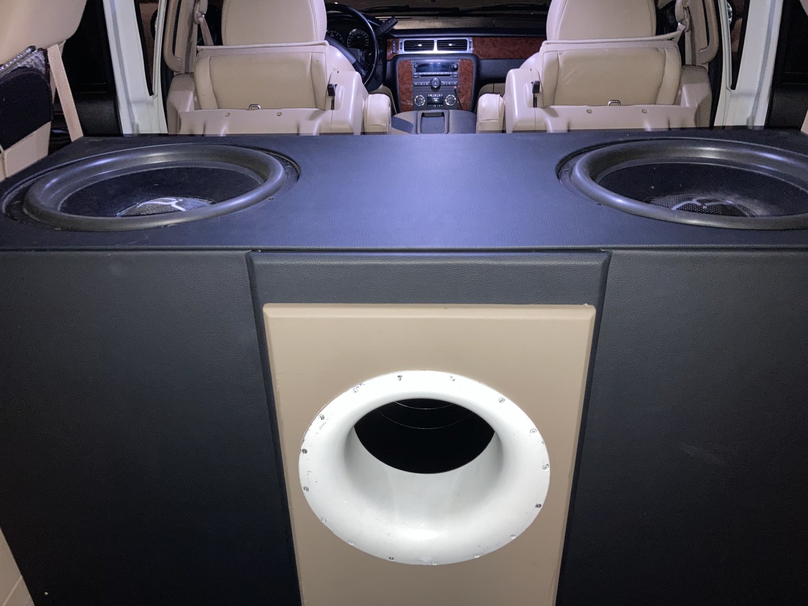

-2 FI BTL 15's powered by, don't laugh dual Skar RP2000.1D amps. Enclosure is 8cu/ft with 8" bigass port tuned to 30ish Hz

Duuuude! You've done a lot of what I have planned for mine. I'm not doing a sound system anywhere nearly as extravagant, but I want my amps like you have yours. I especially am interested in those higher rate struts, your sound deadening/insulation methods (materials, locations and style) and the circuits you tapped to break out the full range signals before the Bose amp. I had a schematic saved on my old laptop but lost it a while back. I'm sure your '07 will be similar to my '08 in this regard.
I recently made a Big 3 setup (actually Big 4, about to be Big 5) and the cables look just the same as yours. I used 1/0 welding lead, soldered and crimped marine lugs, adhesive-lined heat shrink tubing and mesh sleeve left over from a project at work.
