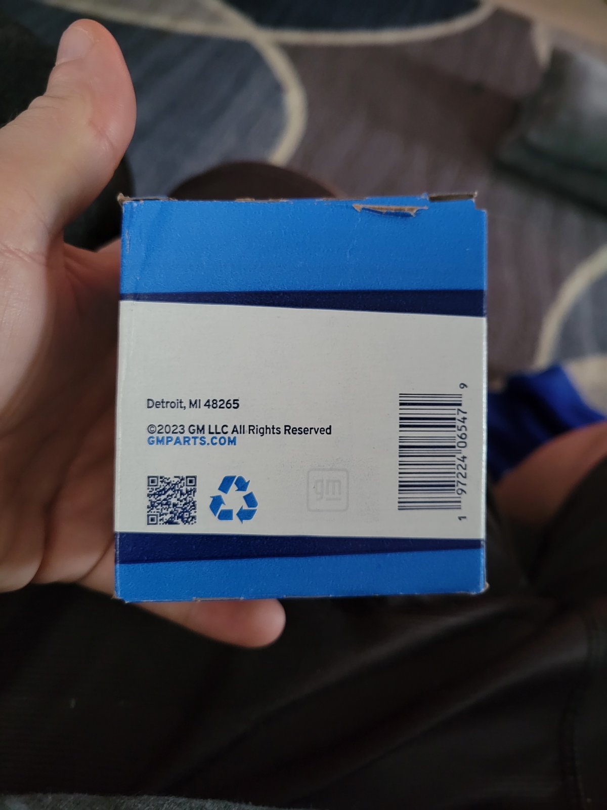

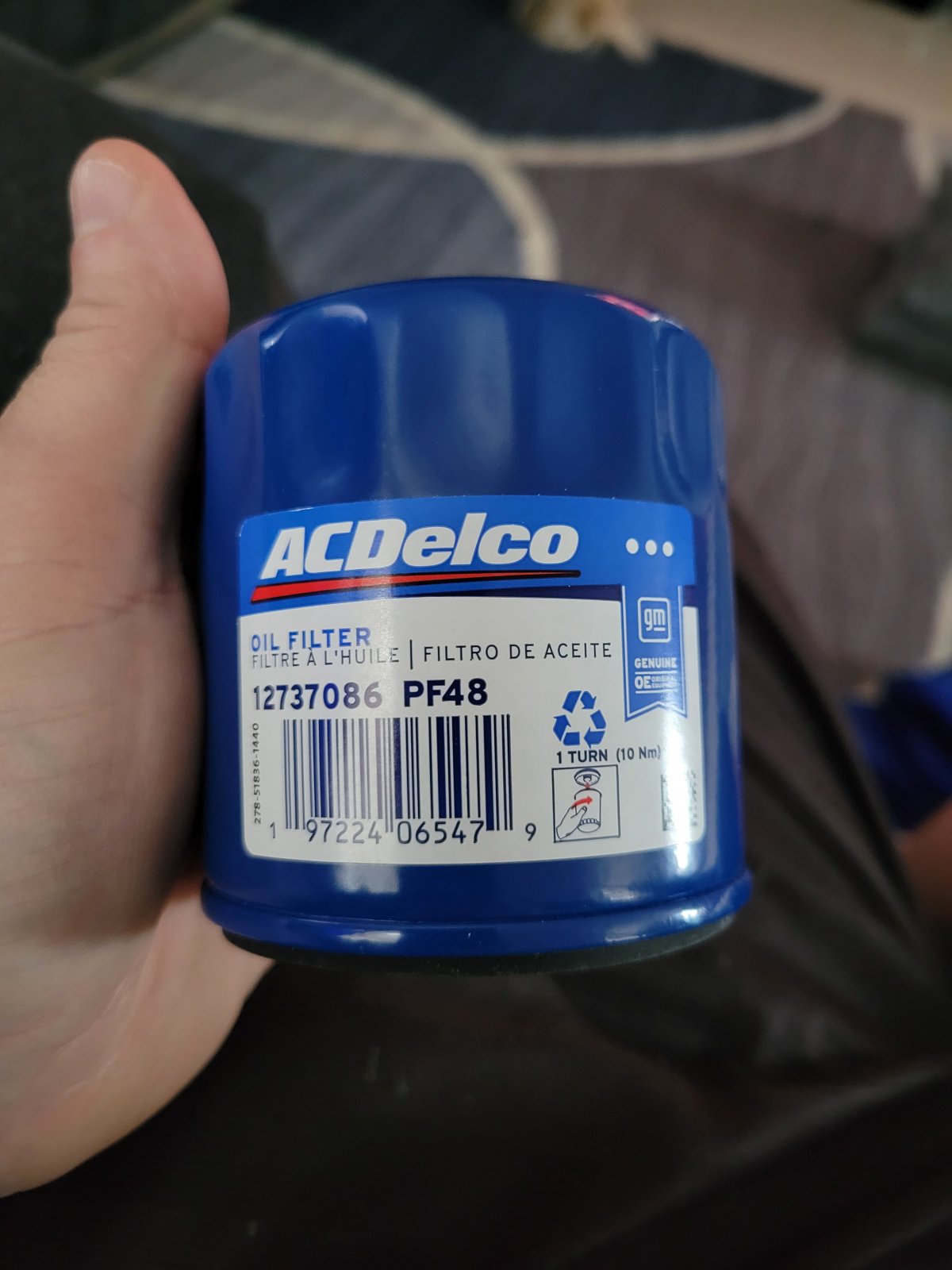

Hello fellas. Had a quick question. I got 2 ac Delco oil filters through Walmart. Of course they always seem to be out of these filters. Anyway. Did they change the 8 digit part number for retailers? Also did they change the design?

If I recall correctly, the pf48 preceded the pf48e. The pf48e is the e-core filter. It has a plastic core inside. The consensus I remember is that people prefer the pf48 for longer oil changes.
Then you have the PF 63. I've ran them on our 2014 Escalade. Same identical filter, just longer and more filter media inside. Some models don't have space for the longer filter, such as our 2003 Hummer H2.
You can look online and read up on the ecore filters and make up your own mind.... I know a lot of people are frustrated because it's hard to find a straight pf48 or PF 63 anymore.
