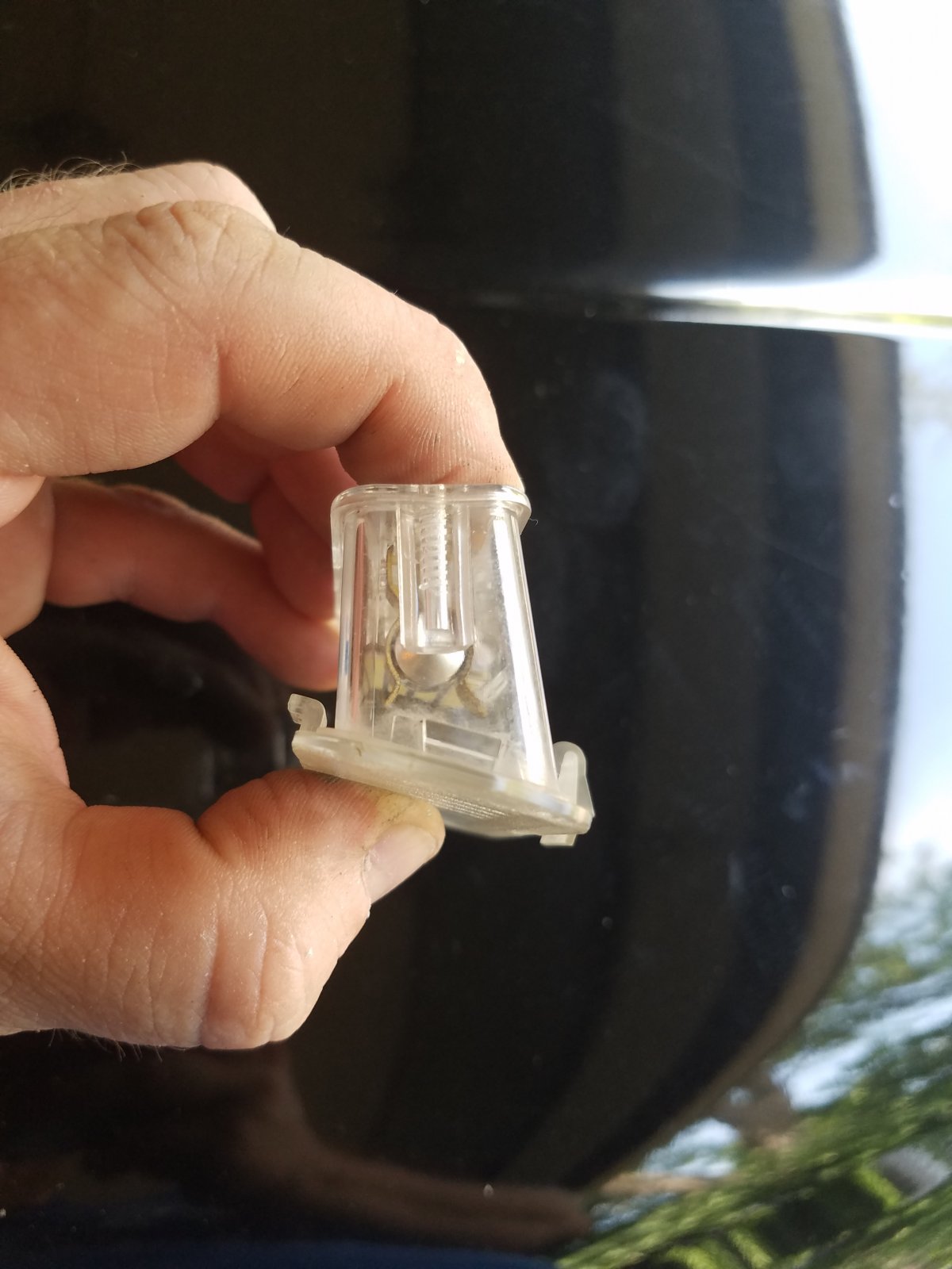

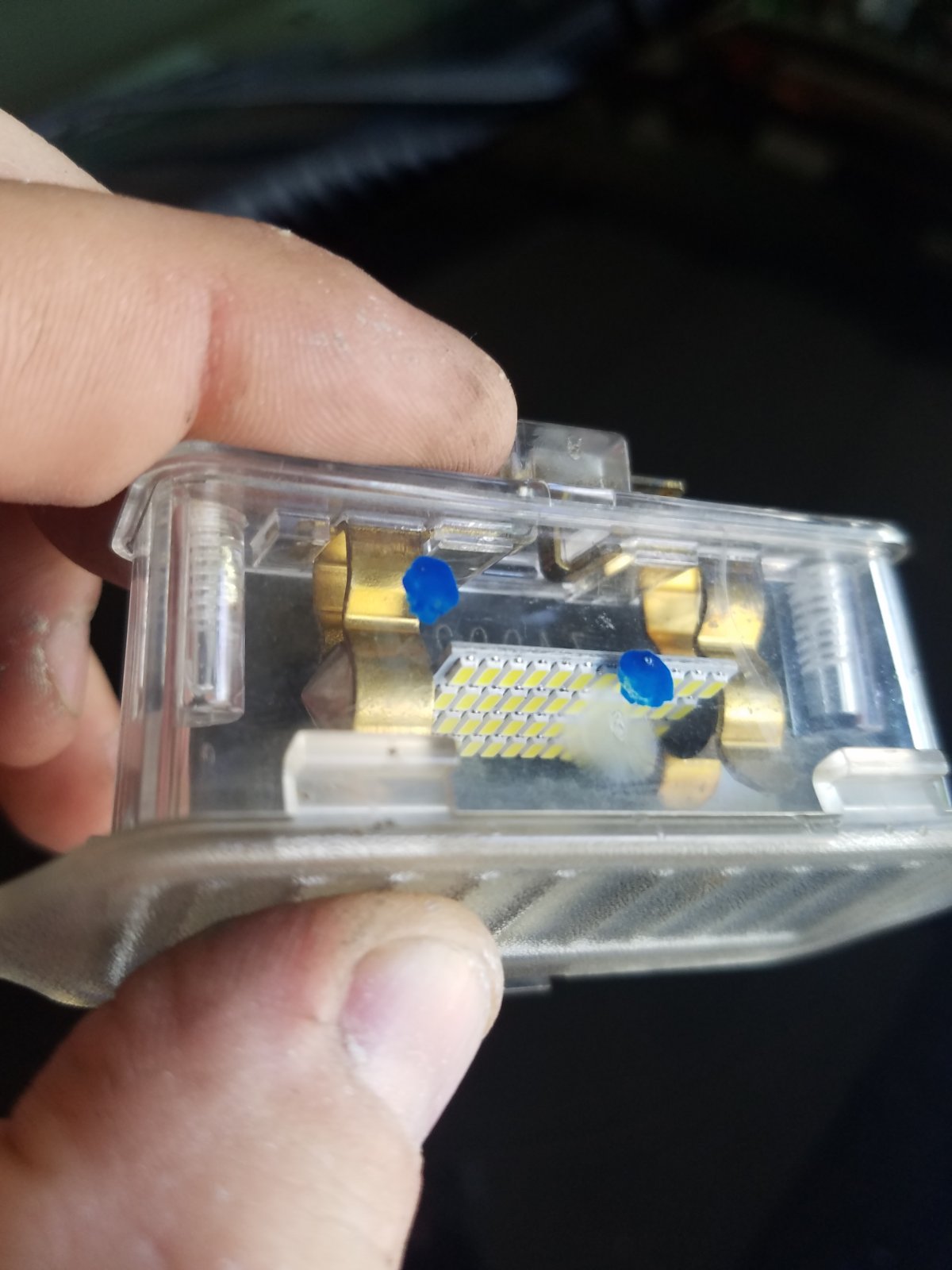

So I've been happily cruising this lovely lady on sunny weekends as often as possible. Finally took a tool to her for the first time today (I believe in a proper courtship).
Had a couple spare LEDs and am tired of seeing the sorry yellow when I'm walking up to her in a parking lot in the evening, so I did the puddles. Same ones I used in the Hoe.
You need to put them in at a little angle to fit the panel in the housing. Works well, though, as they end up perfectly parallel to the ground.

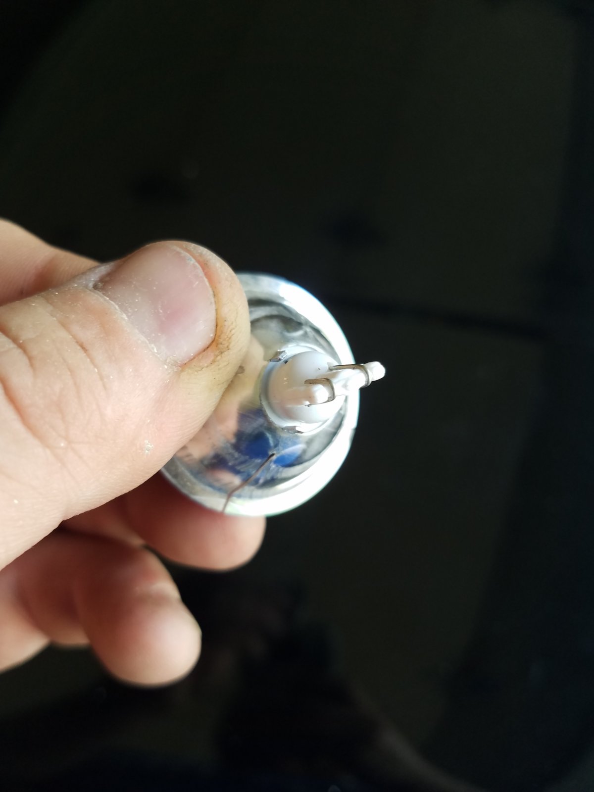

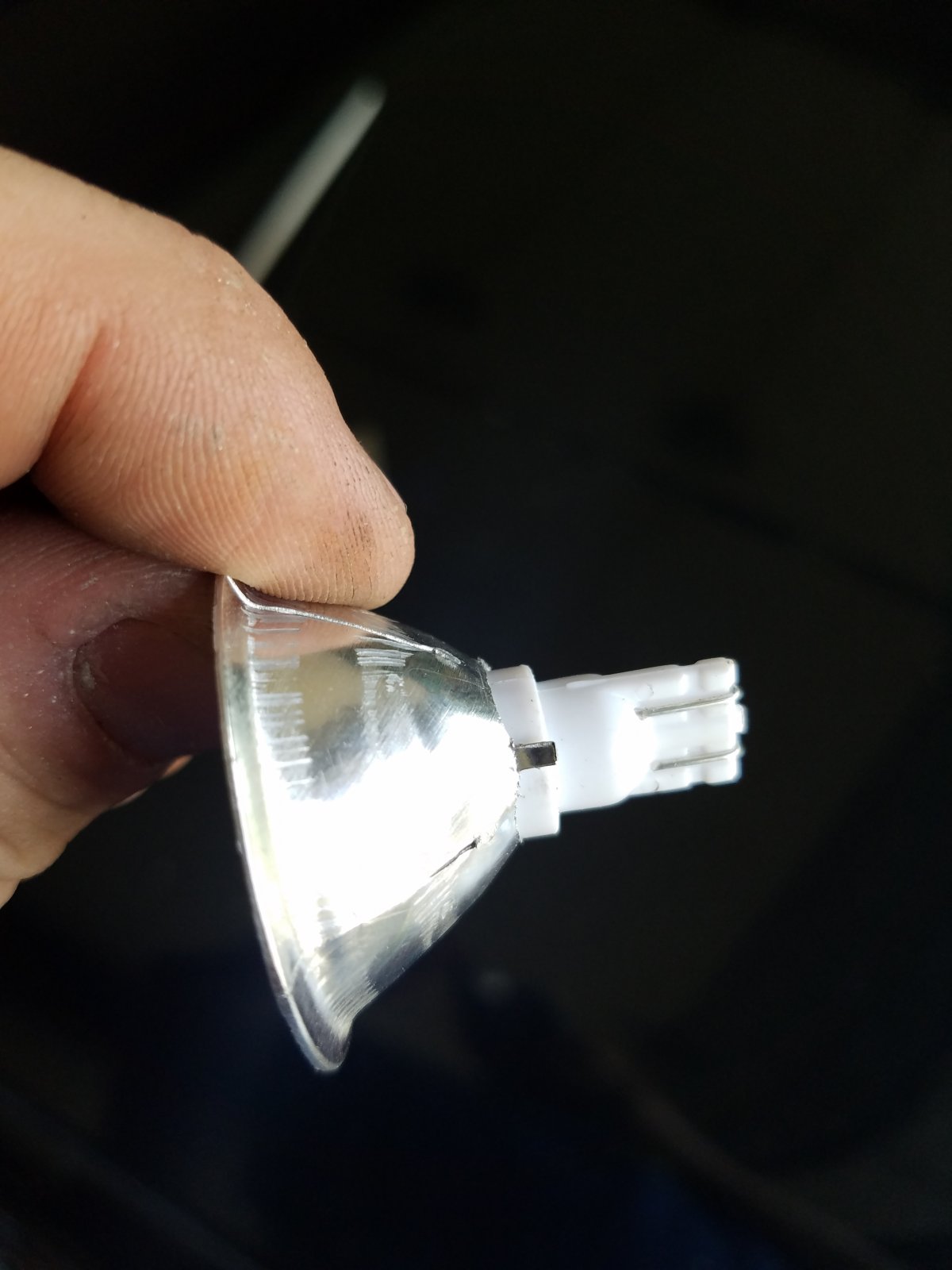

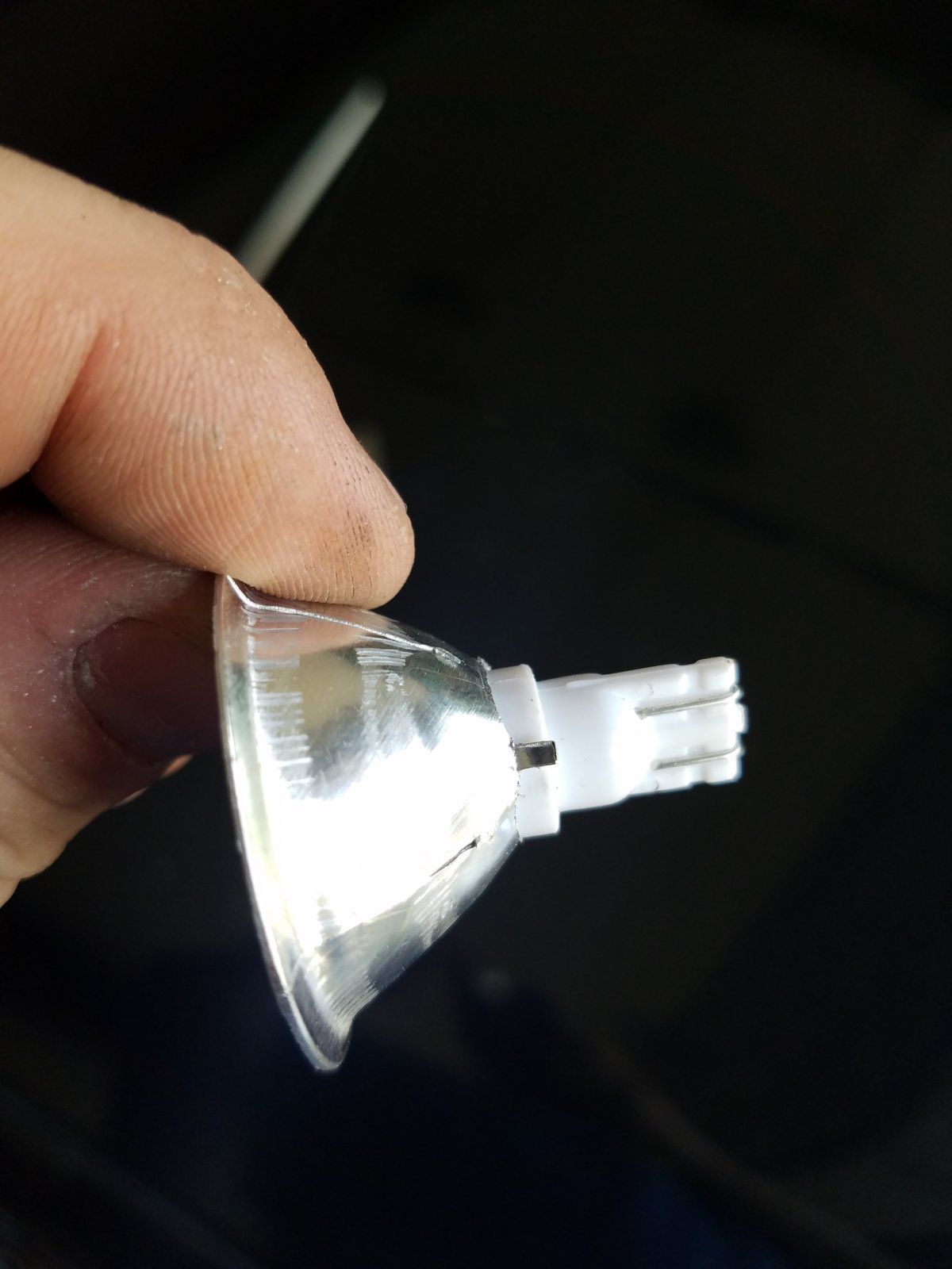

Found a couple leftover map lights, too. Again, same ones from the Hoe. Have been very happy with them.
You need to take a little rattail file to the reflector cone to get them to sit all the way in. You want the white plastic collar through the cone and the silver housing to mate up.

Finally , all this thing needed was led lights all around :happy107: . Pete wasn’t about that led life lol
Since those are single facing leds I just take the reflector completely out. Don’t have to fumble with it putting it back it and it gives a cool blackout look to the light when off.
I prefer them in there. Did the same thing to the Hoe. I know the bulbs are directional, but I tried them with and without the reflector in the Hoe, and they are definitely brighter with it. Maybe because of the lens.
It’s a optical illusion :secret: lol jk . I just like the black out look and it’s still plenty bright. I have the rest of my interior lights blacked out too, still super bright.
