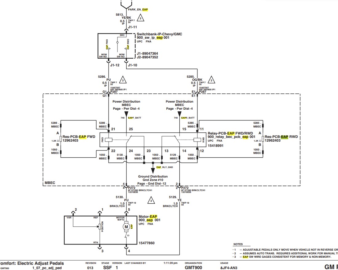

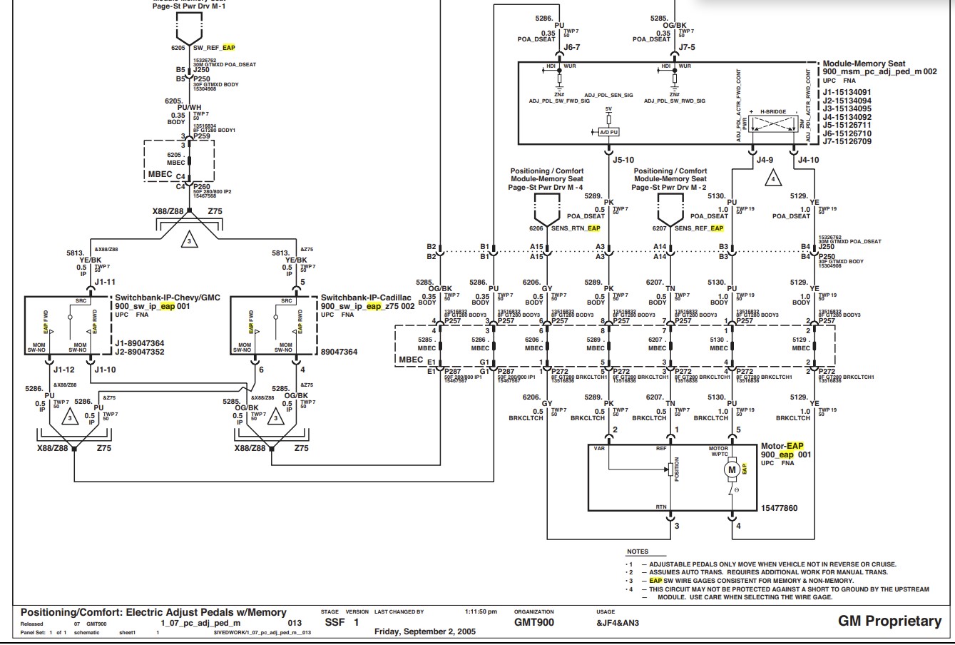

Looks like a purple and yellow wire to motor. See if there is voltage there.
If you have memory seat module, then the switch signal goes through the MBEC to the memory seat module which sends power through the MBEC and to the motor..
The pedal adjustment won't have much to do with brakes other than pedal position. Since you hear a clicking sound, I am guessing your switch works. Try and pinpoint the sound if possible. Seems like it would have to be the relays in the MBEC or the motor gears. You could try and apply power/ground to pin 4/5 on the pedal assembly to make sure the motor works.

I'm guessing the seat memory module is under the seat.. It could be motor is shorted, or wires to the motor, or module is bad, or sensors on pedal position.
That narrows it down to everything. You're welcome!
:joke:
Check for power on the purple and yellow wires. If there is power, then check the motor by powering it manually or measuring resistance maybe.

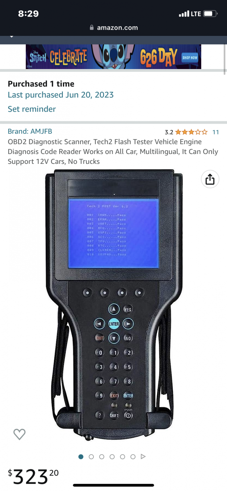

So shop Manuel I found and it looks like ont that is on line. Any suggestions. Also take a look at the attached pic. All look good.? Thank you
Ken

not sure what the "no trucks" is about. Might want to check with seller. Only sold 1 time previous so one more thing to consider.
chinacardiags.com has been mentioned before and it looks legit. They say 12V cars and trucks just no heavy duty 24V trucks

yeah the China diag site seems to be the most common. that's what I used from this site too. and then just wait till it comes. it might give you a code of what's wrong. mine told me a I have code for a stuck or shorted lumbar motor in the passenger seat. I didn't even know it was broken lol. not something I've decided to fix, but it might tell you if the motor is shorted or open before climbing under the dash. and you might even be able to request movement from the tech 2. which would eliminate the switch being bad. at that point I don't know if there's a replacement motor or not.

Thank you both for the good idea and link. One more thing to ask. Could you link the one that is for a Chevy Tahoe 2011. I found the site and yeah there is a lot to look at. Just point me to the one I need. I may cancel out my Amazon purchase.

I found the link off this site in this thread.
I got I got this one.. it was a little cheaper because it didn't come with a plastic carrying case. I kinda wish I would have got the case one.
and here's a super long thread with tons of info and a good place to ask questions about the unit itself https://www.tahoeyukonforum.com/threads/tech-2-purchase.111719/
