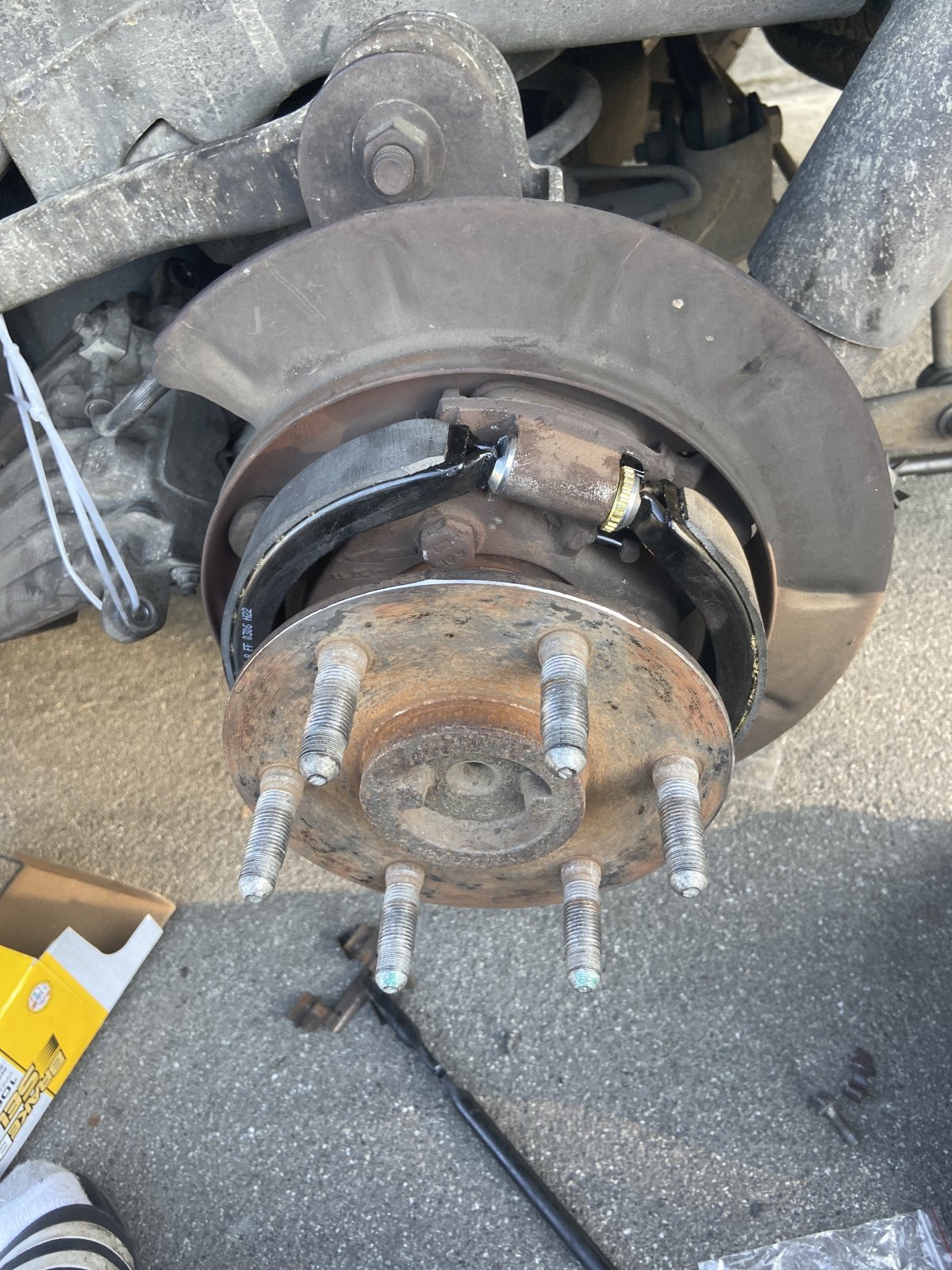

You're right that the circled item is an adjuster, but it is not a "self" adjuster.
Self adjusters need an actuator assembly that puts some pressure on the adjuster like in the diagram below:
There is no such actuator in our parking brake system. We simply have the star wheel (adjusting assembly).
Okay then! I could swear I heard them click to adjust when engaging the PB in reverse periodically. So that is strictly for manual adjustment then. This is good to know. Thank you for correcting me.
