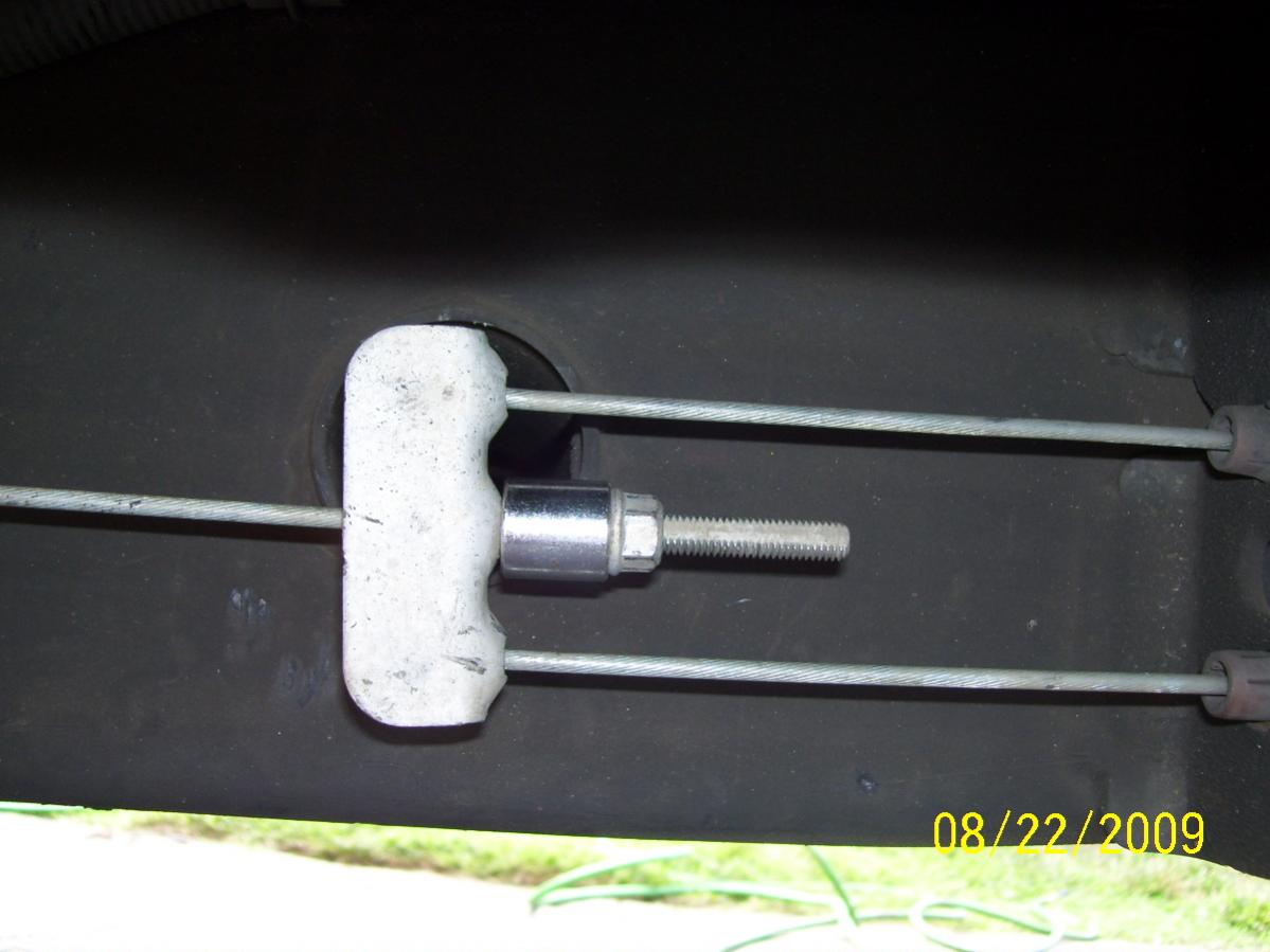

My money is on loose cables..there is a fix in forum post link below. it utilizes a spacer to allow more travel of rod/cable through adjuster bracket under bottom of truck. a stack of nuts with an inner diameter large enough to slide up and down threaded rod will also work in lieu of spacer.
Thanks, I remember reading about this fix years ago. In my case this isn't the problem. I have lots of adjustment left on the adjusters at the brake shoes. My problem is that once I have them adjusted so that they are just touching the inner hat, the parking brake pedal doesn't feel as firm as I would like it to be. If I were to add spacers as in the picture, the parking brake shoes would be definitely rubbing.

Ahh, i see. Well, the loose cables are a common fail so hopefully it will help others that end up on this post tracking that problem. Good luck on your quest. I had it and my co-worker had it and spacers tightened things right up.

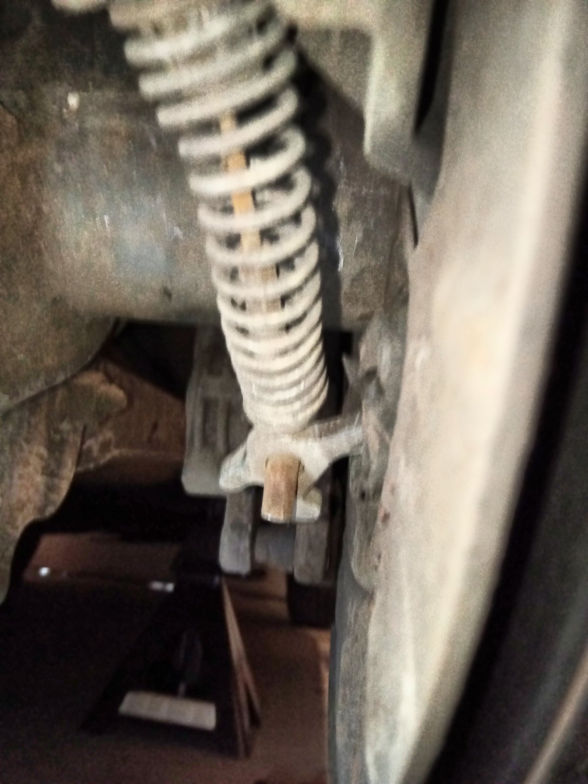

Well, the parking brake has worked well until we got a freeze, lows to -13°C for a few nights. I used the parking brake out of habit, and now the mechanism appears to be jammed on the right rear. In the picture you can see that the level has not returned to its completely released position. It has warmed up enough that ice shouldn't be the issue now, so I suspect that something shifted mechanically. Any ideas?
I will be pulling the parking brake shoes off next, and disassembling the adjuster next. I may have to pull the cable right out from the lever and reposition it, but I hope I don't have to go that far.

I agree that the lever on yours isn't fully returning.
Mine's an '04 so I don't know if the cables attach in a different orientation, but the few cable hooks I've seen (on the passenger side) hook from the bottom up. That has to do with the bracket orientation on that side. Confirm that the return spring isn't contacting the axle tube; your pic is a bit fuzzy so hard to tell.
If there's no tension on the cable those aren't usually very difficult to pull out of the lever.

@Fless thans for that, and the picture.
It seems that the lever that goes through the backing plate may have dislodged from the pill that connects to the adjuster and brake shoe. Perhaps when I last released the parking brake, the shoe didn't return as fast as the cable and that pill got lodged? Anyway, i've got it back together now and working. I lubed the heck out of the lever and inside the adjuster to try to prevent freezing again.
