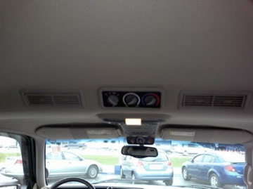

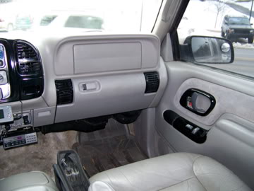

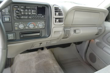

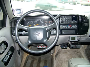

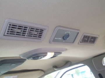

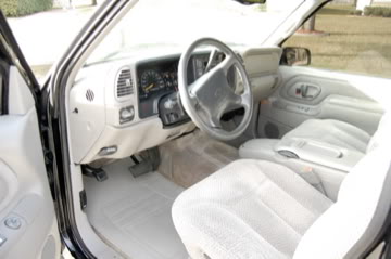

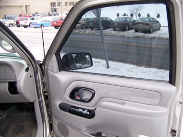

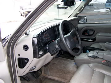

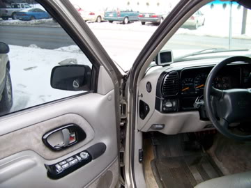

SO hear are some pics I pulled off of Autotrader.com after i had forgotten to take before pics, (I know they are different)

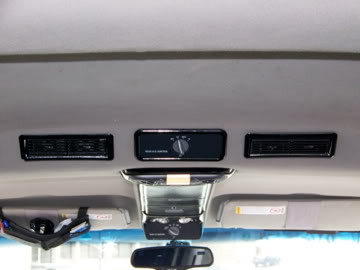

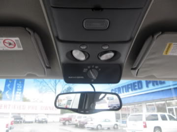

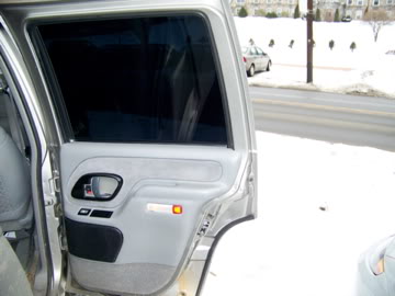

And the After....
