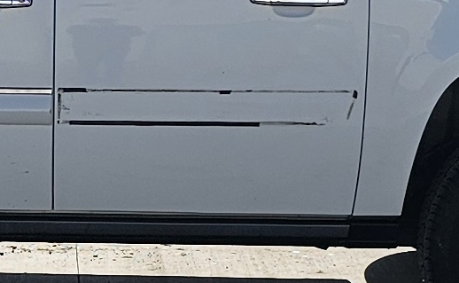

Factory stuff is 3M Emblem tape, About 1/16" thick double sided and if used right it's permanent. If you can get the whole molding off, clean it really well, clean the paint, put a tape line to get the molding just right, and reapply. (edit) as Fless pictured just now.

3M VHB tape
Clean both surfaces and wipe with rubbing/isopropyl alchohol prior to application
Apply the tape and press hard for 30 seconds to allow the adhesive to wet into/onto the surfaces. Best to do one side at a time.

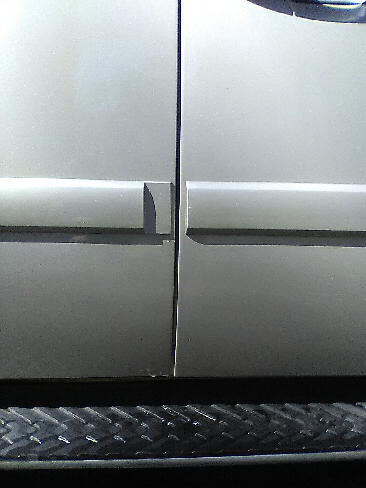

The 3M tape worked like a charm.
The front of the rear door piece (left piece in picture) was bowed outward about 3/8" and the rear of the front door piece (right piece in the picture) was out about 1/8" inch.
Using a hair dryer made the bowed rear piece supple and it pushed right back into position and the bow did not spring back.
The hair dryer was also used to heat the body panels up because the weather was colder than the recommended application temperature.
Neither piece was taken off so it was a bit of a struggle to get the old tape's adhesive out of there and to clean the contact surfaces in the minimal finger space. The old adhesive was stuck to both moulding and the door panel.
Both were in spots where a clamp could hold the joints tight for a while and that seems to have been of help because they both are holding tight.
