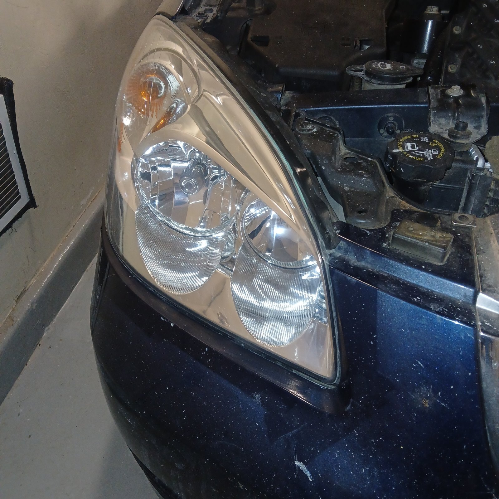

Thought I'd share this here. I've bought all kinds of those headlamp restoration kits over the years. I even tried the tooth paste polishing method. All subpar results. I decided to come up with my own process and executed most of it last night. Was FLOORED at how good my headlamps look. Two were purchased new and the other 6 (including brake lights) were done with the process I came up with.
Instead of using those kits, I bought a 2k clear coat spray can. Sanded all the oxidation off 240, 320, 400, 600, then 800 grit. Lastly cleaned with solvent and shop air and applied adhesion promoter followed by light coat, medium coat, and THICK coat of the clear coat.
The results were INSANE. One of the headlamps is brand new in the photo below. You'd be hard pressed to tell which one. If you look close you can see some inconsistency in my spraying but is only way.
The before picture wasn't before. They were WAY worse. It was a photo from my archives. I should have taken a picture before I dove in. The headlamps were HORRIBLE. I could barely see driving at night with them.
I have plans to seal the headlamps with ceramic coating now but have to wait a month for them to fully cure. That process will be:
1000, followed by 1500 grit sandpaper.
Heavy cut, medium cut, fine cut, and lastly machine polish.
Clean with solvent and shop air.
Lastly seal with ceramic coat.
So amazed at how good this turned out in comparison with the off the shelf kits. I've only ever gotten *meh* to *ug* results with those kits. This worked like a dream. Only thing is the clear coat is spendy! However, I was able to do 10 lenses with it so you'd better have a few to do if you plan do to this as the clear coat only lasts for about a day once mixed up.
Picture after.
Note before picture was a photo from when I bought the truck (8 years ago). They were FAR worse when I painted them yesterday. They were to point I could barely see driving at night. One additional note, one of the lenses below was purchased new from TYC, you'd be hard pressed to tell which one it was.

I made it back to polish my car headlamps after one month of the clear coat setting up. They look INSANE. Probably even better than NEW.
I did color sanding. Might be worth doing this "color sanding" process on even new lenses. Here's what it is...
After one month of the clear coat setting up.
1. Sand lens with 1000 grit
2. Sand lens with 1500 grit
3. Sand lens with 2000 grit
4. Sand lens with 3000 grit
5. Polish lens with heavy cut and a buffing wheel (I used one that fit on a drill)
6. Polish lens with medium cut
7. Polish lens with machine polish (very fine cut)
8. Clean lens with wax and grease remover until NOTHING shows up on shop towels
9. Blow off lens
10. Apply a ceramic coat.
I really should have taken a picture before all this then after. You can see a small hazy spot in lower right corner of lens. This is what it looked like before. I was unable to reach down there with polishing wheel so I just let it be.
