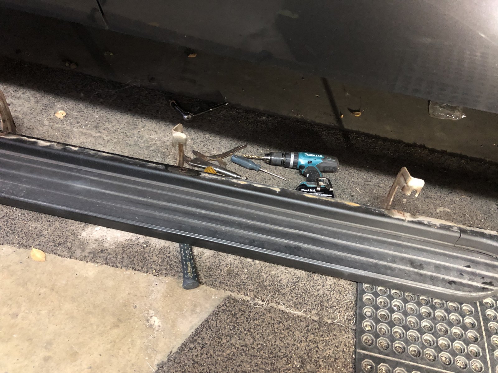

Man, I'm scared to take my running boards off.
I've seen a video on tipping/forming metal using a wood buck that really opened my eyes on repairing some of this body work. It's a lot easier than it seems to. I think the hardest part is making the buck with the correct angles for each body part. His channel is "Make It Kustom", really cool sh*t if you're into that kinda stuff.

I have had more than my share of that and trying to fix them, do not miss that at all.
Its kinda fun,Im able to just close the garage door when I want or get tired off it.Would be better if these pieces weren't so complicated.Winter is knocking at the door also so kinda pressed for time.

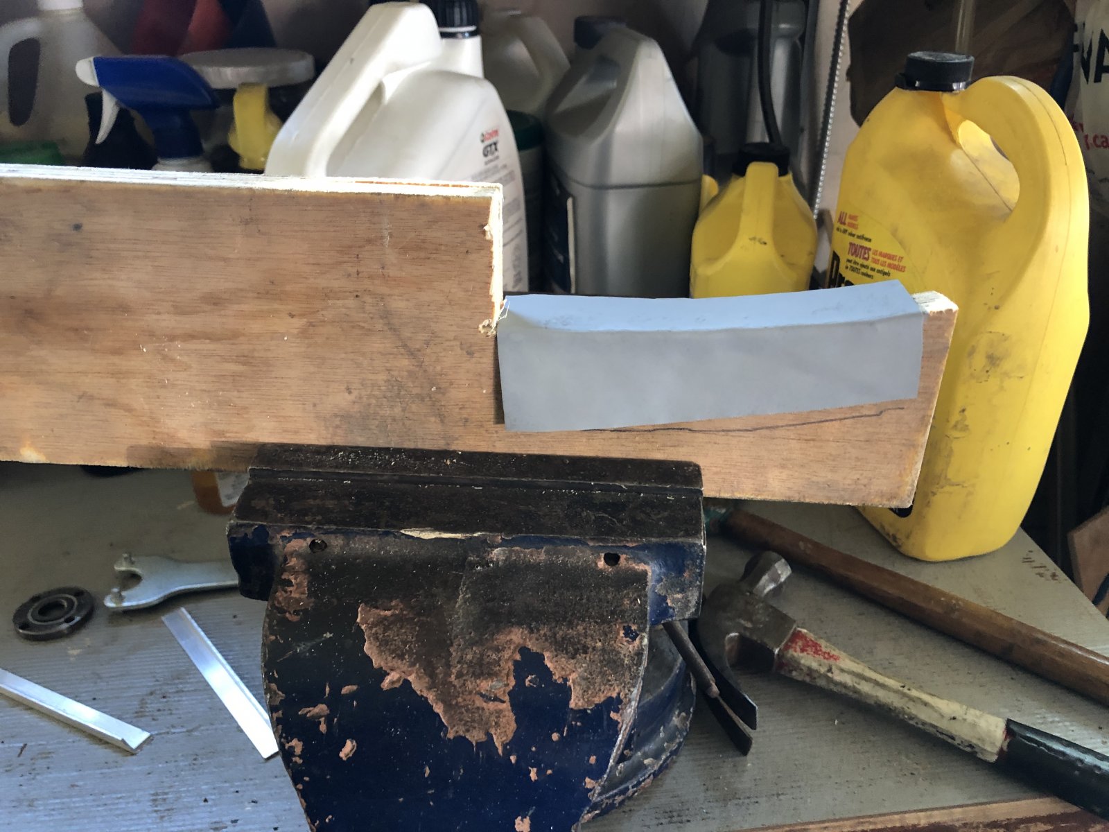

Yeah I’ve been using whatever I have around to bang the metal into shape. Wood is easy to shape. This new piece though is a bit tough. May have to split it in two shape then weld back together not sure. I’m just looking to have some solid metal that I can bondo over.

Yes, wood is definitely easy to work with
Ahh very cool
Nicely done

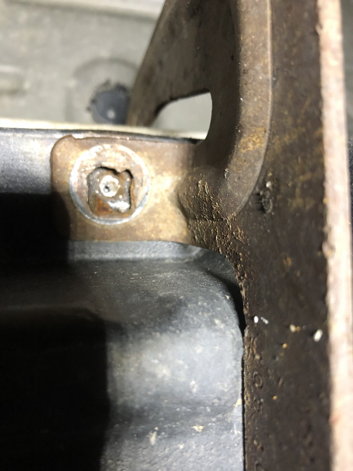

Rockers are fine,a little surface rust around where the vertical bolts go.Was fully expecting holes but nope.

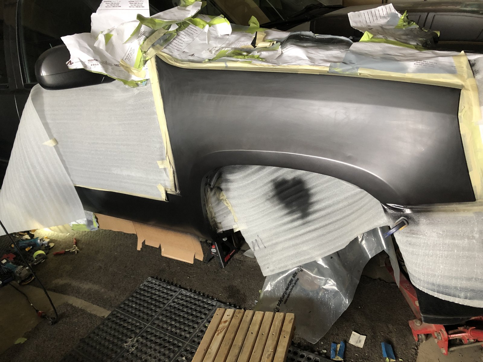

So after an hour weight at the paint store I’ve got the 3rd attempt at a closer match. The last one looked real good with the led light on it but not so much in natural light,had some blue in it. So did a test piece this time with black primer and looks good but that’s what I said the last two times. Fingers crossed. Front fender taped off and primer applied. Hopefully have time today to get paint on this part.

Well match looks better. Hard to tell only have a few windows in the garage

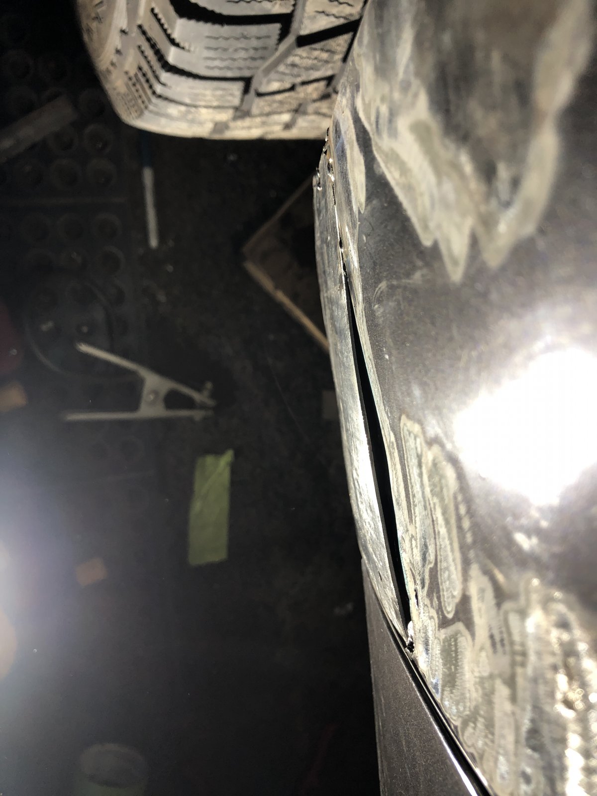

working on the other piece by the rear. Cut grind weld repeat. Kinda got it close.

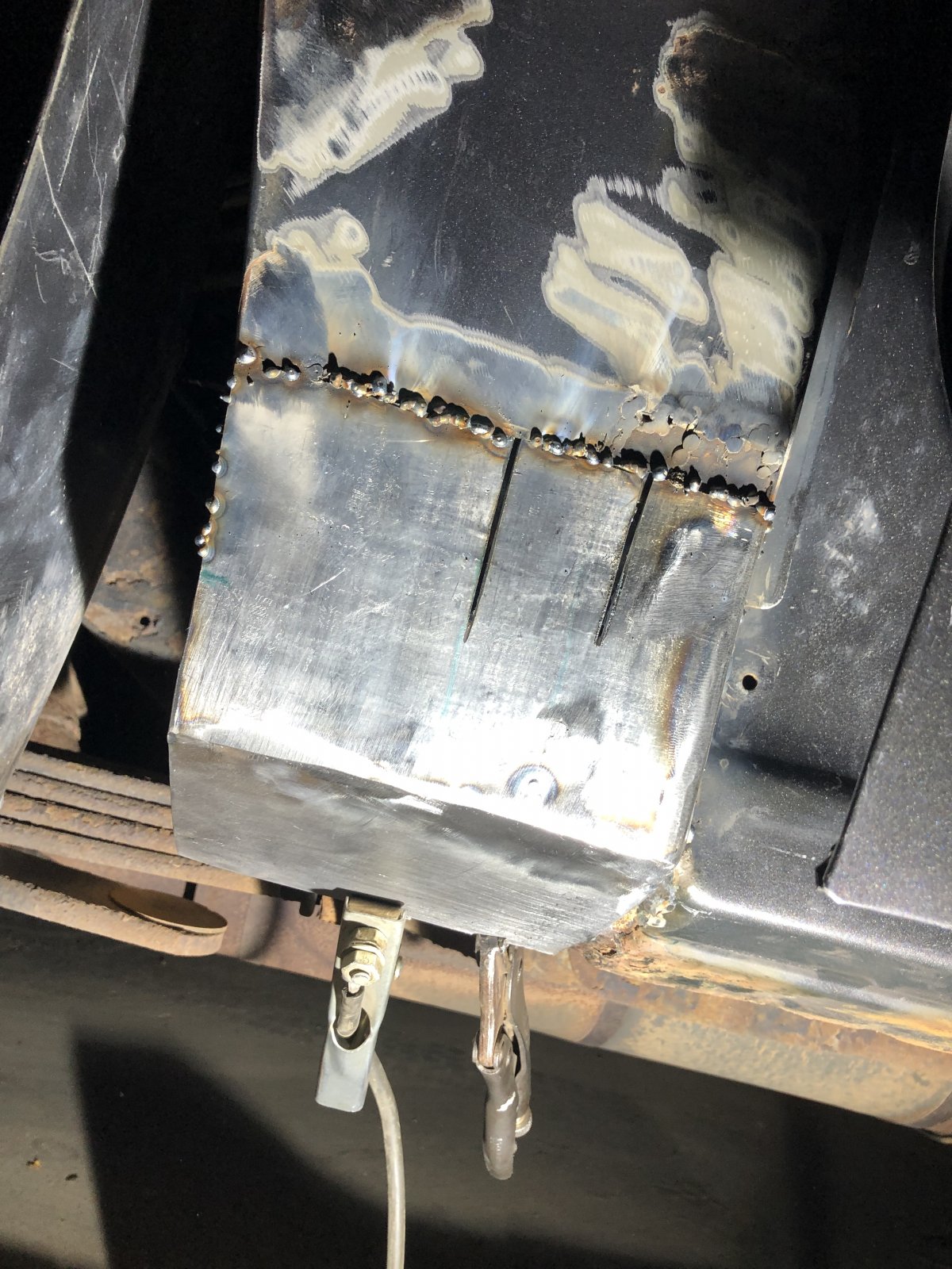

Got it tacked in place. You can see the void or reverse shape I need to try and get. Only thing I can think of is cutting it along the line push it in and re weld. Or something like that haha.

Think Ill look at for a while,look at the other side to see how close it is.Have to scab in a piece for the inside door frame.
I think I have to weld it all in place to keep it firm then try to get the curve S shape going? I dont know,Almost time for a beer.

Got the piece tacked in. Cutting the slots gave me what I needed. Had a spot top right still had rust welder just blew through it. Cut it out and patched from behind. Much easier.

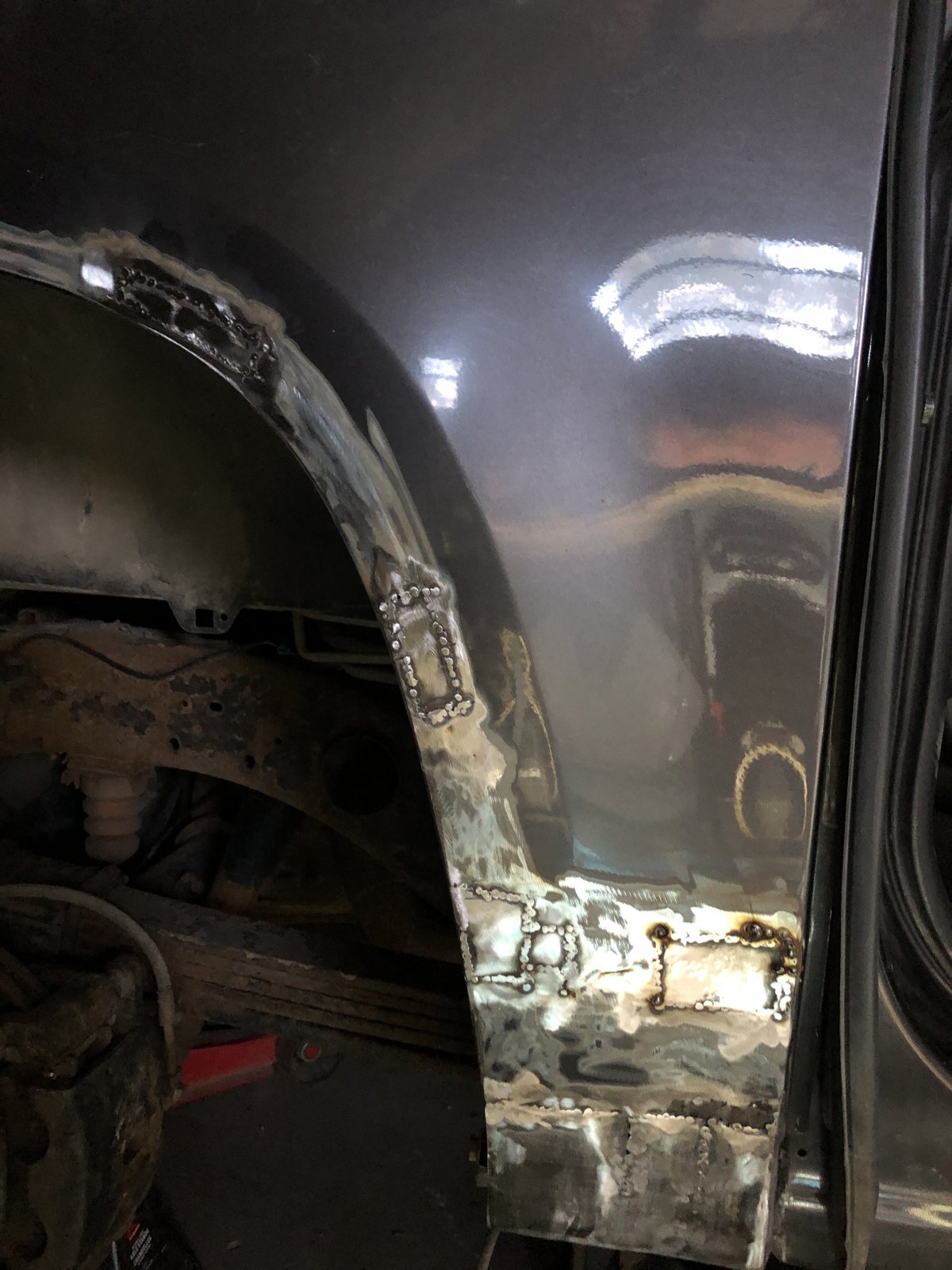

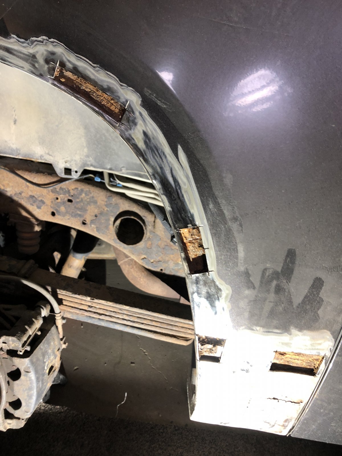

Grinding away on th back fender. Found a few more spots where it was soft. I could probably cut the whole fender lip away but don’t want to do another one. No doubt rust will re appear again By next year regardless of what I replace.
At least this will only take a few hours.

Got them mostly tacked in. Sitting on the ground gets a bit tiresome so done for today. Hopefully get some bondo on tomorrow.
