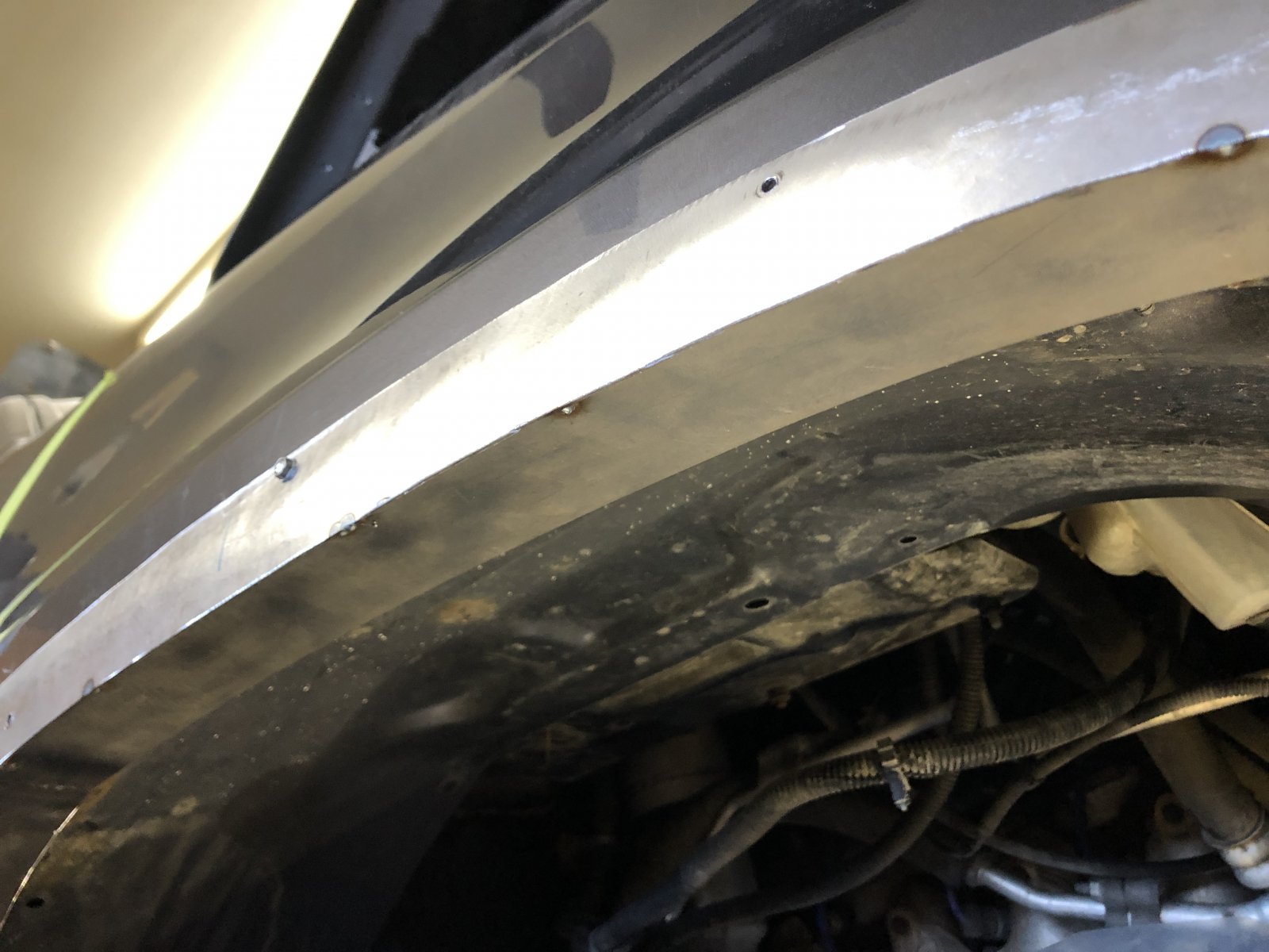

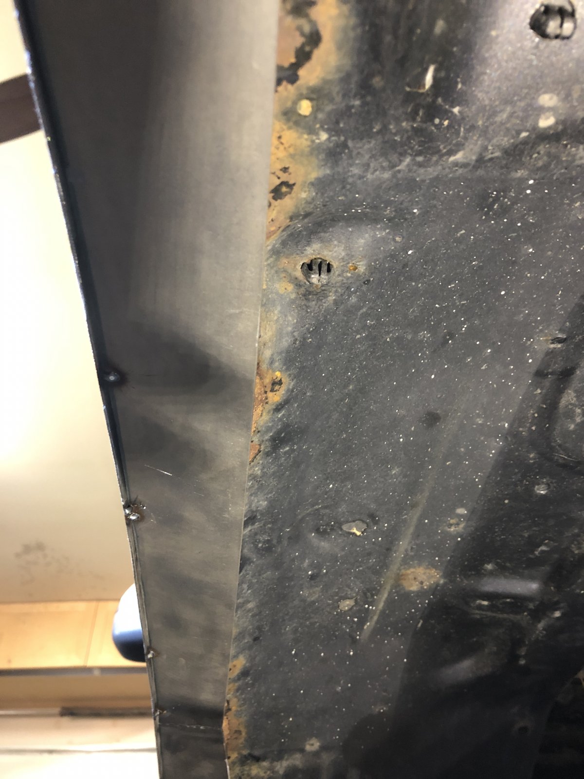

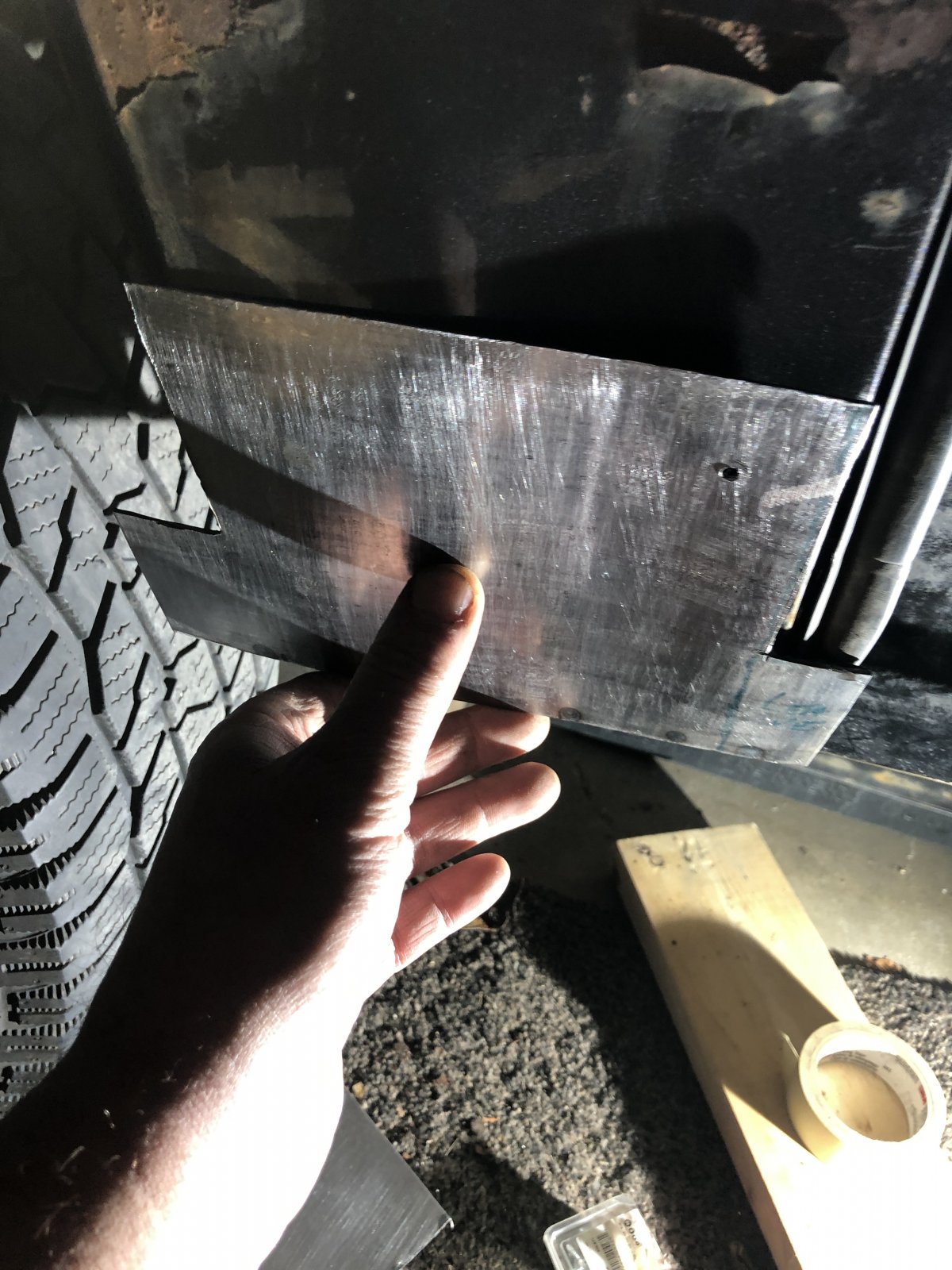

Working on passenger fender. Pretty rusty underneath and about 3/4” up. Started with the vertical piece.
Got that sitting Flat. Made a template from the other side for the horizontal piece that goes underneath
welding it up on the bench and I ran out of gas for the welder. Crap To the store tomorrow I go.

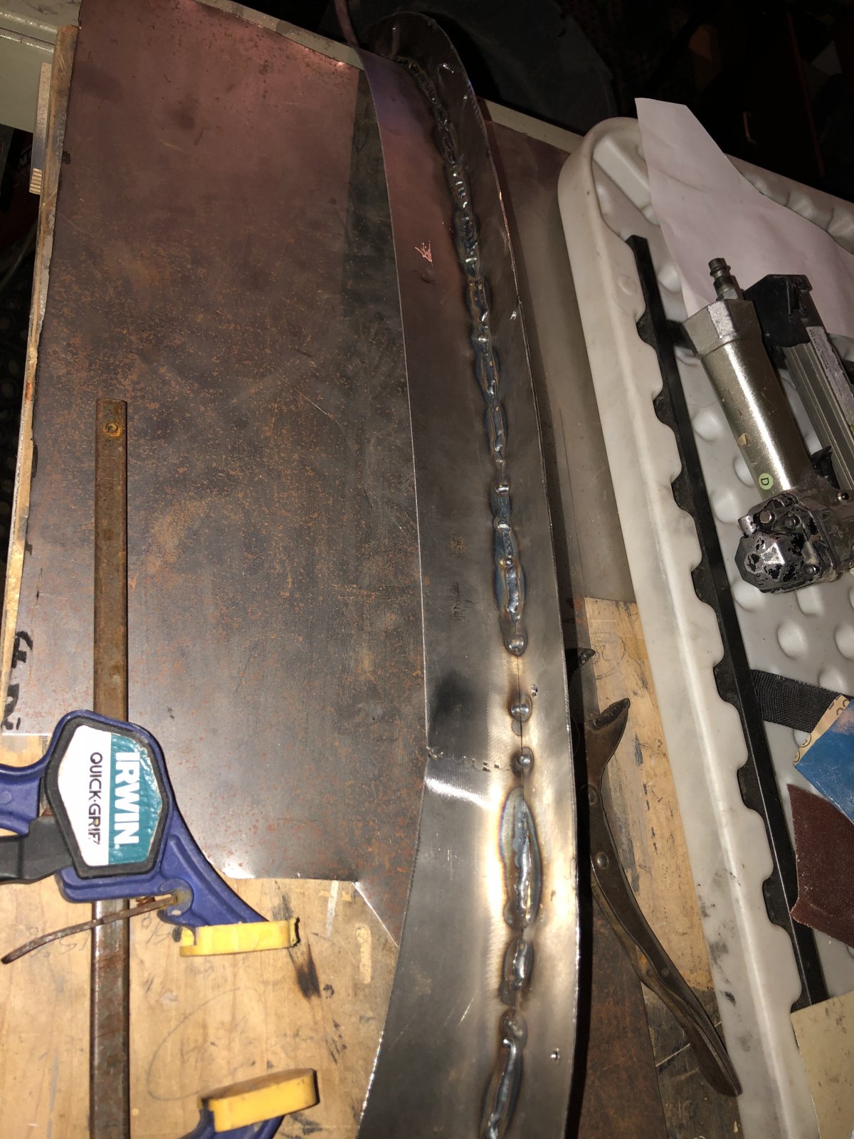

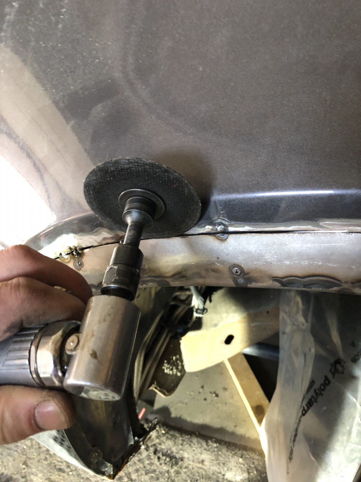

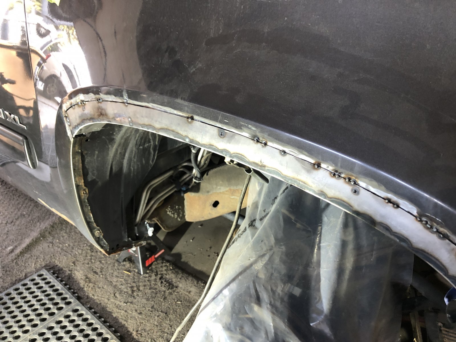

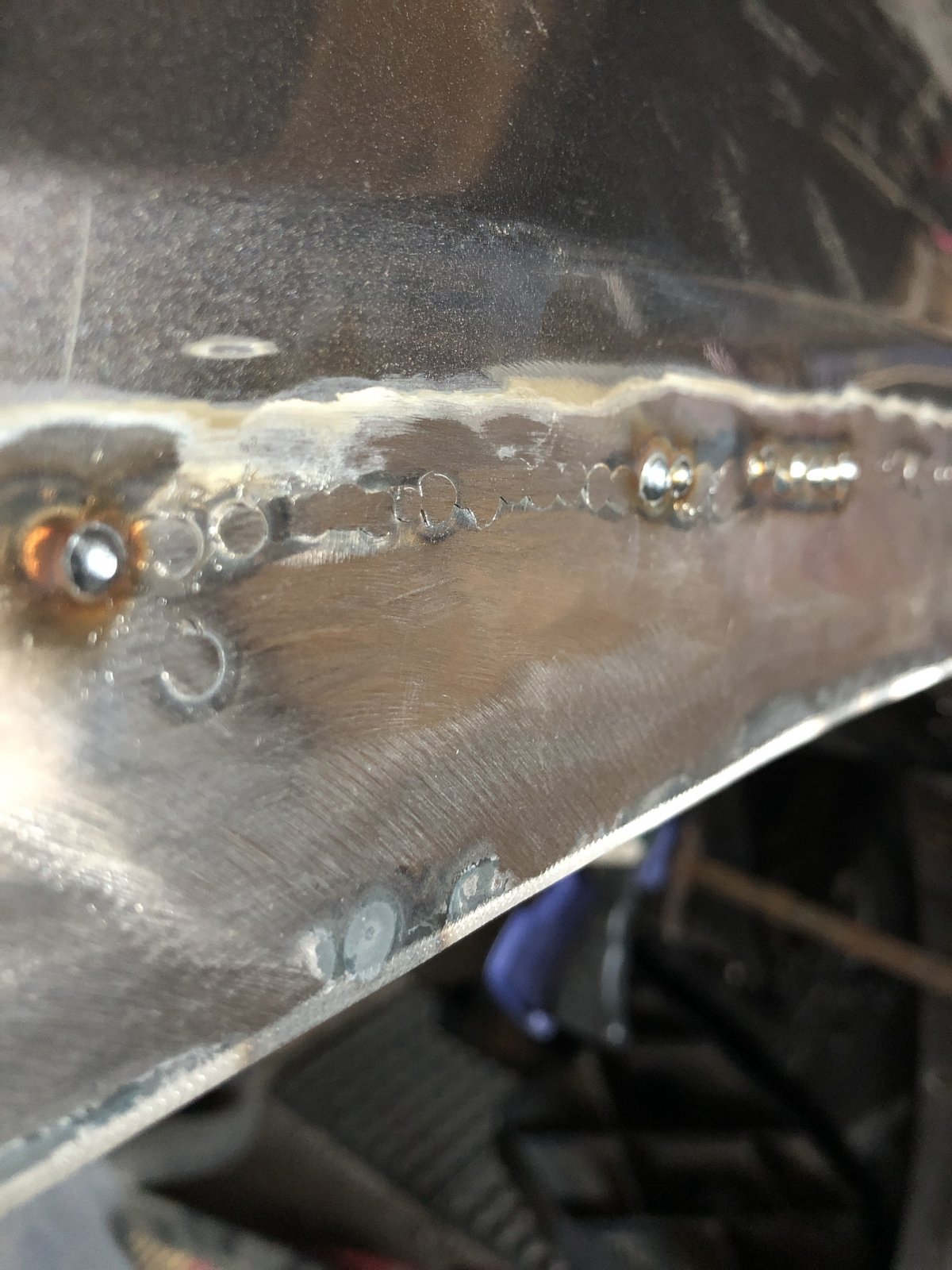

Well about a thousand tack welds later. I’m low right where the welds are so worked good don’t have to grind welds any more. Haven’t done a light test yet. I’m sure I missed a few spots.
Did the cut and butt where you over lap then cut at an angle. This way when the panels close the gap gets smaller. Got it off a video. Worked well. My pic of the cut off wheel is exaggerated,about a 30*worked good.

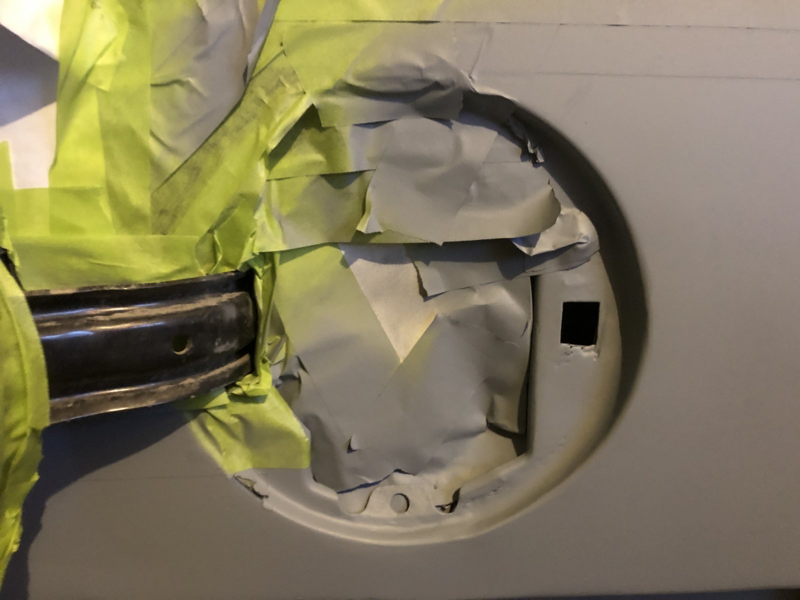

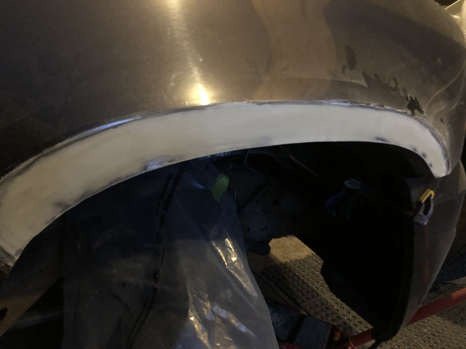

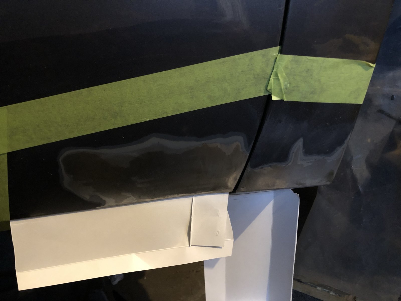

Working on this while bondo cures.
The bondo project. Have a high spot in the metal on the lower left. Tried beating in but didn’t move its right on bead right Where the backside is welded. I think I have to grind it down.

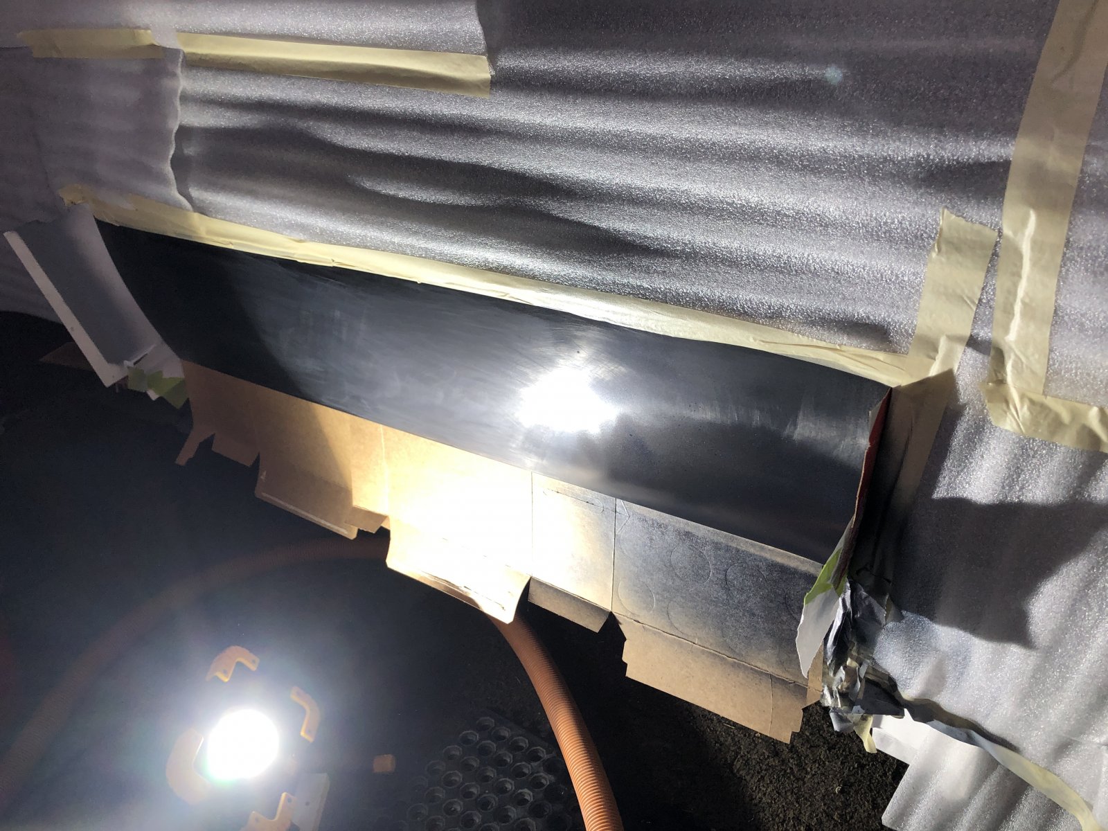

The colour of the primer made the first 2 coats look blue. I sprayed 4 light coats to hide the primer. These cans are 90% solvent so takes a few coats. I sprayed pretty thin also. Colour matches much better then my first can once the primer disappeared.
I’ll wet sand and spray again tomorrow.

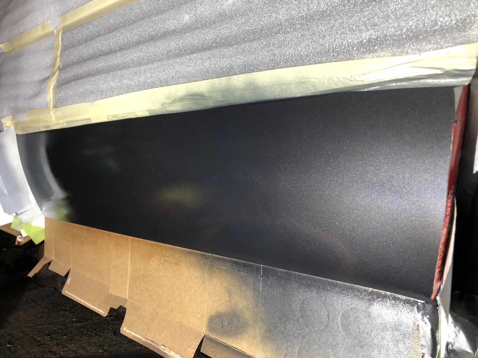

Sanded over last nights test. Could still see my primer line so did a bit more 400 wet to disturb the line.
3 more coats of base kinda blended in and I’m on 3 coats clear. Learned my lesson on the last go. Not trying to blend clear I’ve sprayed the whole bottom this time.
3 more coats of base kinda blended in and I’m on 3 coats clear. Learned my lesson on the last go. Not trying to blend clear I’ve sprayed the whole bottom this time. View attachment 383503View attachment 383504
Well colour match sucks. Back to the shop I go again.

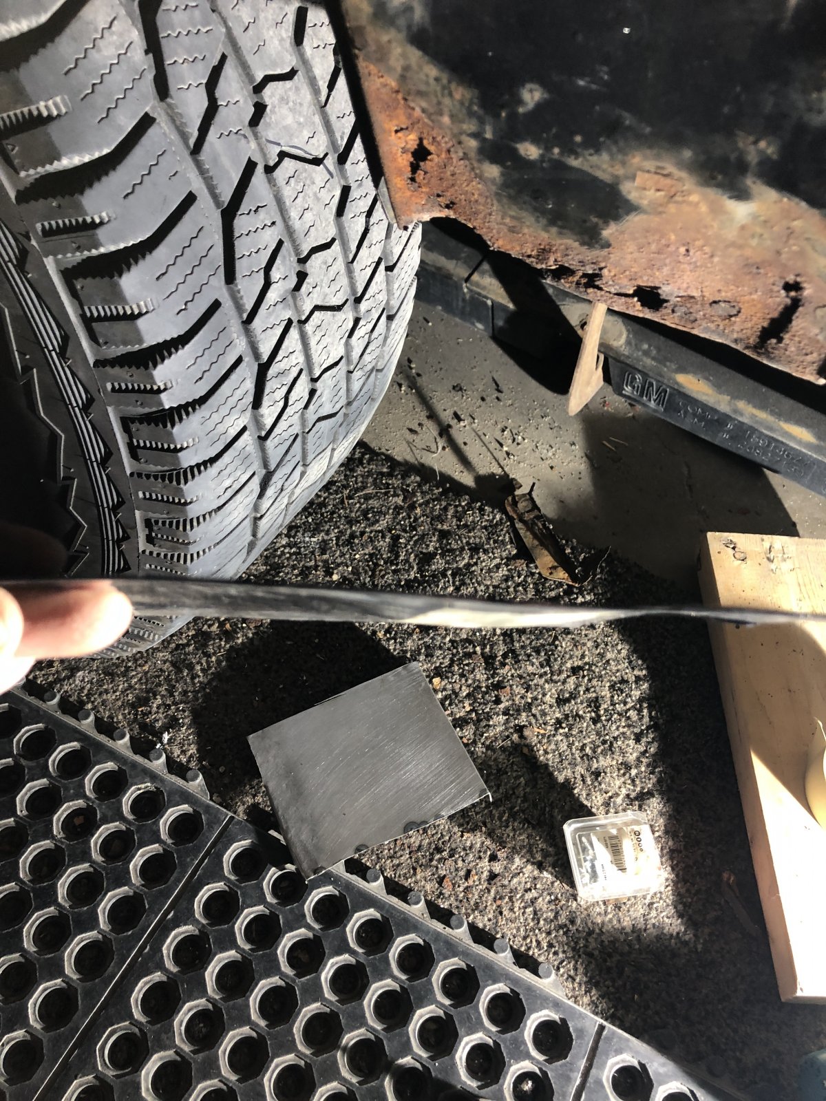

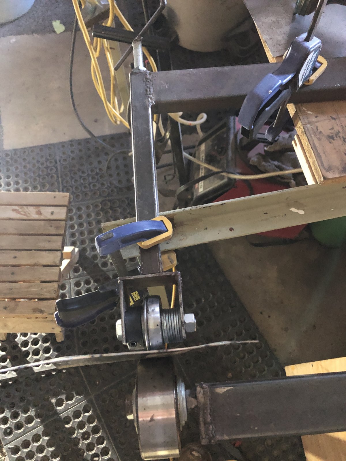

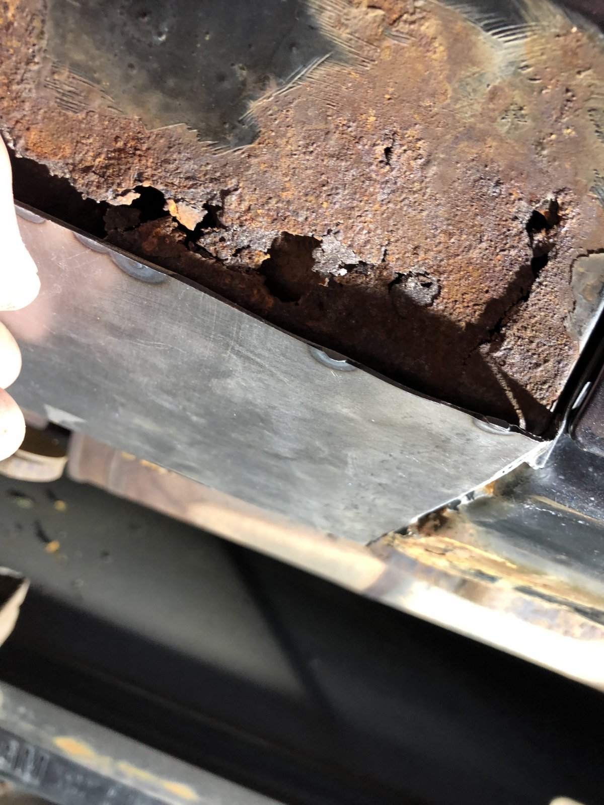

Working on lower wheel well in front of rear tire. Gave it a hit with a hammer and it all came crumbling down. Must be some structure behind as what’s left is pretty thick metal.
The bottom piece seams easy enough a couple of lips and done. The side piece however has two curves one in and one out but only a little. A friend borrowed me his home made English wheel. Seams to work just gotta keep at it.
The bottom piece seams easy enough a couple of lips and done. The side piece however has two curves one in and one out but only a little. A friend borrowed me his home made English wheel. Seams to work just gotta keep at it.View attachment 383585View attachment 383586View attachment 383587View attachment 383588
