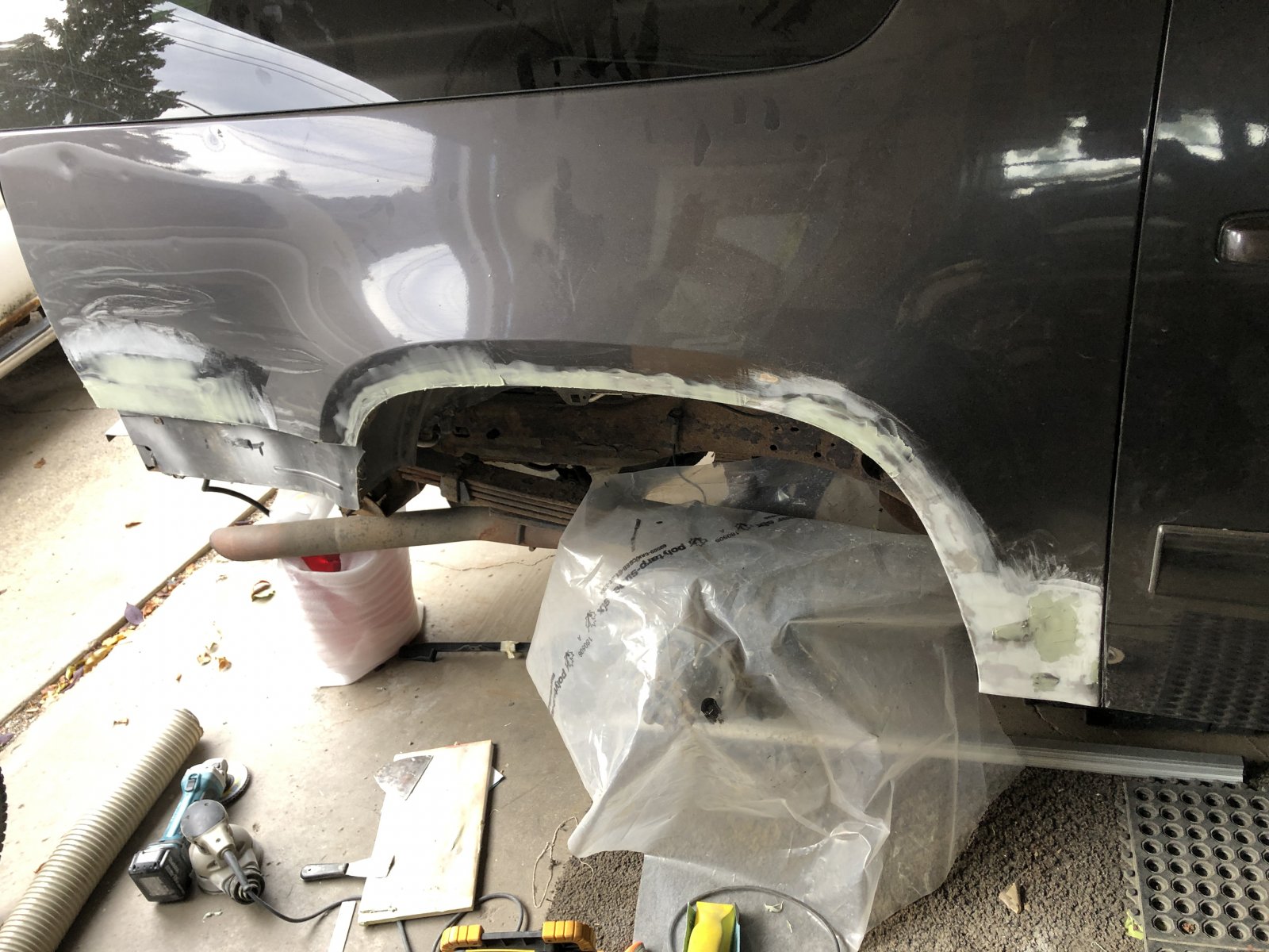

Working this am on wet sanding with 600. Spent a bunch of time blocking with 400 so this step is going much easier. I dust some black primer on and it’s easy to see where you’ve sanded and areas that need more.

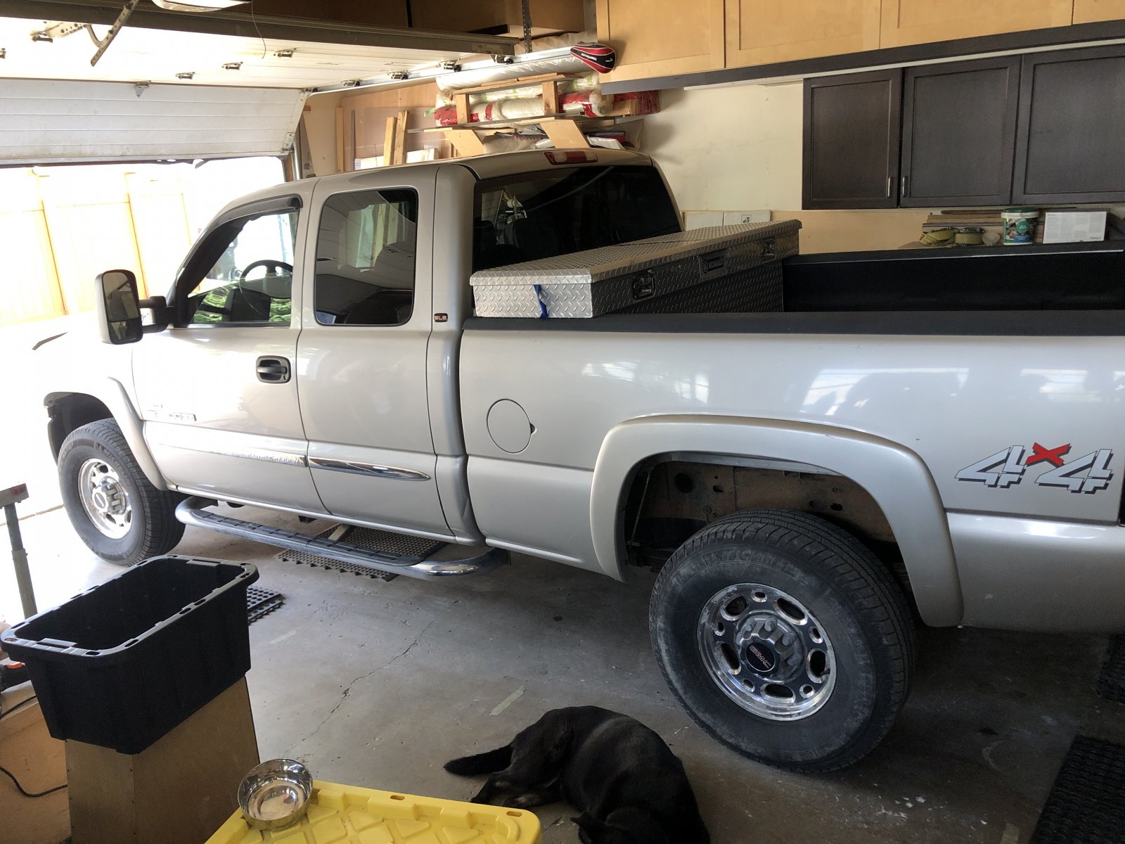

Took down the booth removed about 4 rolls of tape lol. And took it for a rip. Haven’t drivin it since February. Was hell fun. You can smoke the tires easy with this duramax. Acceleration from 40-90 is awesome. Any who. So glad this is almost done.

Geez been a while. Life gets in the way. Have one side complete. Rockers cab corner and wheel arch. Have the other side all sanded and ready for paint. Hopefully this weekend.
On my first attempt to spray base coat I had everything ready. Laid down on my back to spray the rocker and bam Huge run. Man was I pissed. Had to call it a day and sand it off the next day.

Sanded and buffed. Picked up a rotary polisher with a wool pad as my DA one with foam wasn’t cutting it. lol. The rotary does a much better job.
A lot of work sanding 1000,1200,1500 and 2000. I removed about 75% of the orange peel with 1000. 1200 got almost all of the rest. 1500 and 2000 goes much easier as it’s pretty flat by then.

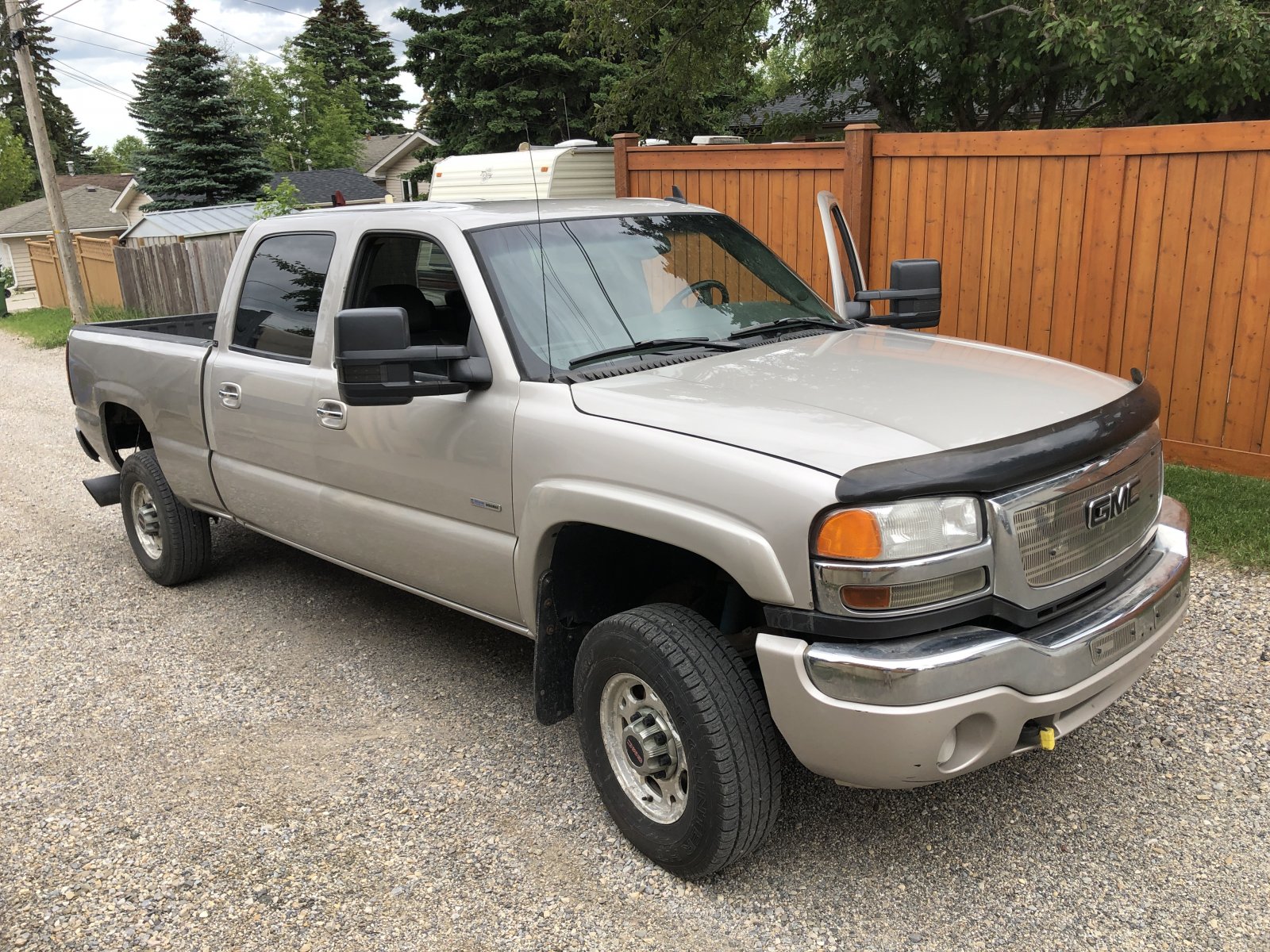

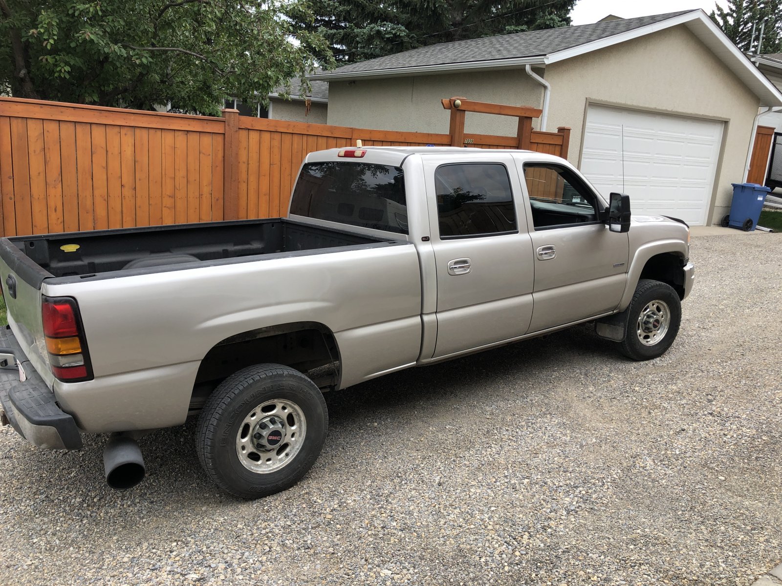

Took it for a 2000 km trip 1200mile. Was awesome. Put the truck up for sale while I was gone. Sold as soon as I came back. Truck had alignment issues with doors fenders etc. I think it may have bounced of a deer or two. Any who found another LBZ ext cab this time with next to no rust. Yay. No welding. Lol. All stock about 170k miles. On it. Runs good. Maybe paint the wheels for the hell of it.
