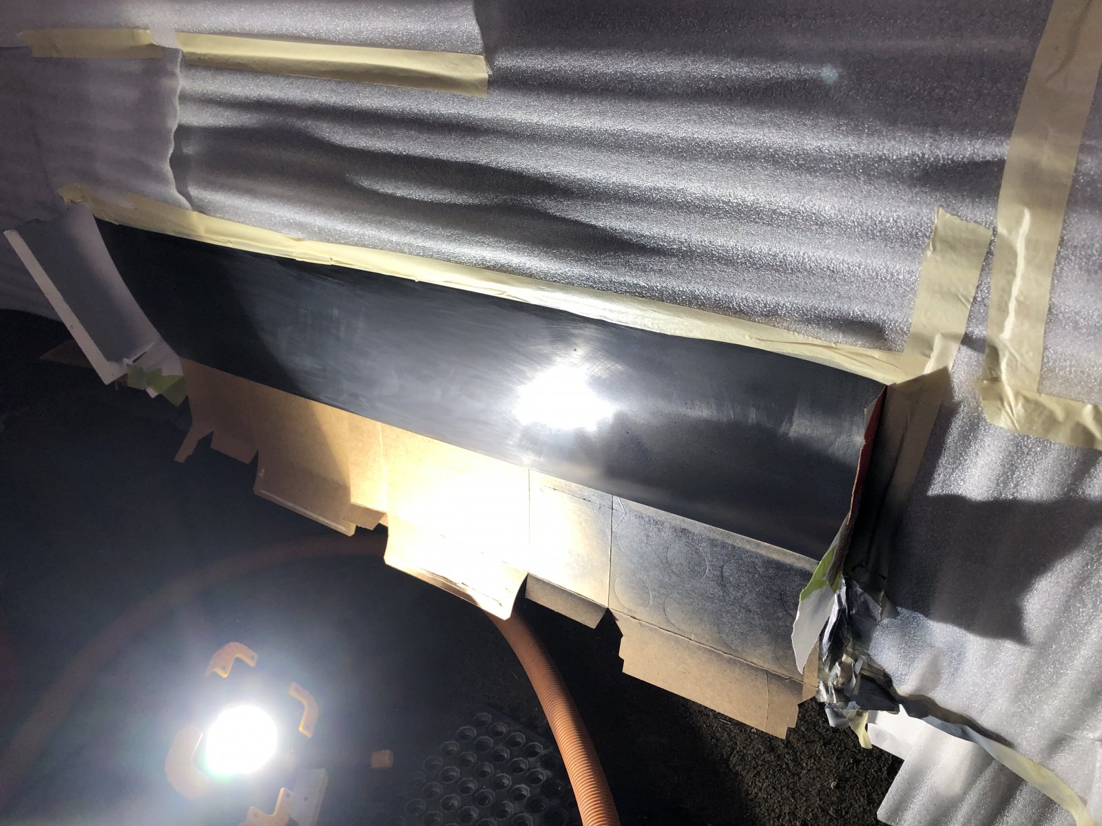

So stopped today at another paint match place. Got another flavour. Had to sand with 400 again. Gave it a light couple coats and I’m happy. Not sure how far up To go for the blend but Best match so far. Since it’s all ready masked and I have 1k clear I’m going for it. yeah I know ,didnt bother with the dent.I plan on making more lol.

Thanks. Got 3 coats on. Was still a little blotchy after 2. Just waiting now for coat 4.

Did another layer of bondo put tape on the high spots this time. Have a cardboard template from the other side to give me some idea.

Friggen' cold is coming.Im gonna have to wrap this up this weekend.My daily driver needs the warm space.I may just get the rest in primer so it can sit outside.
