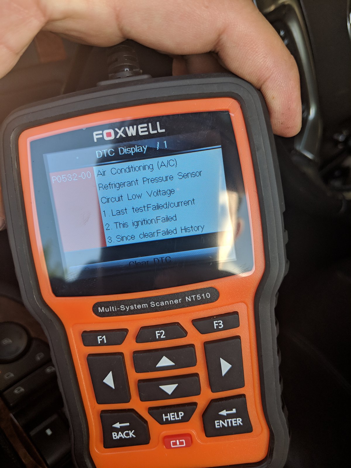

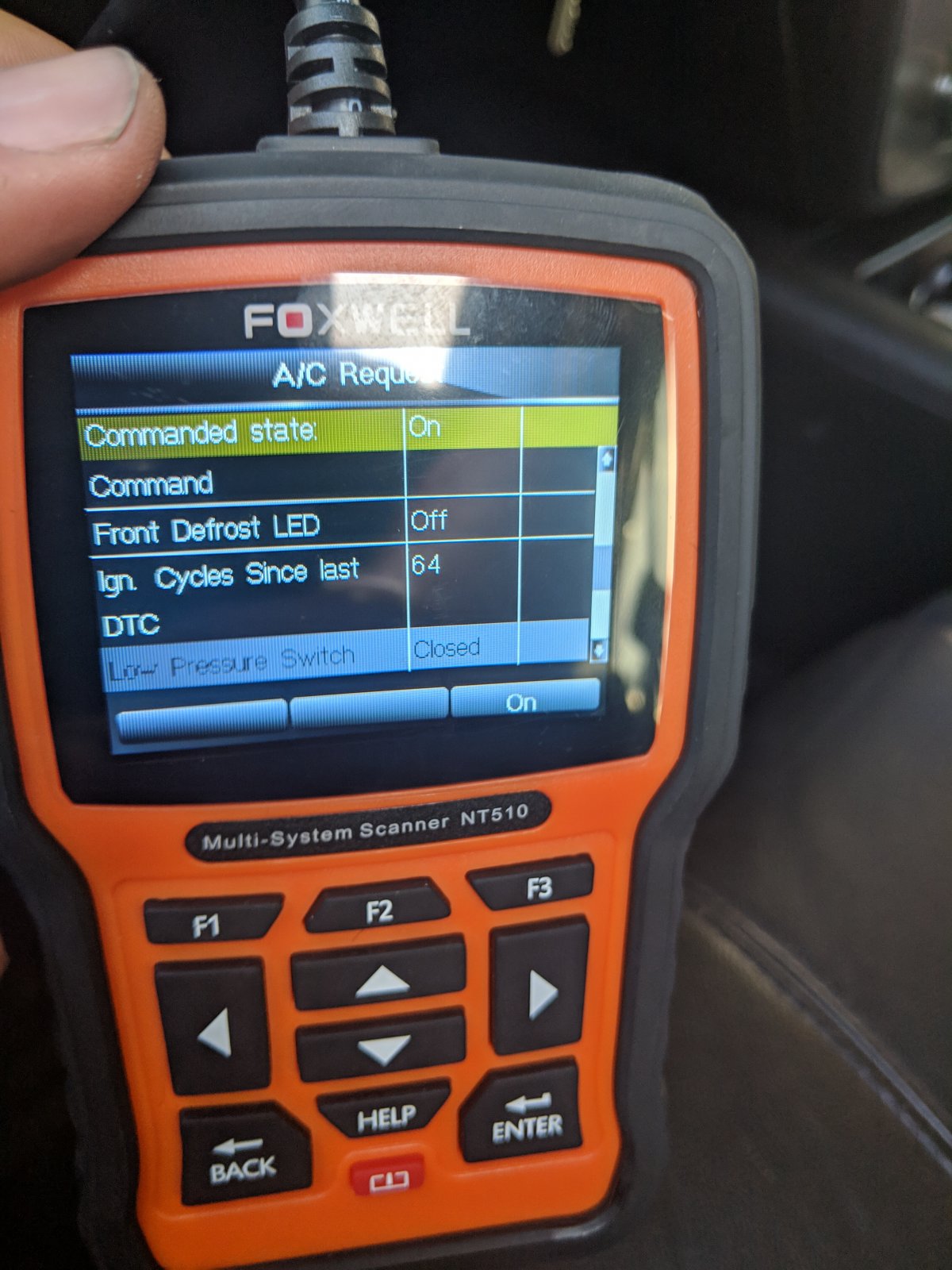

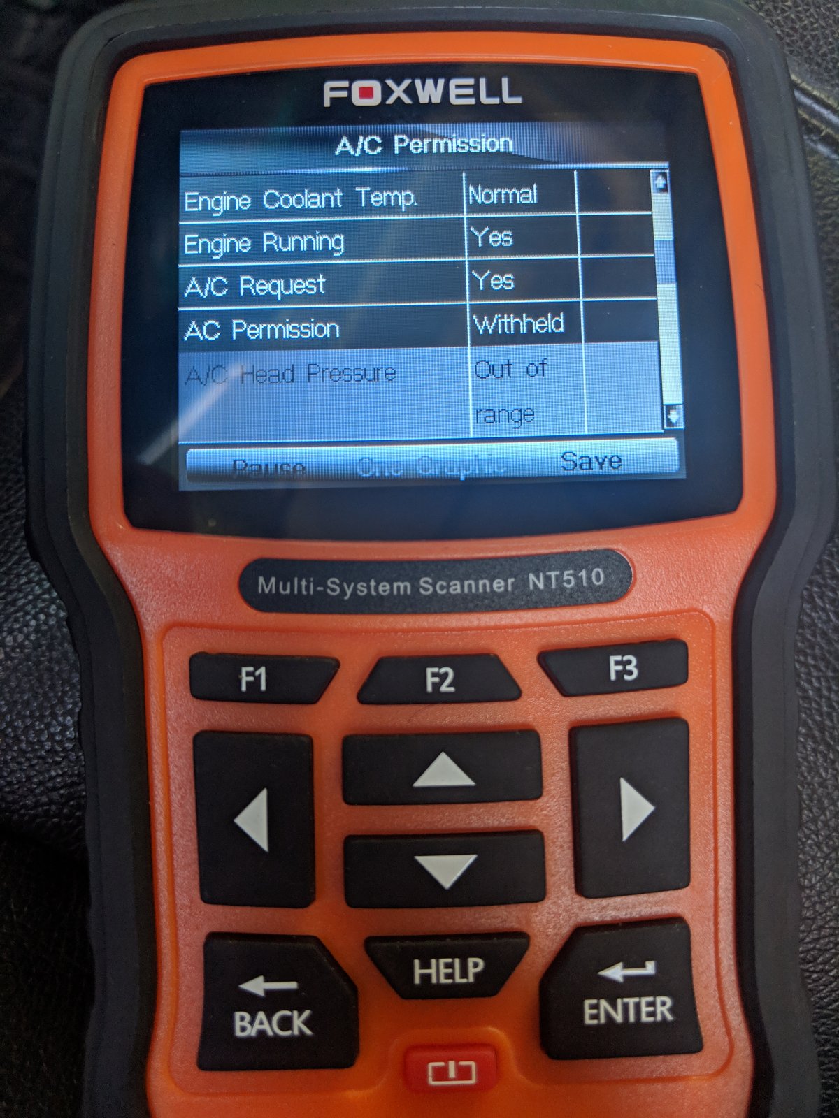

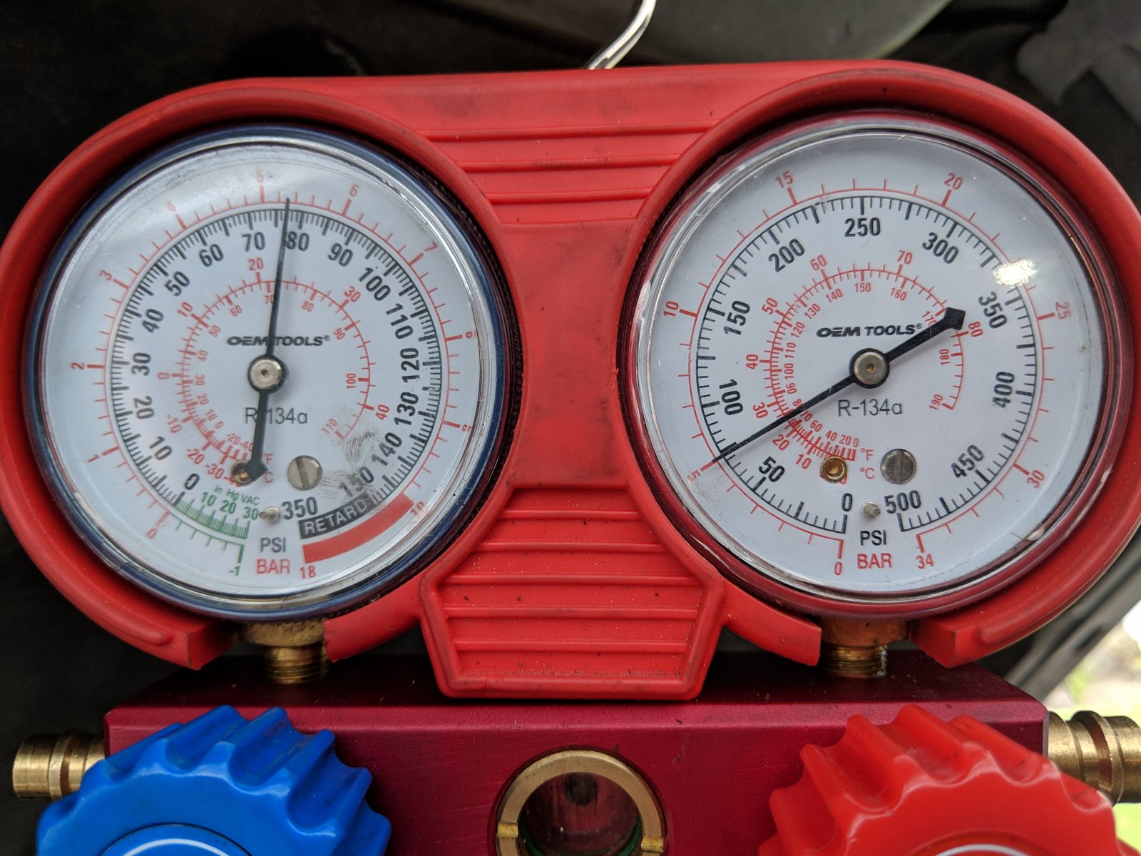

Hey guys,
So I bought the Yukon with the A/C system not working (hence how I got a great deal) and figured it would be an easy fix as it had no Freon in the system.
I had A/C system charged at a shop and the tech advised me that I probably need to have the BCM re-flashed. Never heard of it having to be reflashed but could still be a part of the problem.
I have a foxwell Tech 2 scanner and came up with the following DTC's that are causing the A/C system to not activate.
P0532-00 Refrigerant Pressure Sensor Circuit Low Voltage
AC Permission- Withheld
AC Head Pressure Out of range.
I have so far replaced the Low Pressure & High Pressure switch and even tried the old jumper wire trick on the Low Pressure switch to see if I could jump the compressor with no luck.
I am lost where to go from here, I verified the pressure compared to my Brothers Silverado with his AC off like mine and adjusted to his pressure settings.
Any help would be greatly appreciated as it is starting to warm up in California.

Check the sensor for 5V and ground at the appropriate pins and if it’s there, check for the signal out. I’m guessing it probably goes to the BCM, but I might be wrong
Moose912
Mar 16, 2014
121
33
Indy
Never heard of bcm issue either. What brand sensors did you use? If the snowflake flashes it recognizes an issue and prevents the system from coming on. If you can’t jump compressor on it could be as simple as a dead compressor. Not super likely on these trucks however. I’ve seen more climate control units go out than compressors on these.

View attachment 222138 View attachment 222139 View attachment 222140 View attachment 222141
Thanks for the pic's in regard to using the tech2. I recently got the vertronix knock off and need to build knowledge with how to use it. I think i would advise an alldata subscription, your tech2 is defining the problem and you now need to follow a troubleshooting tree that would be outlined in a factory service manual and you will have it fixed in no time! The TS tree will designate which component to check, how to check it and likely replacement part. your allmost there.

Sorry, work has been outrageously busy lately. I was able to get the A/C going by jumping the A/C compressor relay. I am going to continue to look into why there is no signal to engage the compressor, but at least it works for now in this 100+ degree Central California weather.

Thank you for the reply, I just replaced both High and Low pressure sensors. I will test the ohms and voltage as stated and see if there is a wiring issue somewhere in the system :)

Looks like I have an electrical issue, system won't read High Pressure Switch data. I am going to replace the wiring connector as it appeared to be corroded and will work my back to the BCM and HVAC controller.
