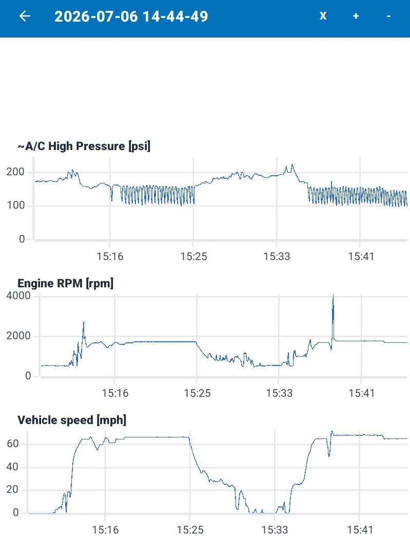

I have a OBD to USB adapter.
I have several OBDII to Bluetooth adapters that I usually use mostly.
For fun I built an Arduino SAE J1850VPW to USB project for adding in custom sensors.
Here's a look at some data I grabbed today ... This is from the Car Scanner ELM OBD app...
