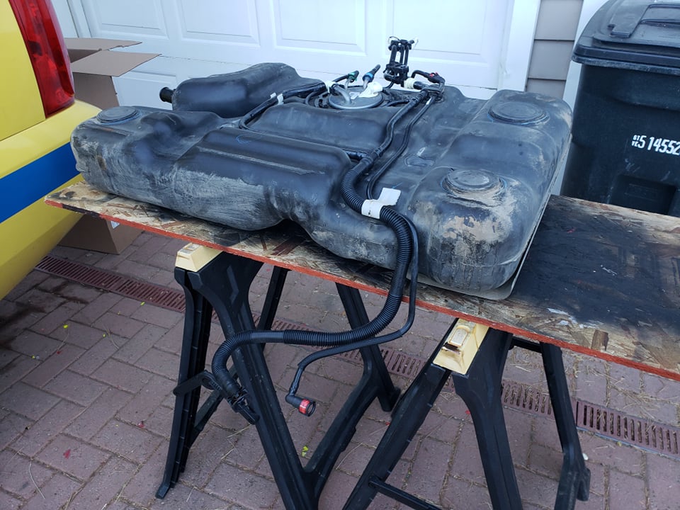

Now I am at a crossroad here looking at dropping the main tank and replacing all the fuel/evap lines (15872640 - 5th photo) or gamble it is a ECU. The main issue for the rush is I live in California and need to be smogged before Dec 22 or I pay hefty fines, I prepaid for registration. Any input or information would be helpful. If anyone knows a good place that sells programmed ECU let me know.

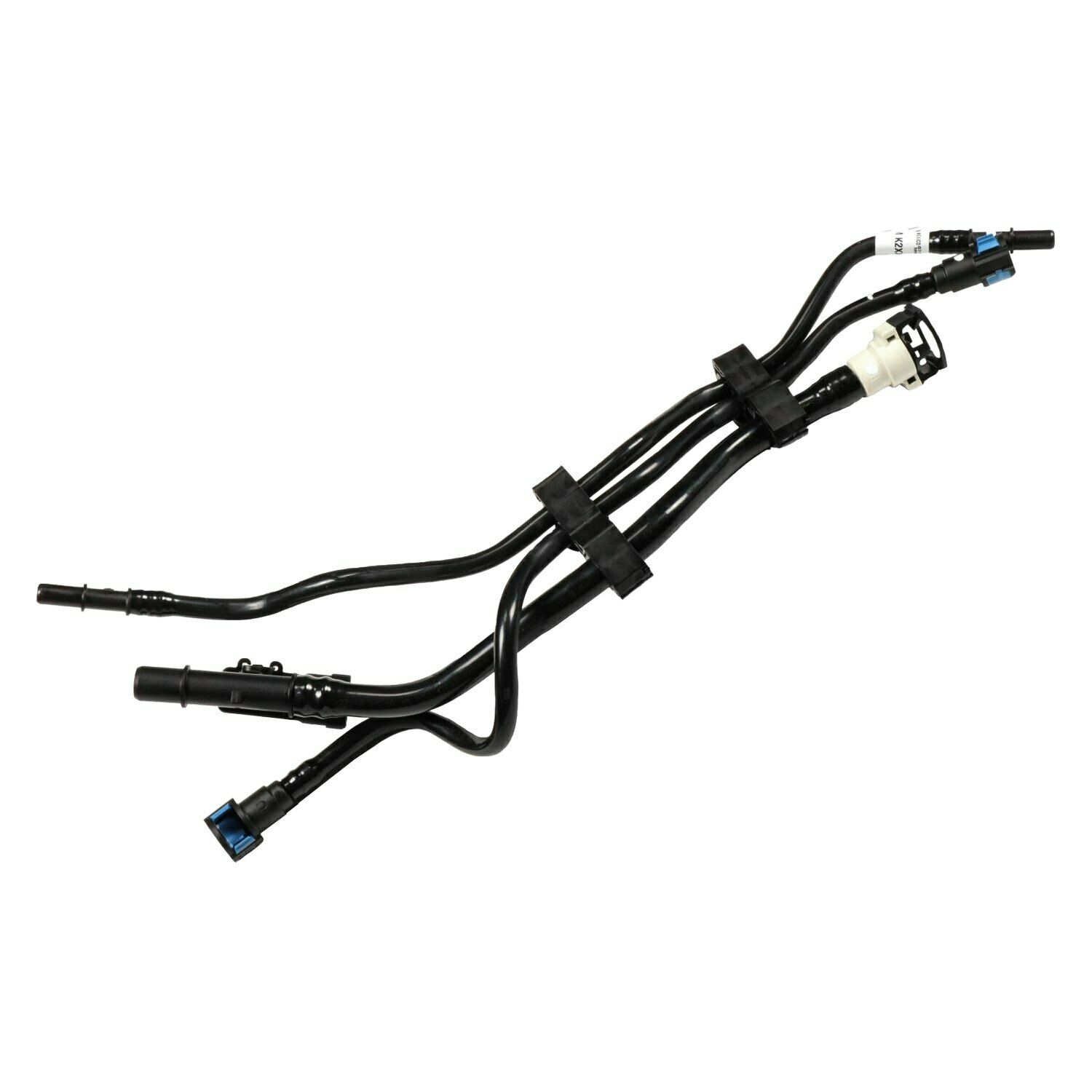

Vent Hose - 10355971
Vapor Canister Vent Hose (with pressure sensor) - 20931761
Vapor Canister Vent Hose (lines goes over the rear tank) - 15872644

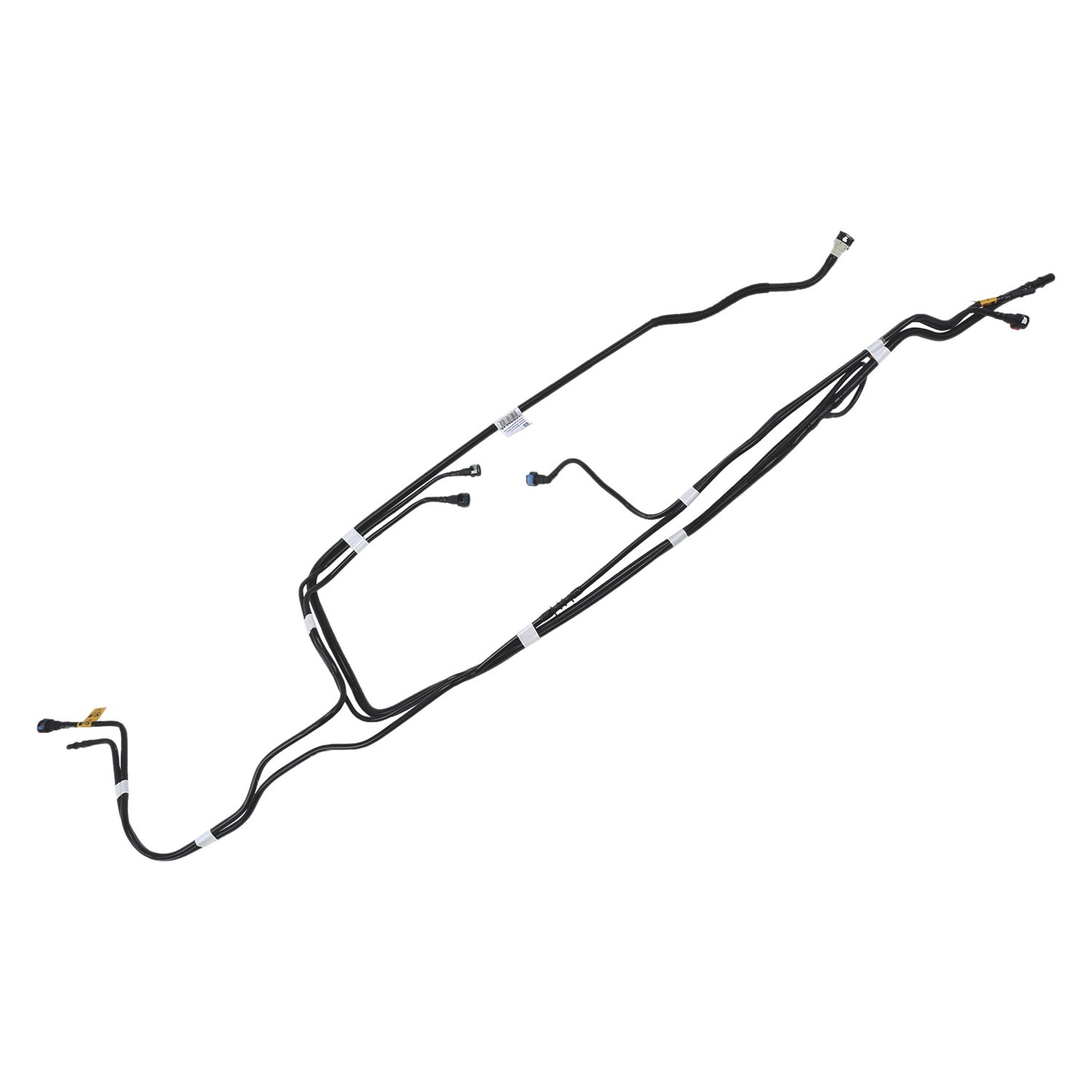

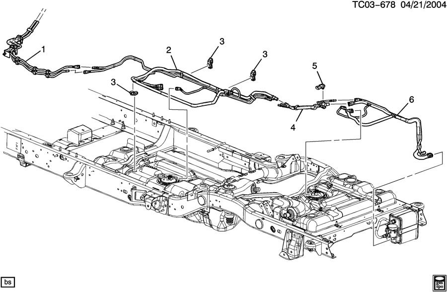

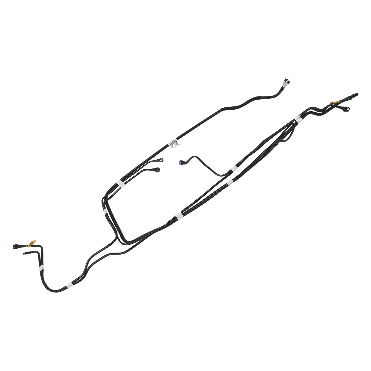

Mine is not on top of the tank (found out the hard way) it between the 2 tanks and they where replaced. Drilled a hole above the main tank and used a bore scope and looked for smoke and did not see any. tested the back tank on the bench and in the Yukon and found no leaks ran the machine until it ran out of smoke removed the gas cap to check pressure and if there is smoke in the system. After many many many hours I got the cheap eBay scan tool VXDIAG to work on my laptop (tech2win) and could not get the Evap system test to work would fail me each time then the Suv was to hot to run it. Only odd thing could not get the scan tool to get into the ECM.
If I drop the main tank I am replacing all the lines from engine to rear tank. see last photo.

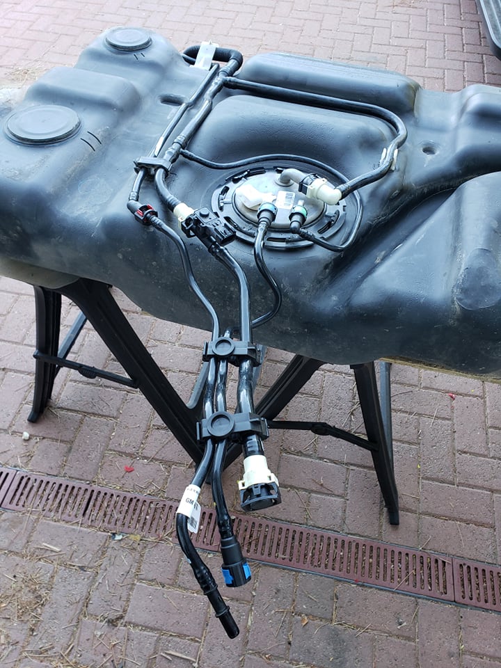

Top of the tank is clean and see no leaks/rust/smoke and do not smell fuel. want a confirm before I have to drop a full tank in my slope driveway or in my dirt lot lol.
Learn something new every day! OK, well, I would replace the vent and purge solenoids if yours were mine. How long did you say that it takes for the code to return once cleared?

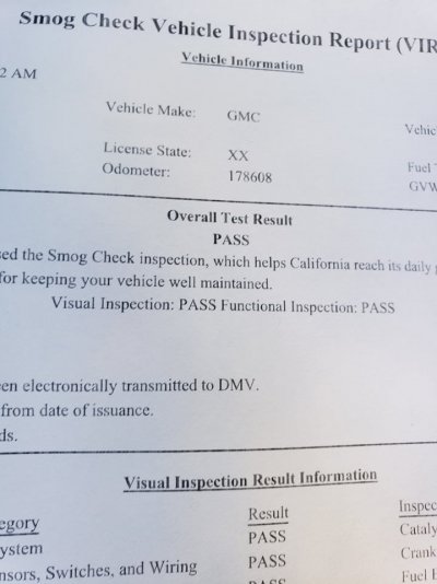

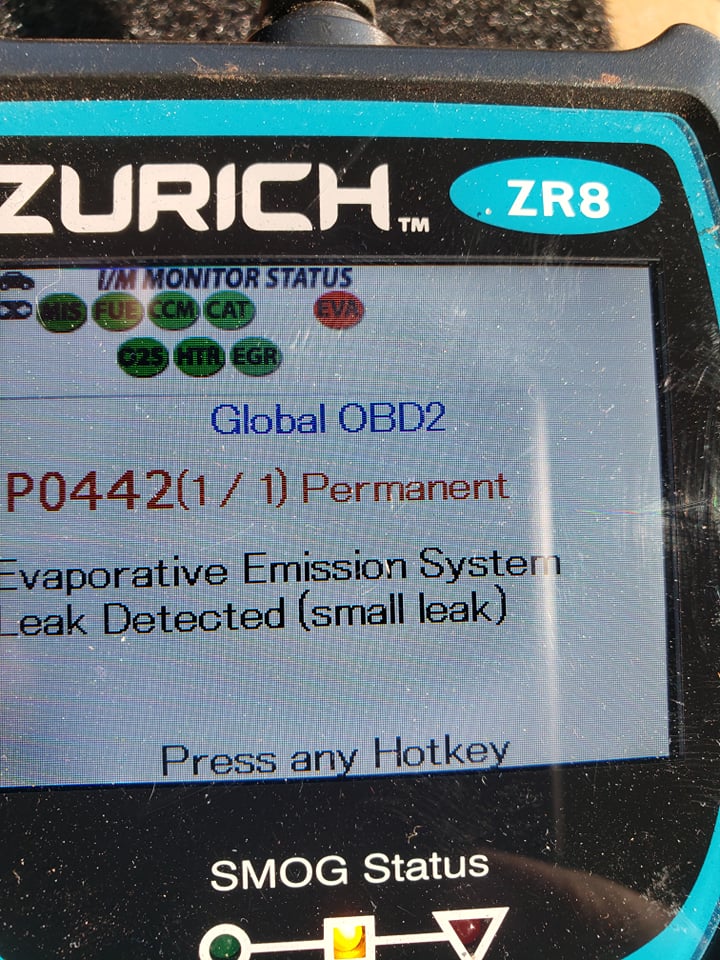

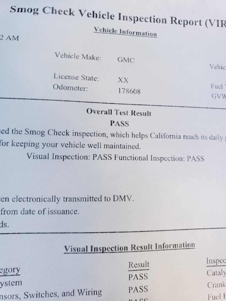

Got good news and bad news
Good news - It passes smog, when I spoke with a tech friend who has been smoging cars for XX amount of years. Said I can have 1 pending code and 1 incompliant monitor. But he said had this been a 2010 I could not have passed smog with a pending/Set permanent code.
Bad news - the code is still there after 2 more driving cycles but now I have 2 years to fix the issue.
