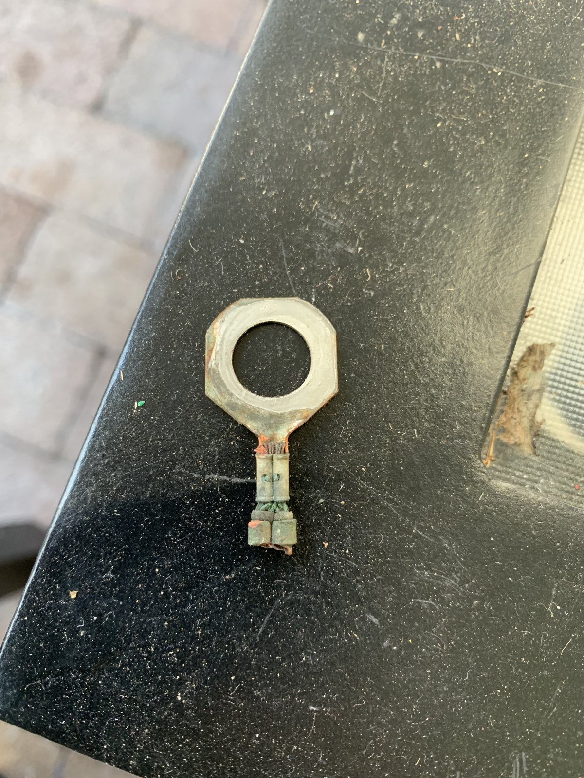

Two wires on the block in the front were definitely broken off and handle the grounds for the coils on both banks. The harness I have in the truck is for an 08-09 Tahoe/Yukon 4.8-5.3 flex or gas don’t matter.
Once I replaced the new ring terminal engine ran just fine.
FYI it’s not the ecm.
Broken ring terminal for both banks of coils.
