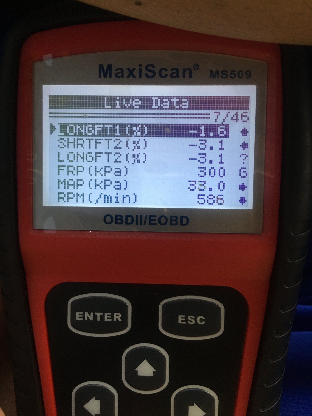

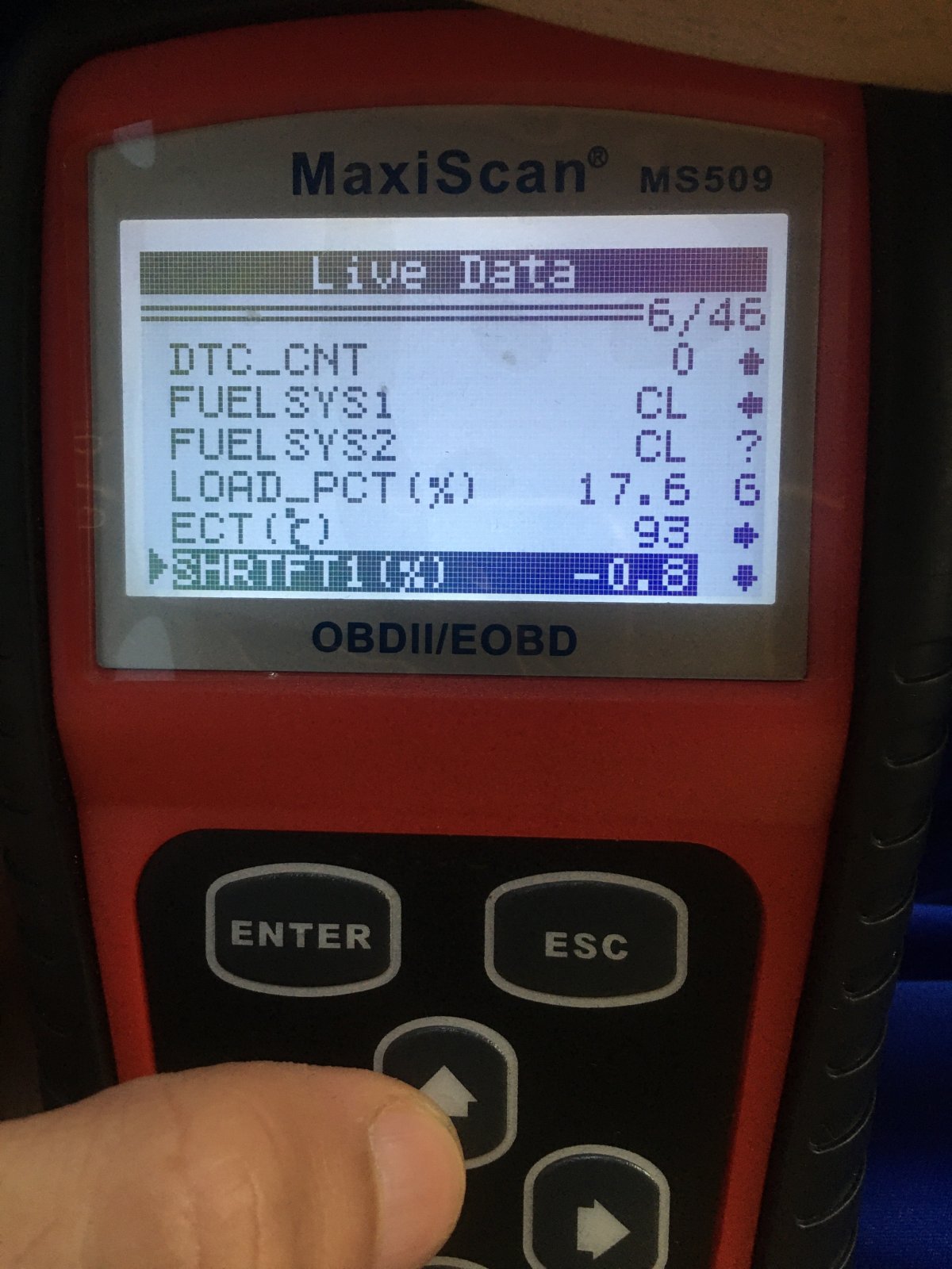

RPM fluctuation at idle, though it was a vacuum leak somewhere but the fueltrim values on my OBD scanner looked normal to me! Can the brake booster have anything to do with this? I think mine is going out, plus codes: c0253, c1100 have been found in the EBCM.
What can I check next?

I agree that the fuel trims look okay; adding each bank's ST & LT trims it's within +/- 5%.
Has the throttle body and IAC been cleaned lately?
It has lean codes with those trims? Check upstream O2 sensor activity.
