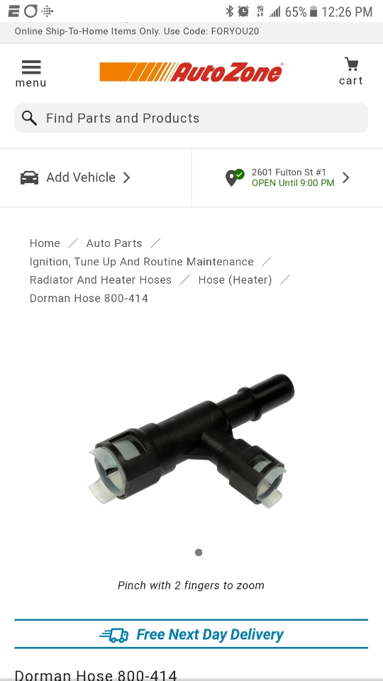

Ok...thanks for the heads up on the fittings to the firewall...once I took the time and actually started to inspect the lines...this was stating me in the face!
I've noticed replacement fittings in black and white. What's the difference?
Also, it's a pain in the ass to remove!!!

I have the auxiliary air so these aren't like mine. The ones on my Tahoe are like this.
Broken side is black, the right side one appears to be white (ish).

The angle is a little different between black and white. Be cautious of replacing them with anything other than AC Delco. Many have reported bad luck with aftermarket (namely dorman) replacements.

Good to know. Sometimes auto zone will have a.c. delco buy not this time.
