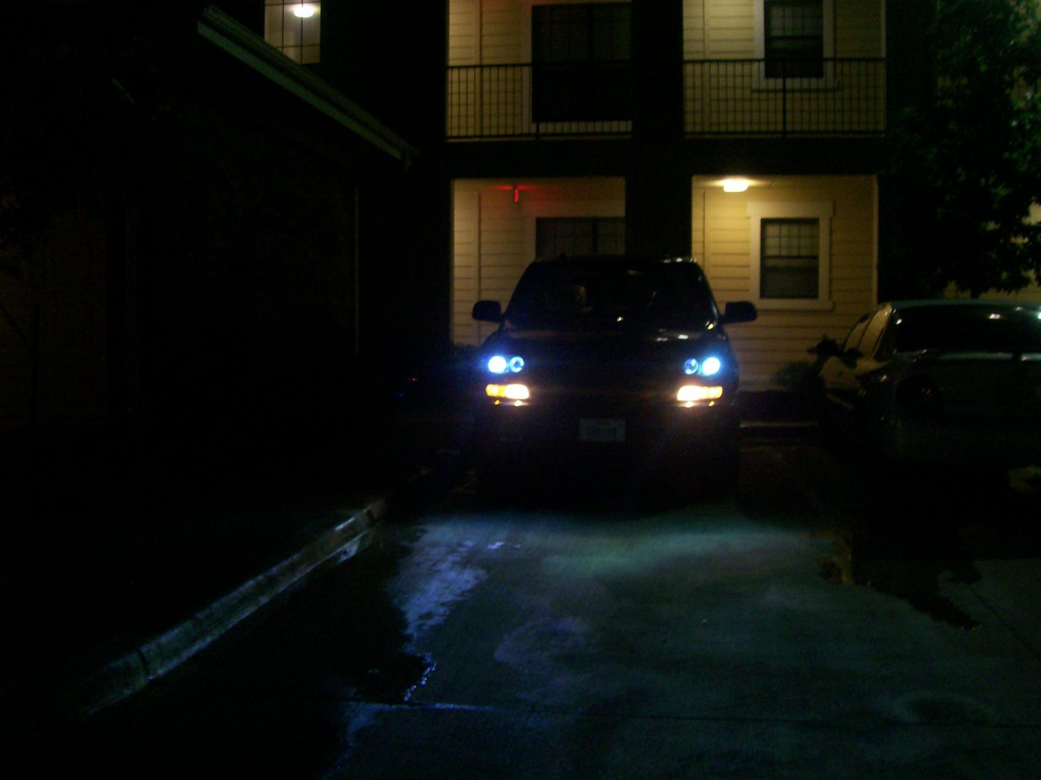

ok, here's a pic i took of the lights last night, talked to rivieraracing a bit, tonight i'll put a stock light back in on one side and take a pic against a wall....but looking at this pic, maybe I just need to adjust the beam up, looks like it's hitting almost in front of the vehicle...sorry didn't have time to embed the pic, but it's attached, gotta get to work!

That's crazy, I hardely ever use my brights anymore, the lows are a ton brighter!! Might need to aim your headlights a bit higher, or are your lenses a little cloudy? Projectors? Are you running a harness for them?
Get some pics tonight like I was saying and post them up, let us all help you out!

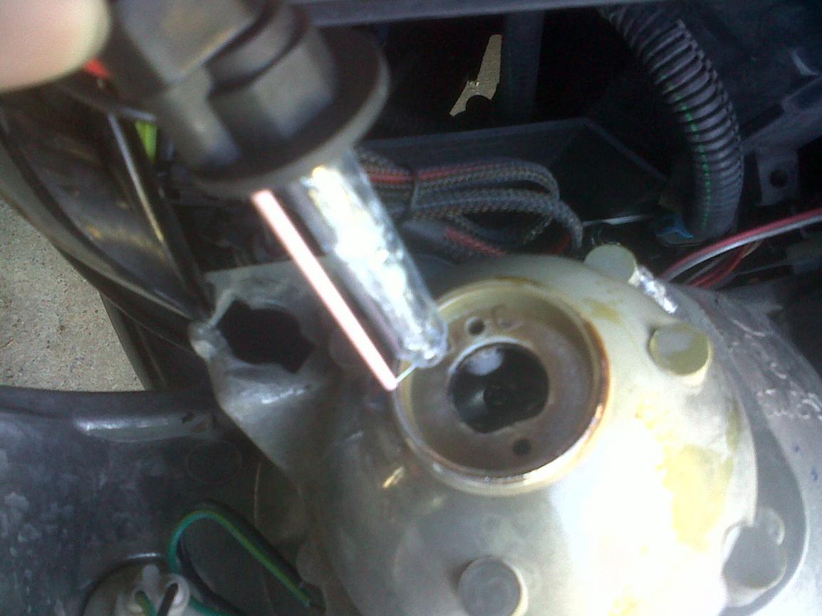

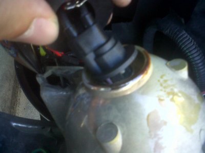

ok sorry it took another day, but here's a pic with one stocker in, you can see it's brighter, more concentrated.....also adding a couple pics of the HID bulb and housing where it goes in. Like I mentioned earlier, right now, the HID bulb sits loose in the hole, I got H1 bulbs, but should I have gotten different ones? I don't see how they are supposed to be locked in, although they stay there well, with everything behind it holding it there. anyways, don't know if that is affecting light output.

ok, well I figured it out myself.....had to make the holes larger to put the bulbs all the way inside and to be able to seal the hole shut with the rubber grommets or whatever you call 'em. before, they weren't in far enough, so the majority of the light was reflecting towards the back of the projector housing because of the reflector plate that is halfway inside....if that made any sense, but those babies are bright now!

I'm guessing that you bought the wrong bulbs, I thought the H1's were shorter so that would make sense that you needed to put them farther into the housings to make them brighter, I though your truck needed the 9005 or 9006 bulbs but I could be wrong!!

No worries man! I'm doing my bb tune meet in a couple weeks. Ya ddm told me it was the 9006s but I think here on the forum RT told me because I didn't have the stock lights anymore, but the projectors, I needed the longer H1s. I just didn't realize I needed to open the hole up some more. But found on ddm's site that sometimes that's necessary. I'm happy now. Thanks for the help buddy
