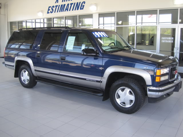

Ok, It's settled...the burban is going up! My wife says she thinks is looks funny as low as it is and that she would feel better about driving it if I lifted it (no need to ask why I love her). So I showed her the RCX lift on a suburban and she said go for it.
What I am starting with:
So here is the plan, this will start happening come the warm weather. Please feel free to chime in ideas.
So the following will be done:
1) RCX 6" lift with no crank so about 5" of lift I think is the actual drop of that kit
2) 16x8 or 16x10 wheel (thinking the ATX series)
3) 33x12.5 AT somethings
4) TruTrac out back
5) SS brake lines up front
6) while the exhaust is getting re-routed for the driveshaft I may have a muffler put on it too, something cheap but louder than stock
7) Black Bear tune
I think that is it for right now. I am not going to regear, this will never see anything but road. The running boards are staying also for the ease of getting the kids and her in and out.
EDIT: updated picture on page 9
