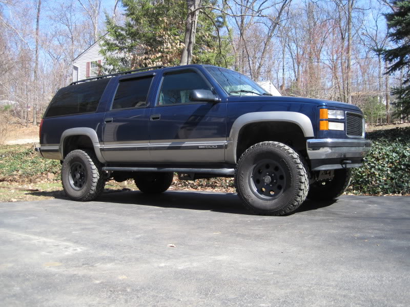

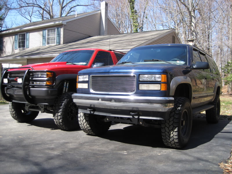

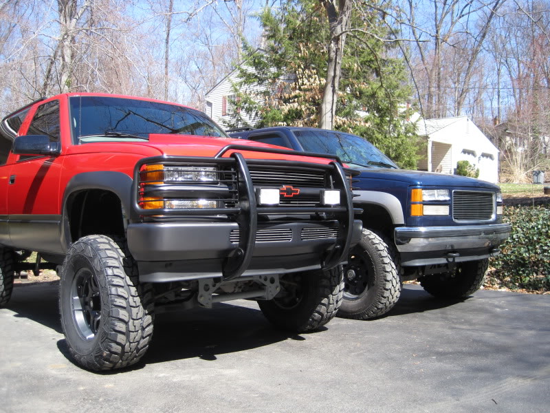

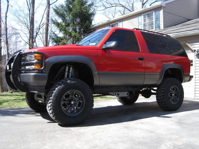

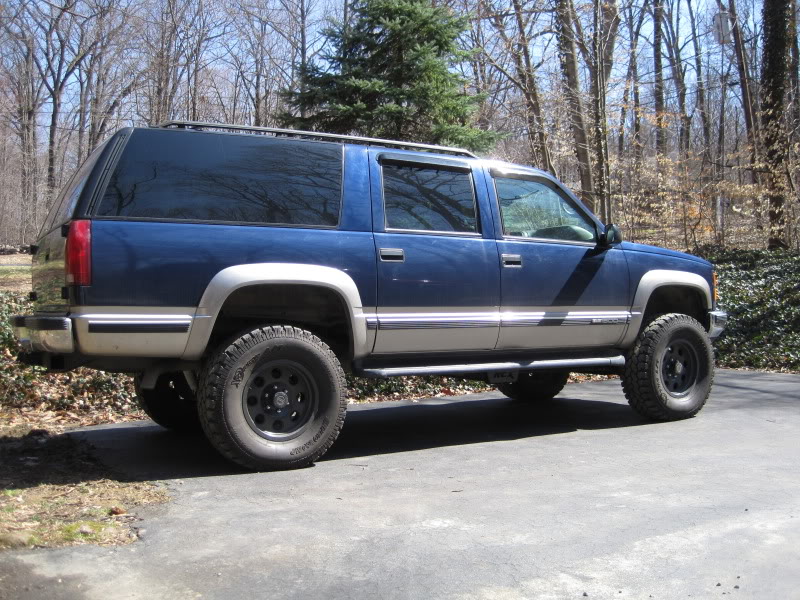

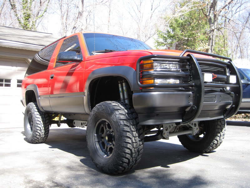

OK. Here they are:
1997 tahoe mods: HT383E, 4.56, trutrac, 17x9 ATX Artillery, 315/70/17 Kuhmo Road Venture MT, Cepek 6.5" lift up front, 6" procomp springs out back. Fender measure 45.5" up front, 43.75" out back
1997 suburban: stock 350, 4.56, trutrac, 17x8 ATX Mojave, 35x12.5x17 Procomp Extreme AT, RCX 6" kit up front with 4" blocks and add a leaf out back. Fender measure 42.5" at all corners

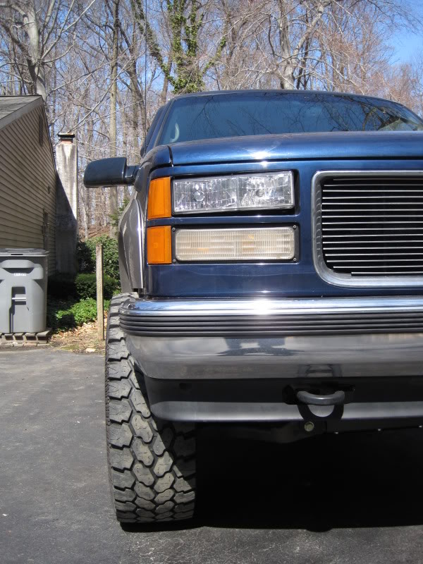

I just fixed it, I noticed it after the pictures. For the record I did not install them, I bought the truck with them. The adjuster bolt was rubbing so I opened the hole up. All good now.
Thanks for the compliments guys! All I need to do to the burban now is paint the frame, wheel wells, axle and what ever else is nasty under there. The frame and wells had never beed seen, I pressure washed them today and they need paint bad.
