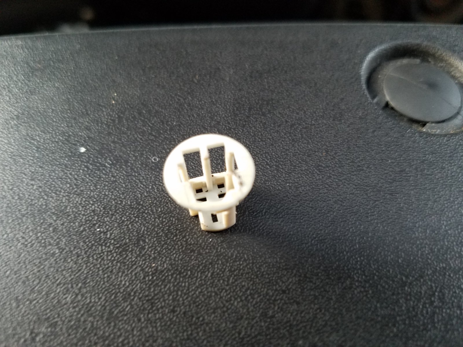

Keep this insert from the old one to use in the new one.
