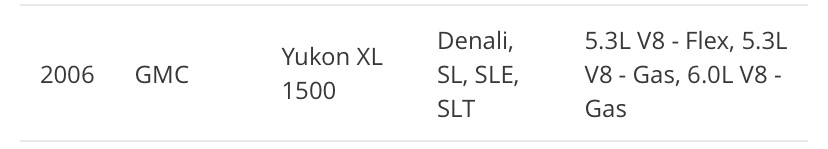

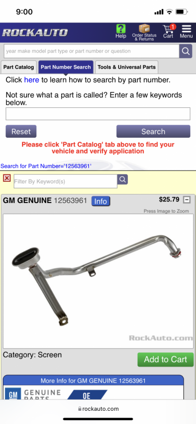

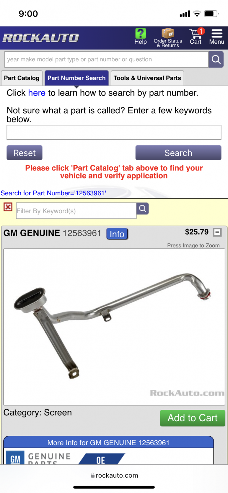

Here’s the RA page for yours but the GM one isn’t listed. However if you look at the Melling one, it lists 12563961 as an alternative part number.
The GM Parts Direct site does list your truck under compatibility for the 12563961 also.

I saw the rock auto listings and wasn’t sure which one to click on. Interestingly enough yesterday I did see the GM one but wasn’t sure it was right. Thanks for the heads up! I was thinking to order the melling one. Is that a good choice?

Melling is great quality. Their oil pumps are the go-to most of us buy.

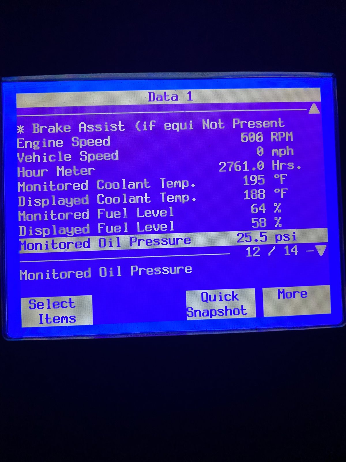

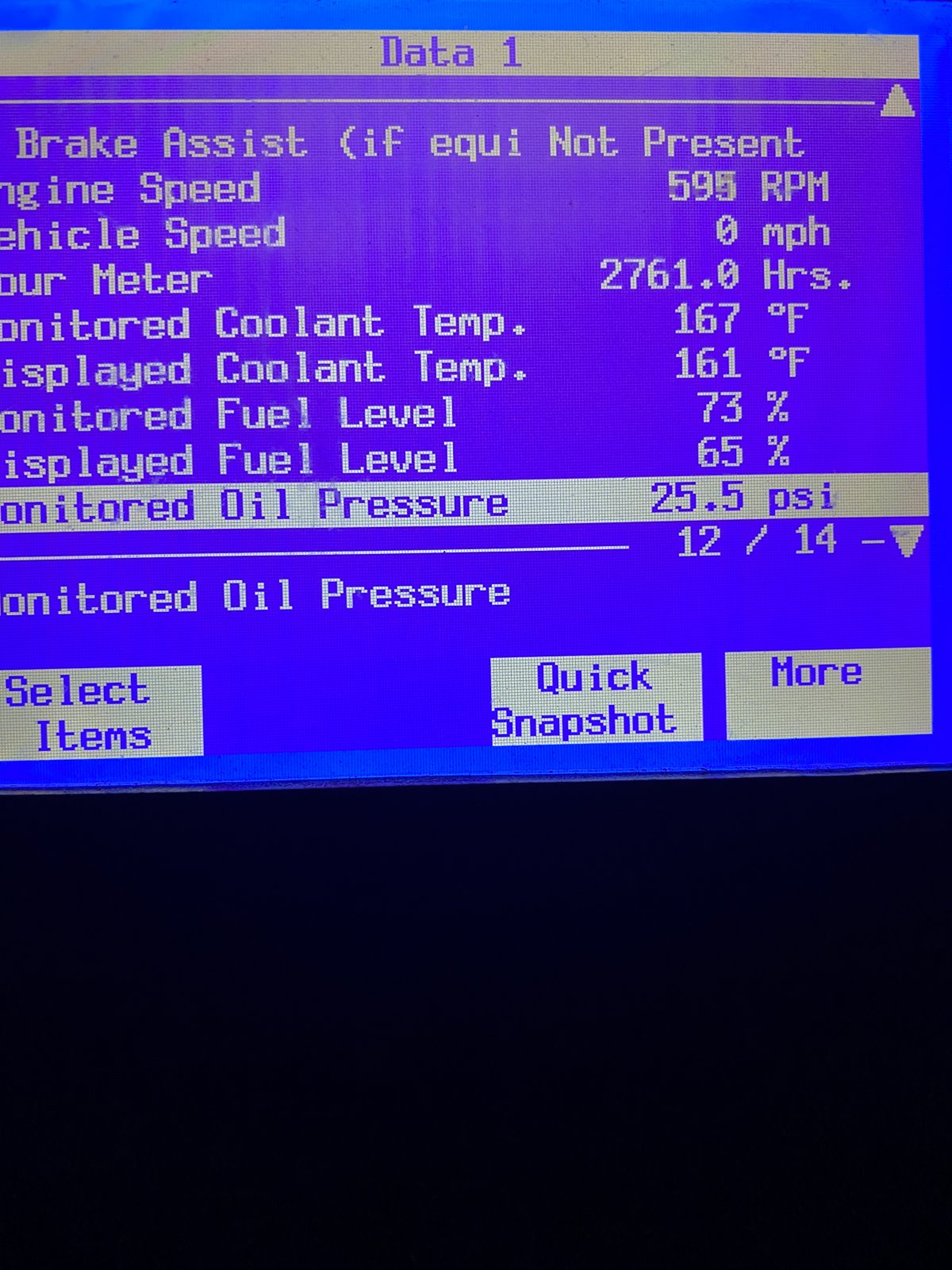

How low is the oil pressure--hot/cold?

This was at about the half way mark warming up. I couldn’t find the right menu that showed me the psi when it was fully cold.
