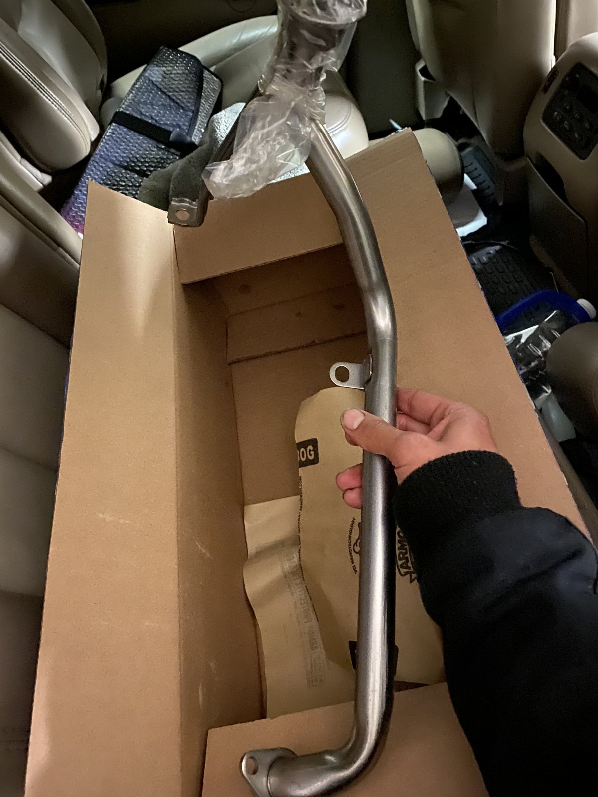

I haven’t looked at the part yet….. it’s been a hectic few days. I’ll post w pic of it shorty when I get home but this is what my rig looks like at the current moment….

Chase,
What are you doing to the headliner?
Will update my truck thread on that bit soon.

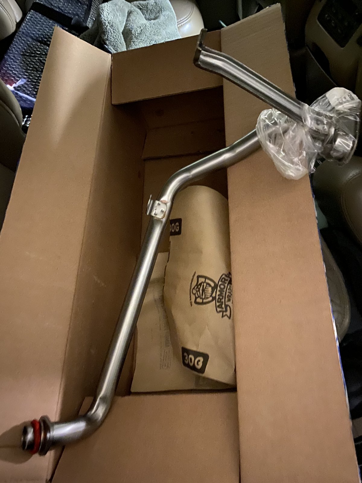

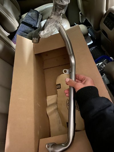

As for this this topic of the thread, I’m guessing the pickup tube is a GM part?!
