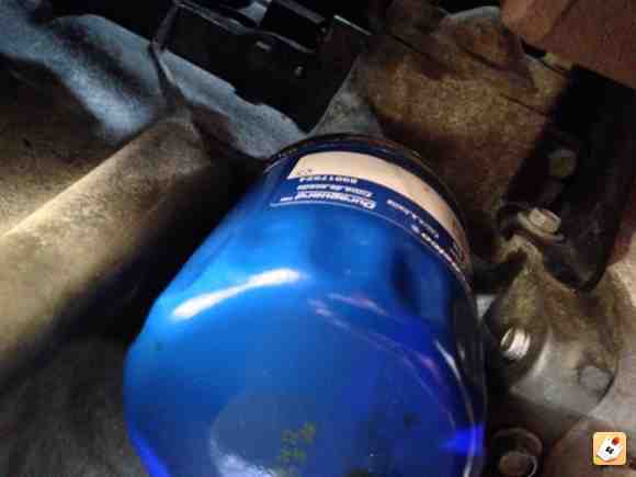

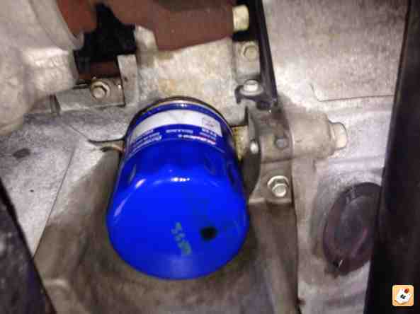

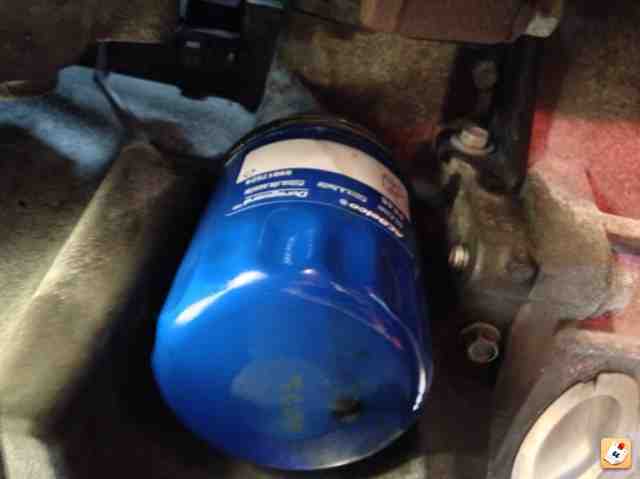

I purchased my 2008 Tahoe a little over 2 weeks ago. The last few days I have seen an oil drip where I park. I looked yesterday and could see a drip on the filter. I was able to tighten it by hand about a 1/4 turn more. I cleaned everything off and went for a short drive. I put cardboard under it and let it sit all night. This morning I didn't see any oil on the filter or cardboard. I drove to work this morning (mostly highway) which is about 25mins. I just looked again and I see a drop on the oil filter again. Any suggestions? It hasn't leaked the last few weeks till now. Nothing changed.

My bet would be that the previous filter's rubber seal was stuck and didn't come off and the new filter was installed on top of it. It feels like it'll never get tight when you're tightening it and it'll leak until you pull the filter. I've almost done this many times but realized something was wrong when i was tightening the new filter.

Also change in temperature will cause some leakage. Just snug it up, wipe it clean and check it after a run.
