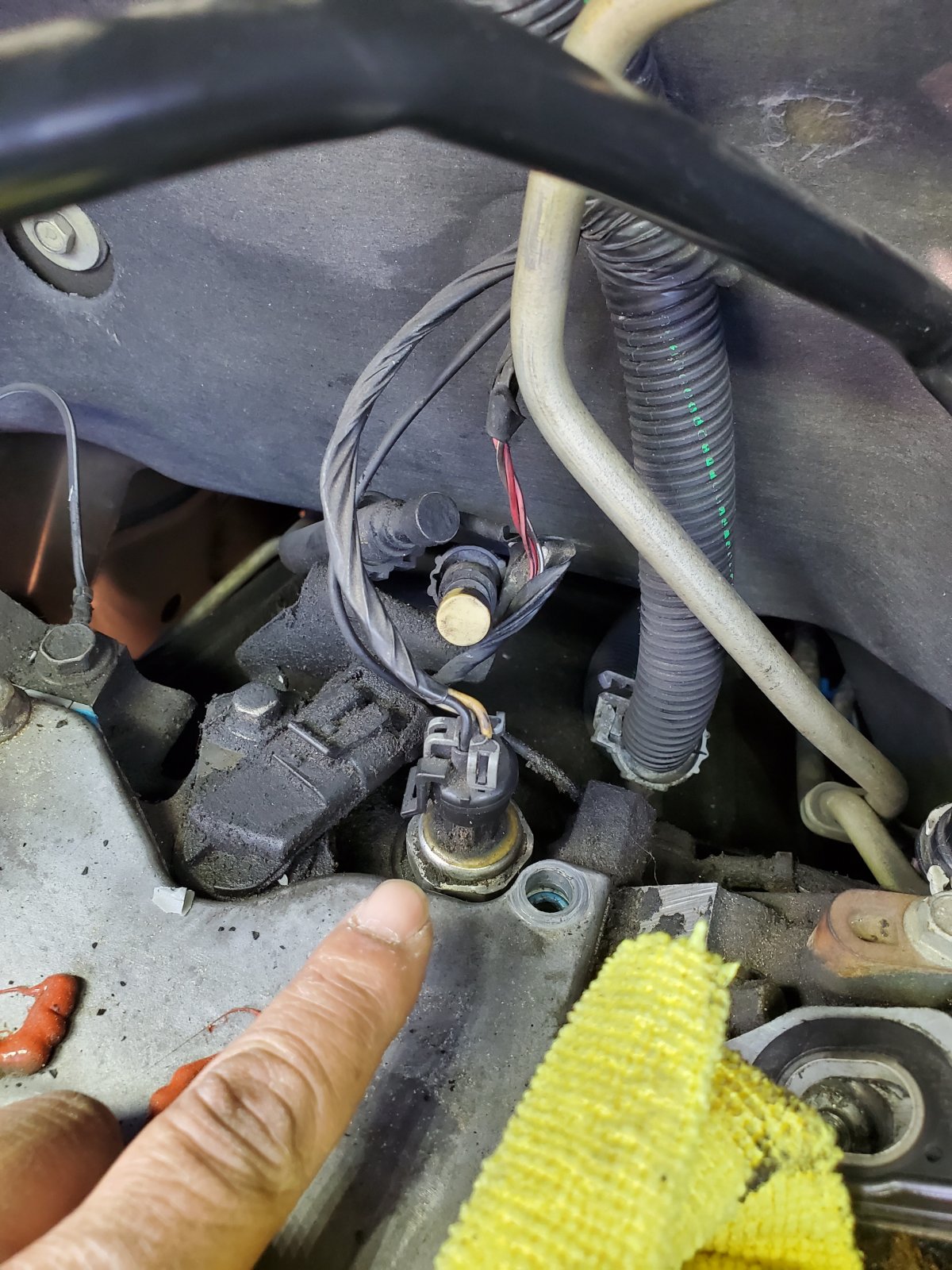

Check the oil pressure sensor. I replaced mine about a year ago (maybe longer) and thought it was o. There tight. Well the other day I swapped out my O2 sensor and saw that the entire back of my engine was drenched in oil. Thought it was the pan or starter bolts at first.
Then I did my Knock Sensors and when I checked the oil sensor I saw that it was actually loose!. Apparently my 1 1/16 socket was too thick to fit in between the sensor and valley pan cover bolt so it didnt get it nice and tight. I can 100% see this being a common issue.
As you can se in the picture I had to remove the valley pan bolt to get the socket on snug

Oil cooler lines at the mating surface with the oil pan are known to fail as well. But that leak is very specific to a general area and won't spray the whole back of the block like the oil pressure sensor will
