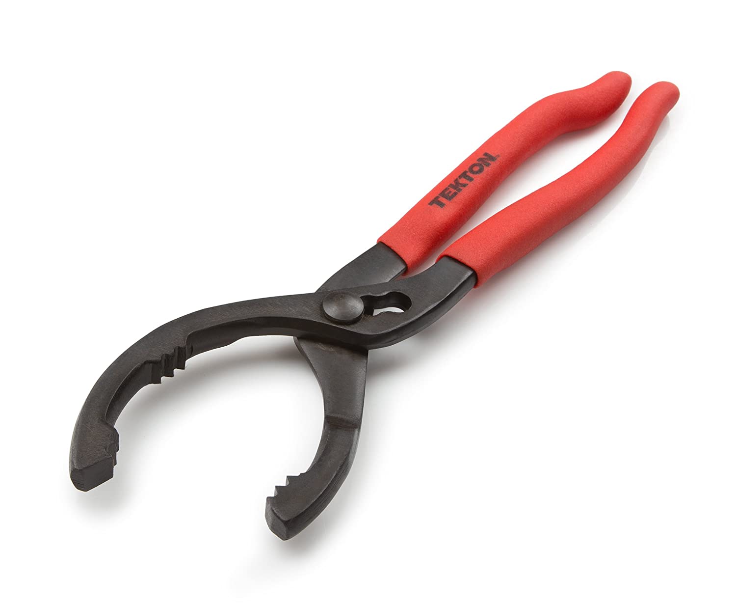

My favorite is a pliers-type that grips the filter. Ive used it on cars, trucks, boats, my PWC, and even motorcycles. Never failed to loosen a filter.

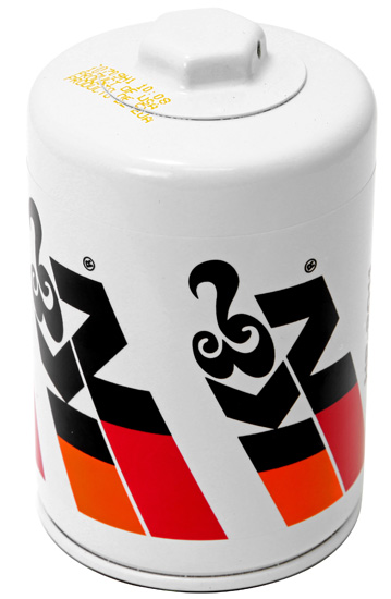

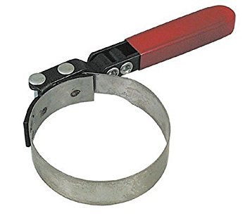

We've been using strap wrenches for near twenty years. Before that, oil filter pliers and before that, just plain old muscle when I was young and strong! But! These LS oil pans gobble up the little filtro so I started using long filters and discovered they were still a pain to remove. So now we run K&N oil filters with the 1" nut on the bottom and can remove them with a wrench or socket and ratchet.
And never forget the persuasive abilities of a long screwdriver and a hammer!
I had to do that once. I was using a strap filter wrench and it crushed the filter. Sucked big time, and it was a huge mess.

@Tonyrodz the trick to both of them wrenches posted are you never, and i mean never use them on the body of the filter, you can only use them at the very top of the filter where it meets the engine, up top is a solid metal ring, clamp anywhere else your crushing the filter.

Reflecting on this, we crushed more than a few stubborn filters with the pliers but very few with the strap wrench. It's the strap wrench that lets us break them loose near the bottom or most exposed part of the filter. These problems only happen now with new (to us) cars that enter our stables or on the rare occasion my wife went to help me out when I was sick and had someone else do the oil change. EVERY single time they screwed it up over the years.
