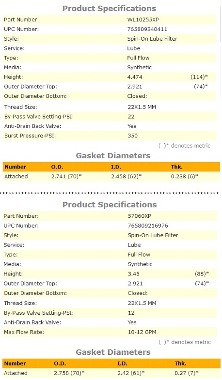

WIX WL10255XP is what the 2015 Tahoe calls for at RA and the 2014 WIX is a 57060XP. They may both spin on fine but there is a difference for whatever reason.
When you compare the pics, the WL10255XP is obviously longer than the 57060XP but they look to be the same diameter and seal placement looks the same.

Here's the comparison from the Wix fitment site. Although both don't have some of the same specs, the By-Pass Valve setting is significantly different. Gasket sizes are also somewhat different.
