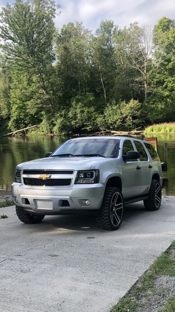

Looks great!! But my truck is literally on some new BFG tires and I couldn't justify the expense on the 18s. Will just have wanted the 20s down the rd.

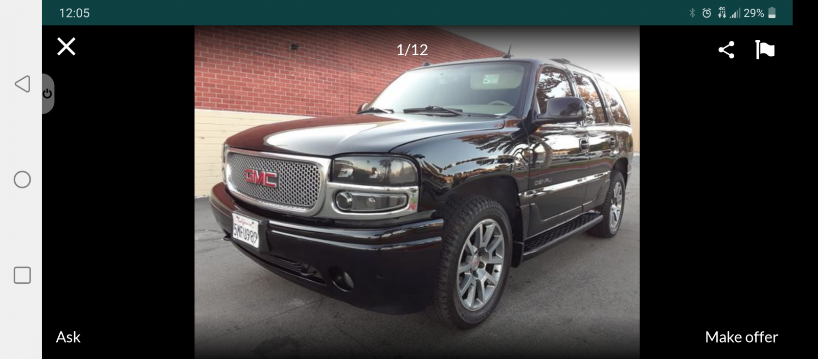

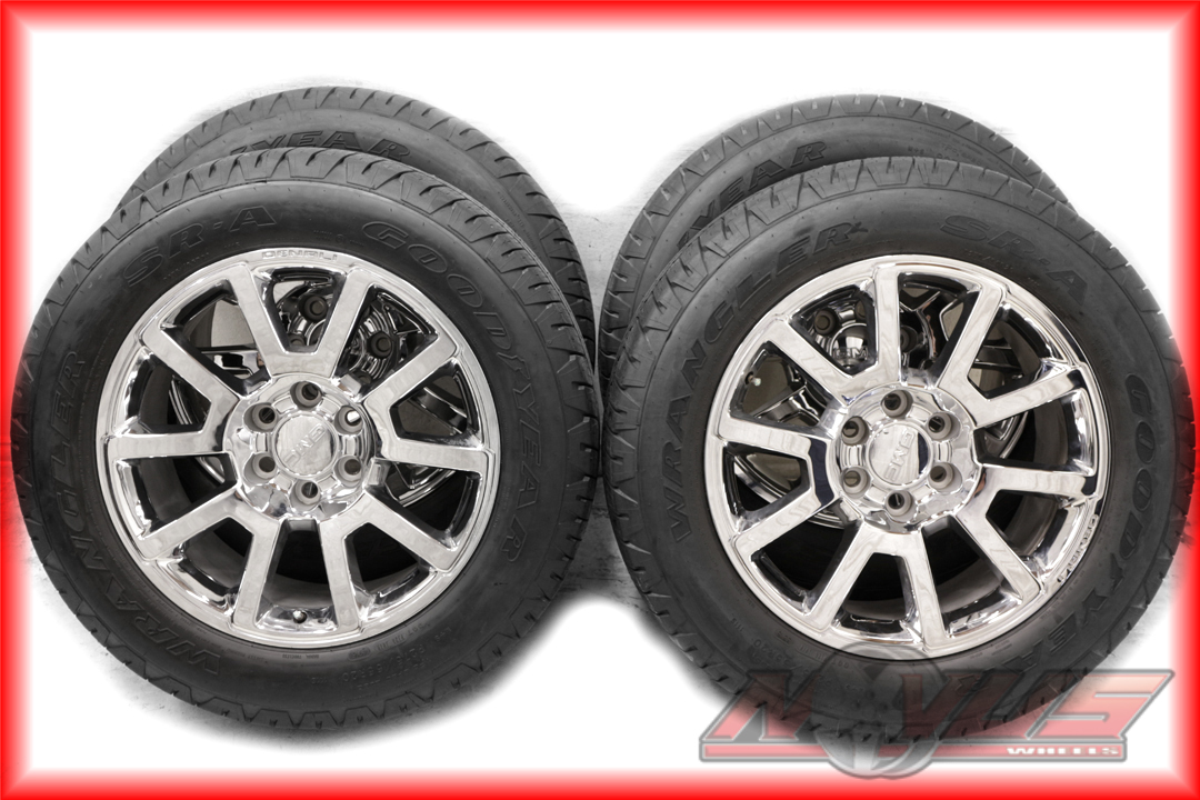

Guys , what is the name for these. Does any one have them on a 04 denali xl.
Looks like the OW5644:
https://www.originalwheels.com/gmc-wheels/sierradenali1500rims-2015.php
5644 anyway:
https://www.autorimshop.com/catalog...4963491449536&utm_content=GSAPI 58b0967f7d1ef
These guys have a good selection, but tbh, I didn’t see those particular wheels..
https://stockwheelsolutions.com/categories/gmc-wheels.html?sort=bestselling&page=8
