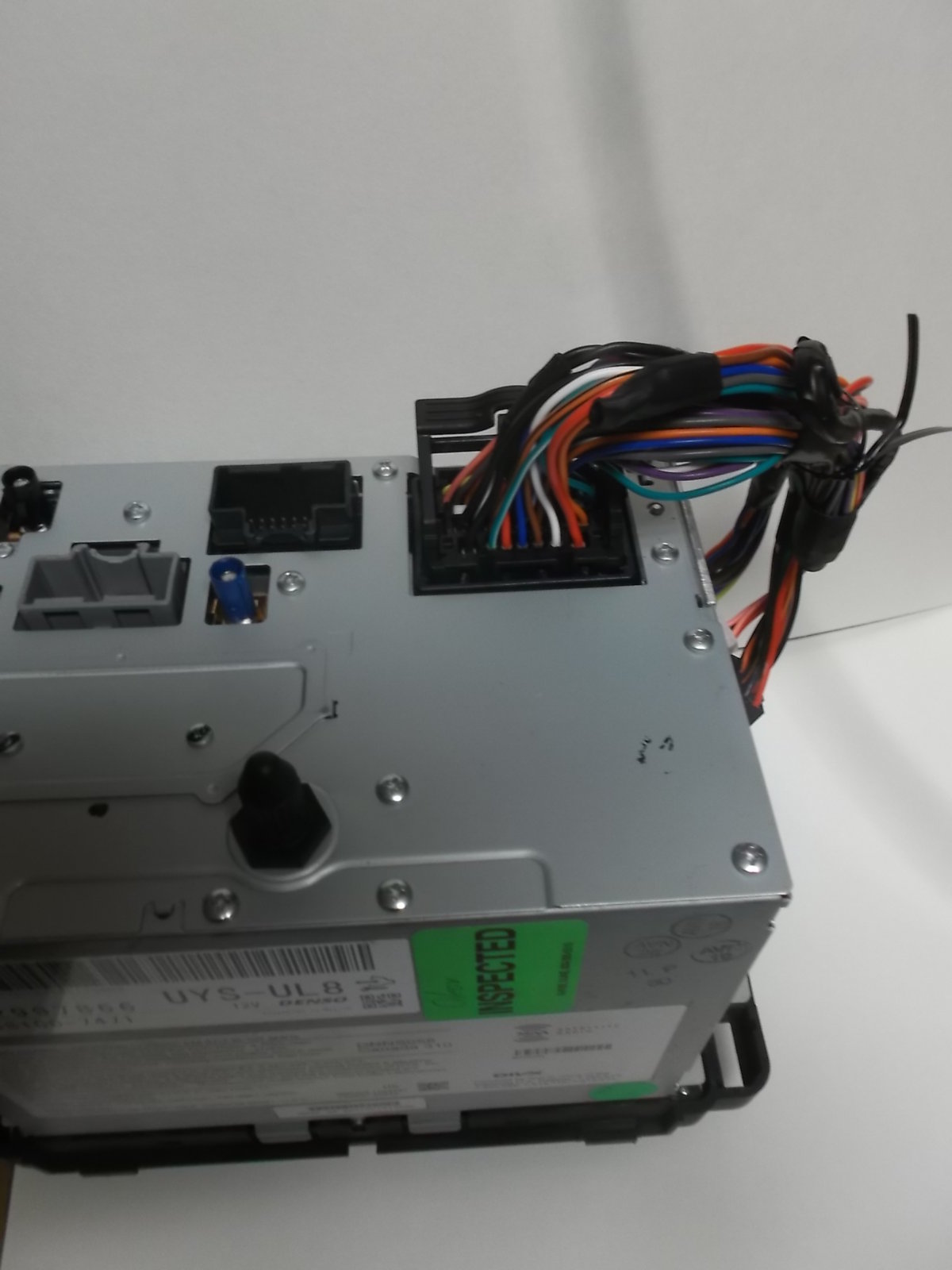

OEM Nav/Radio plugs in the rear.

Can you possibly tell me how the heck to get the main plug out of the back of the nav radio? I have been trying for nearly an hour and I'll be danged if I can get this stupid thing unplugged. I wanted to try a different Conversion harness but I am too stupid to figure out how to unplug this one!
Mike--Hamilton Chevy
The main one? the "double plug" It has a hinge/lock on it that you have to turn back, and it will push it out. Also, it needs to be open to slide it in (not force it) and close the handle, and the handle will push the plug in place. If you don't do it that way, but force it in/out, you might bend a pin.
Ron
(Works the same way as these "many connector" plugs and risers on mother boards.)

Well I don't work on mother boards and you are speaking greek! How do you turn back a hinge? How is it supposed to push out the connector when it will not push in to begin with? I have it pulled out and that is where it is stuck and so am I.

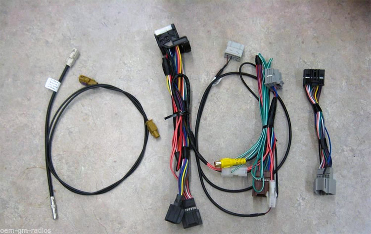

attached picture, the 3rd cable from the left, that big plug, has a 'handle' that you need to lift, uninstalling, and press down when installing. If you zoom in on the plug you can see the handle.
Ron
PS: in case you use an amplifier inline with radio-harness, there'd be two of these plugs

I have it up and the plug will not come out! See picture above a couple replies.

Is it all the way back? when you push that handle back, it pushes the plug out. If you forced the plug in without using the handle, it might be jammed, you can carefully wiggle/pry it out with the handle half way. Doing that you should see that handle move and help it come out that way. These plugs can be a pain, if they are not completely open when you seat them, and lock them, they can jam.
The handle should push it out initially, and use it to take it out.
