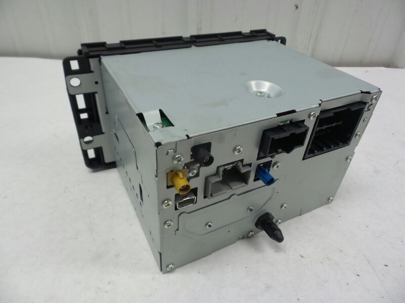

I am about ready to install the Nav/Radio, but was wondering about the plugs in the back.
I believe, from what I see in videos, the gray and smaller black 'receptacles' are the ones also use by the 'basic' radio. The blue one is for the GPS antenna (that I am still waiting on) I would assume the black one is the AM/FM antenna and the golden color one probably is for XM (?)
I am not sure, but I have the impression tht the bigger black one is used for the harness that connects the rear seat audio (?) .

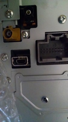

Below the golden connector, there is something that looks like a USB socket. Does anyone know what it is for?
If anyone can confirm, or correct the function of these, please let me know.

You can run a usb cord from that to the console(like in my truck) or to one cig lighter hole and get a usb port so you can upload/download right to/from radio (iPod or phone or flashdrive etc)

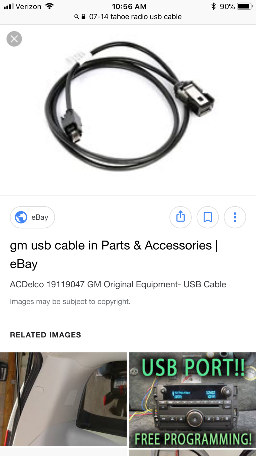

This looks more like it, it looks like the cable can be locked into the socket, so it doesn't come out. The "free programming" remark got my attention... wonder what that is about? Wonder if you can do things like, unlock the radio etc.
I know some ‘used’ radios are unlocked from ebay meaning plug them in and they grab your vin and work, others if not unlocked will not work until you have them programmed to your vin. That said, chevy dealers have been know to say yes they can do it then ‘brick’ the unit and its garbage at that point.

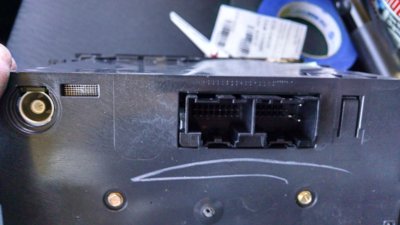

I think I had the right cable, but I don't think this is the right one? I took a closer look at the USB plug in the back, here's a pic.

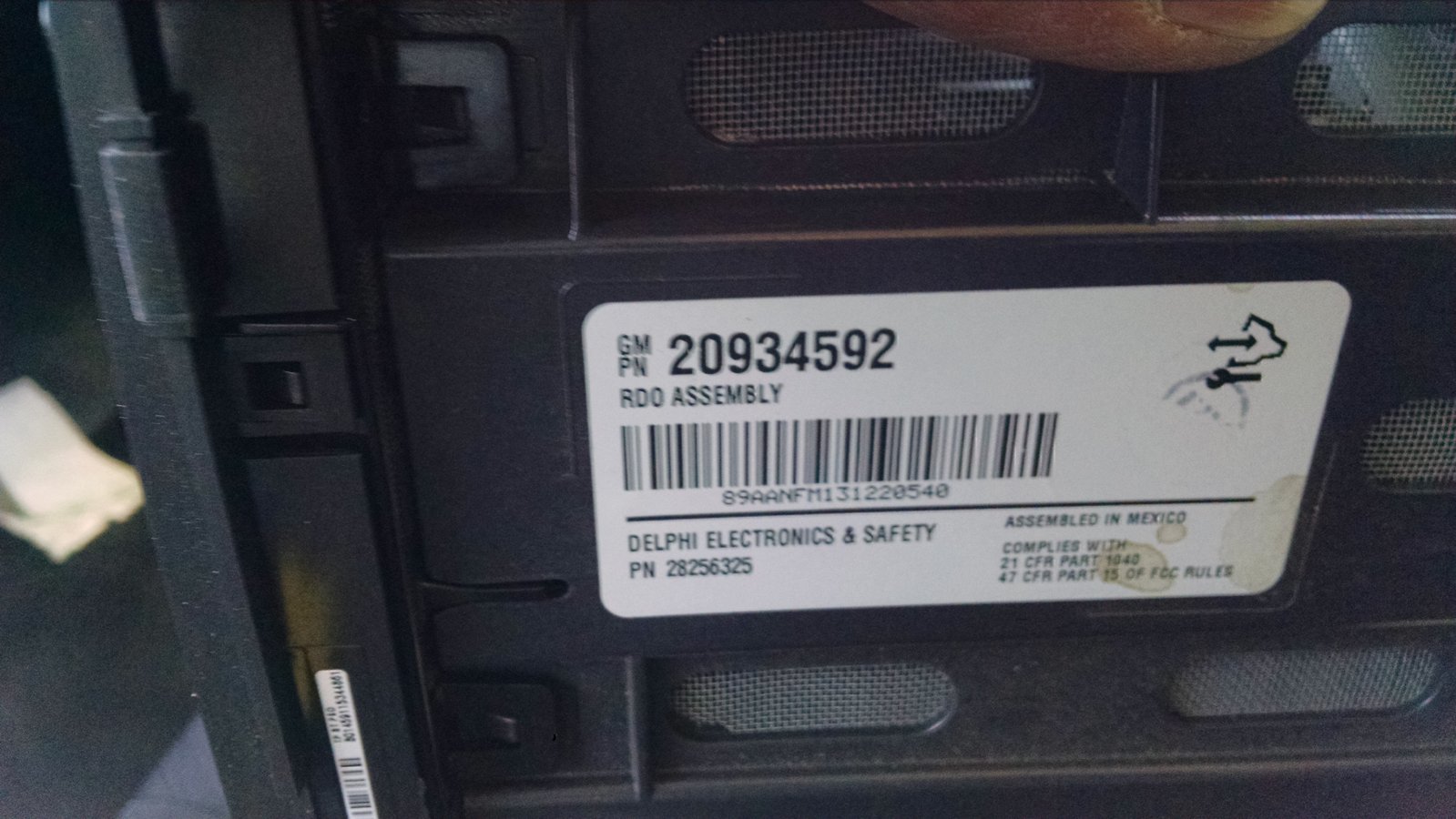

I tried to swap the radios today, but it seems that the radios are not "plug compatible" So I guess I need some sort of harness to convert from the basic radio to the newer nav radio?
What is in there is the GM 20934592 radio and I want to replace it with the GM 22997866. Any ideas of where to get that harness/kit?

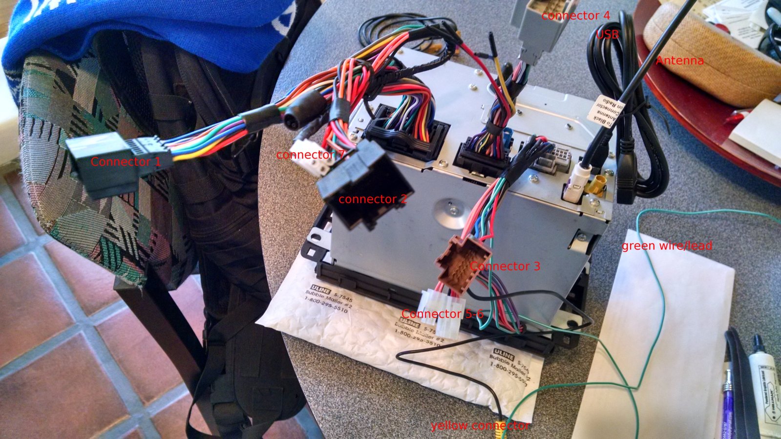

So today I did get the wiring harness, but it has a bunch more plugs then I expected..
I'll attach a pic, where I numbered the plugs.
Connector 1 and connector 2 seem to be the same as that the basic radio has. The antenna adapter is to the left (next to it is an additional USB cable that I ordered. The yellow connector at the bottom seems to be for video, backup camera?. The gps connector goes to the blue socket.
What I wonder is, what are connector 3,4 and 5,6 and 7 for ? The green wire/lead I have seen in a youtube video, it connects to the cars speed sensor-wire?
It looks like, it seems, a bunch of connectors are simply not used, or are for different model/make vehicle?
any input would be great.

I'm thinking Om Star and/or blue tooth, Remember what I said in another one of these posts Some of this stuff cant easily be added,
Ron you definetly have my interest now.
I am figuring this out as I am going with it. I am pretty sure the golden connector is the XM radio one (which I don't have/want, you need an extra receiver and antenna for that.) The blue one is the GPS antenna. The two black ones, in the harness, take the two plugs the basic radio has (the basic radio only has two plugs + antenna, so my wild guess is it will make the AM/FM part work) The AM/FM antenna goes in with an adapter too. GPS only needs an antenna, so I expect that to work too. Of course DVD and CD-audio etc, doesn't need anything else (probably)
So I guess, AM/FM, CD audio, DVD, and GPS should work. The other connectors (wild guess) are for the rear seat audio etc. (if that would ever work).
I am sending the radio to a "OEM radio guy", that will unlock it for me.
The dealership wanted $247 for unlocking the radio (even if they couldn't get it to work or permanently lock it, I still had to pay it.) They also told me they had to re-program all the RPO-codes... (my reaction was: "Whaaaattt????". (oh and it was between $3 - $5 per code, depending on the code.
Pretty sure it's a rip off, so I am sending it in, the OEM guy guarantees it will work in my vehicle after they are done with reprogramming it.
After it 'all' works, I might be up for an experiment and see if I can get the harness that runs through the console and hooks up the rear audio. I read in some description (the conversion harness will retain the optional installed rear dvd and rear audio). If that harness is not too terribly expensive, I might just get one and give it a try.

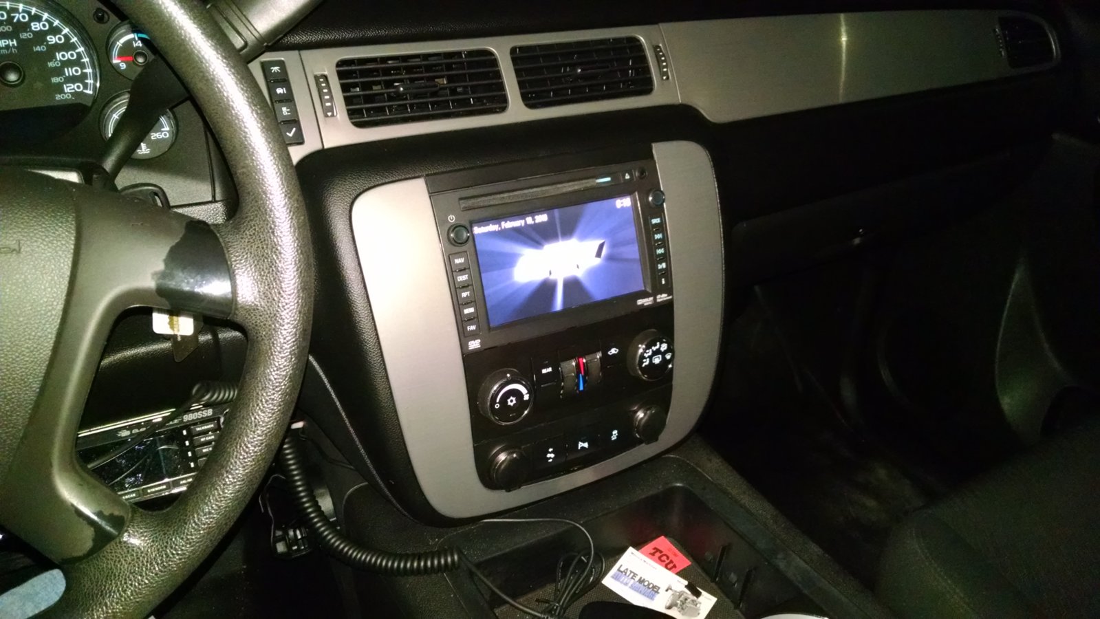

Finally, installed the re-programmed Nav-Radio ... it looks a little "The Matrix" but so far i am happy; here are the pics.
