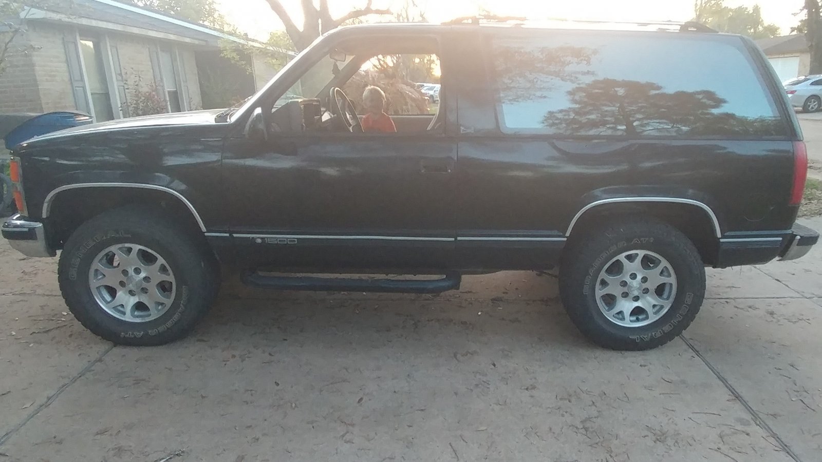

I just bought a 92 K5 Blazer. Runs and drives pretty well. Took it out last night and noticed that the tail lights aren't working. The were working in the driveway, but now I can't seem to get them on. I checked the fuse under the dash, it is good. Am I missing another one somewhere? Might just have to get the power probe out, dang it. Here's a pic, everyone likes a pic, lol

Good lookin' rig. I like those 2 door older rigs.
The taillight assemblies were known for going bad although I doubt they both went bad at the same time. Check for wiring plug in and ground problems.

Super nice 92 Blazer Jon!! Looks to be in excellent condition and well maintained.
