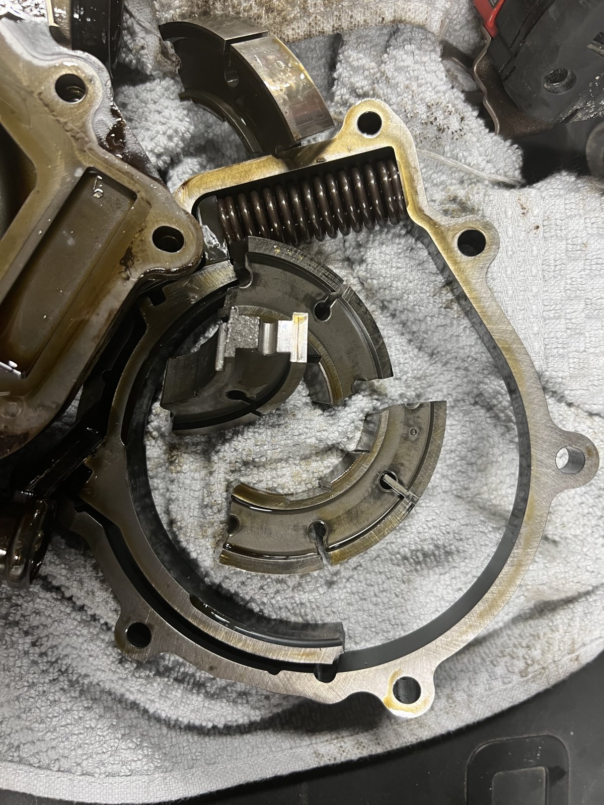

UPDATE!!
Pulled it all apart and found the oil pump (Gen V engine) broke, not quite exploded but the main pump “gear” was in 5 parts along with the veins being destroyed. Absolutely no metal in the pan, all cylinders and can look great (looking from below)! Not sure what would cause this other than “ mechanical failure” but going to try to change it out and put it back together!

Thats a new one you might talk to service at GM to see if they have seen that before. I wonder if oil change place ran that engine without oil for a while, then put oil in crankcase after they realized they forgot.Is there galling marks on outside of broken parts crazy.

They have been having issues with the Oil pumps on the 6.2 engines. Numerous ZL 1 in camaros have had the exact same thing happen.
