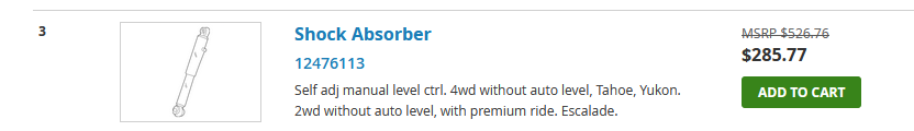

Aaah, 4x2 Premium Smooth Ride. This from GM Parts Direct:
Rock Auto lists them but no price since they're out of stock there.

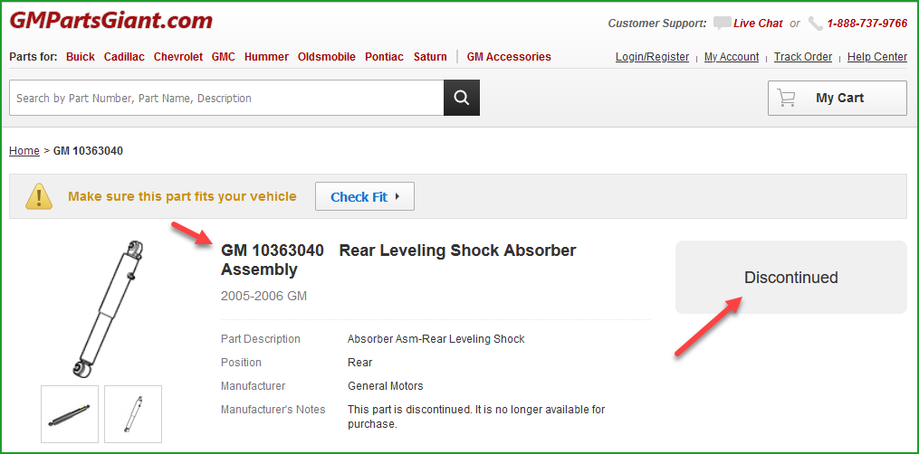

GM parts direct canceled my order they said the correct part number is 10363040 and that it has been discontinued. They told me this via e-mail as they do not answer phone calls… so anyone know if this is correct?
So a crawl under the truck and it does have the Sachs 10363040 red shocks. The are bigger than the standard shock I always thought these were Nivomat shocks?

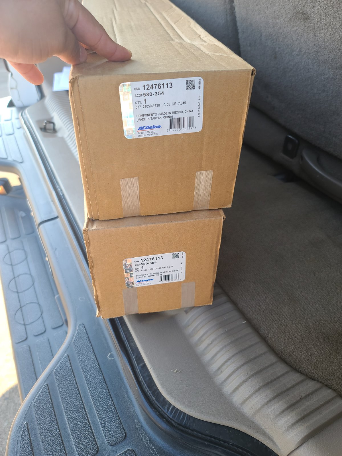

Mines a 2005 Yukon 2WD Zw7 this is what I used. Not sure if you are saying they are or are not nivomat on your truck (mine were). Got these for $225 or so when Amazon had an AC delco sale
ACDelco GM Original Equipment 580-354 Rear Shock Absorber Kit​
These are the ones that I ordered. I paid $258 each. I hope to install them tomorrow.
