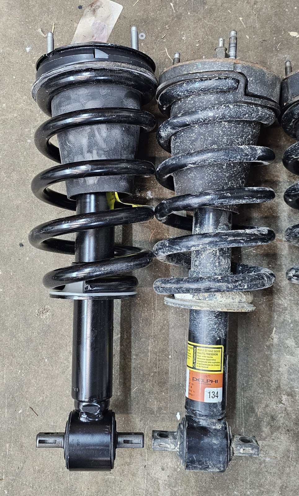

Before i went to the wrecking yard to get a couple front struts i checked Rock Auto and ran across These
Cheaper than used wrecking yard parts. All i will need to do is change the struts out and the setup will be all new.

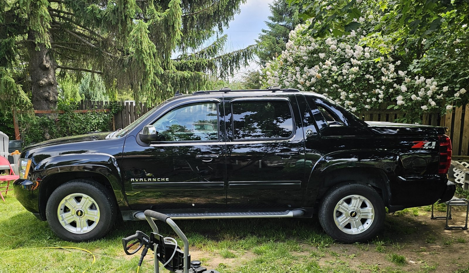

I love the factory Z55 ride.
My wife does not care what i do to Cracker. She has her Avalanche or ***** as i call it.

I call it S P O O K

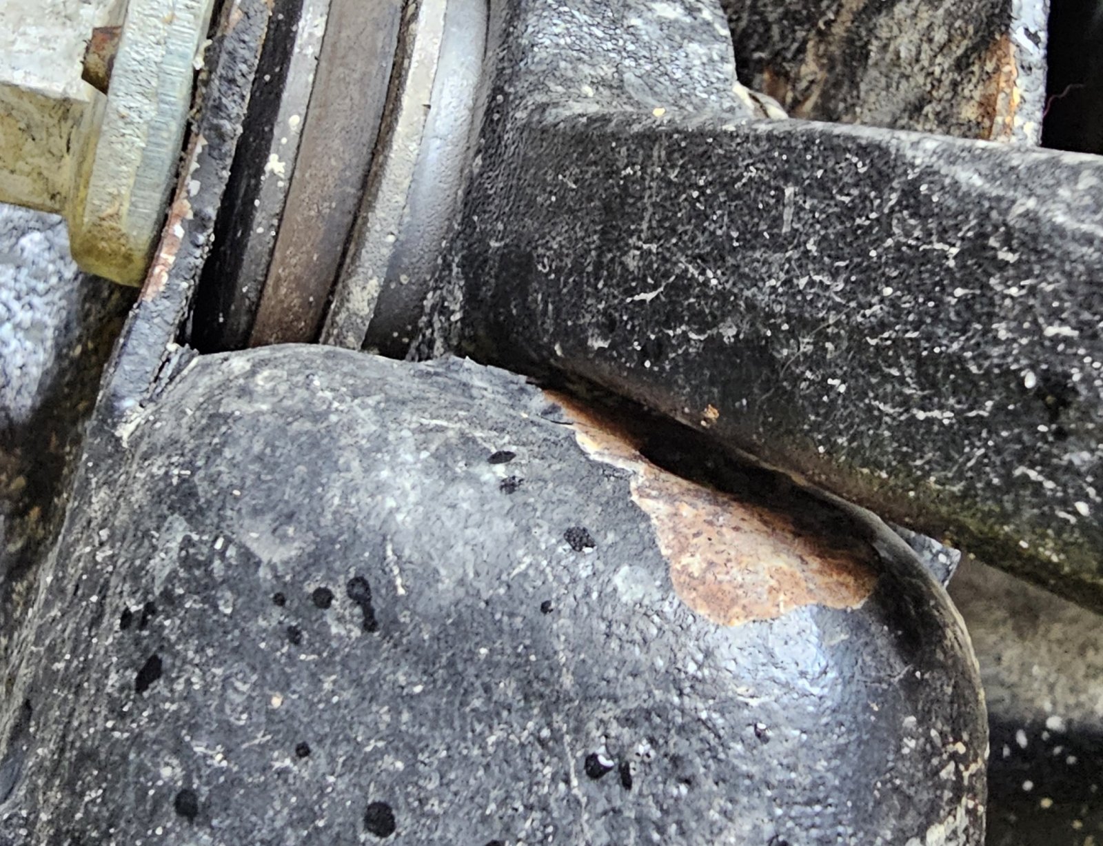

Got the new Monroe struts on today.
Driving now it feels pretty normal. The only place i really notice a difference is when hitting small road imperfections. With Z55 i almost could not even feel them without Z55 you do but nothing harsh, just normal. Driving over bigger bumps they are slightly stiffer then Z55 struts but not much. Maybe they will loosen up a little after driving a few days?
Pretty sure i figured out why i keep blowing struts. The struts are fully extending before the control arm is hitting the bump stop. Struts are not made to take the place of bump stops and at full extension the weight of the suspension wheel/tire is too much and it breaks something inside the strut.
The new Monroe struts are a little longer than stock struts and at full extension there is maybe 1/8in between the bump stop and the control arm. Stock struts at full extension there was about 1/4in between the two.
I'm thinking this weekend i will take some flat iron and tack it to bump stop so the control arm hits before the strut reaches full extension. If that work over the winter next spring ill get new Z55 struts and add more to the bump stops.
