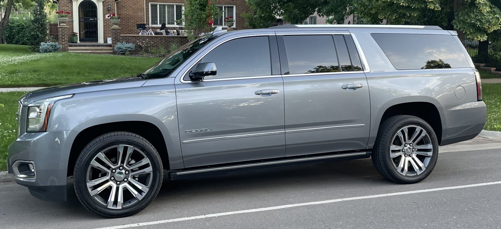

Welcome to the Forum from NH.
Pics of the truck, please.

Here's a pic, for those interested.
