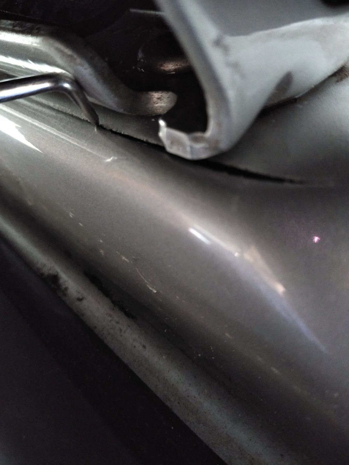

I've looked around here before when I had my 09. Bought a 07 yesterday, headed home started pouring rain. Got home looking around, under rear cargo mat was wet? Didn't think much the seller told me he had the carpet shampooed. Went out b4 bed, water running down the inside rear panel. So today took panels off, wife hose piped water on roof while I was inside. Instantly water on my head. Not from the rubber gromet where I would have bet my check, because someone had already caulked it:( CRACK in the roof by the hinge. Figured I'd share. Might help someone else. Awesome forum!

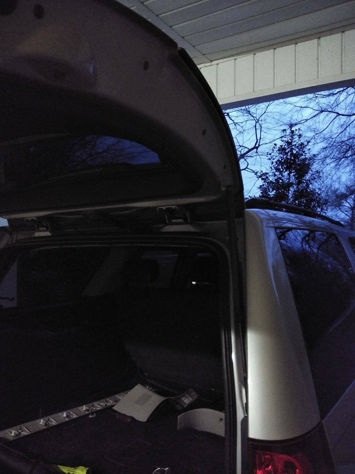

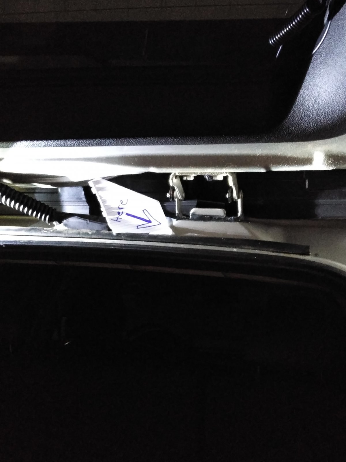

where exactly is this crack? can you post up some pictures a little further back so we can get a idea of where you are talking about

He already offered to take it back. I'm just going to fix it. Tahoe is in good shape.
that is severe structural damage just take it back.. it's been in a accident into a soft object at low speeds. if the hinge broke (possibly while the tailgate was open) OR they had it open when it was in motion. you could be suprised how much damage can happen when the wind opens your door
my friend totaled his car when the wind fling the door open.... framed damaged the door edge somehow ended up crashing into the fender and crumpling the fender and door edge
this is a clear case of frame damage i would renegotiate the price as you over paid for something with frame damage.. if you want to keep it

Any evidence she was hit back there or the driver backed into something? Could it have come from lifting the hatch too high?
Thanks for the latest pics, I was lost!
that's what I am thinking someone might have had the cylinder off and lifted it too high, really odd place to get a crack otherwise, maybe it could be welded if you want a permanent fix

It doesn't look to have been in an accident? I usually can spot a repaired/painted vehicle across the parking lot. I've done body work before. So I used some rtv in the crack. It rained all night, checked it this morning...drip,drip,drip. It's definitely coming from around the hinge. I'll get the hatch off this weekend and see. It may have a crack under the hinge. Bolts were tight. Back to the drawing board.
