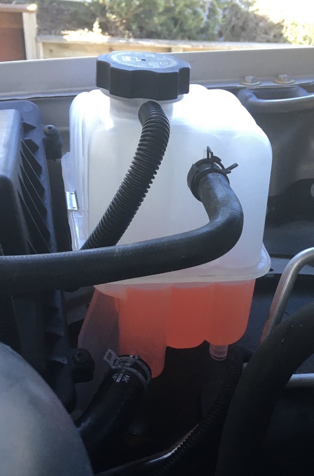

I replaced the overflow tank and cap. The new tank looks great.
Take a look. Old dirty 16 year old tank and the new OEM one.
