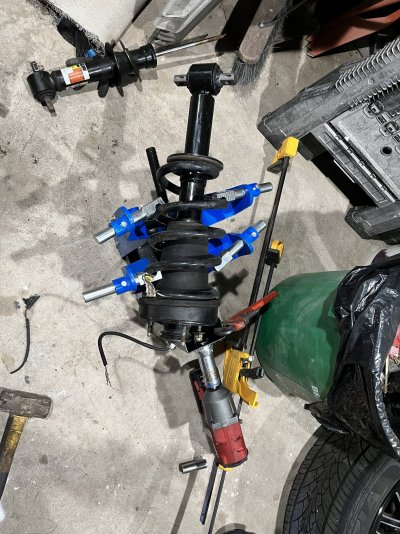

cdeadly
Mar 25, 2023
14
Update, complained to the dealership I bought it from and they offered to pay half of the shop cost for new struts, I didn't like that, so they offered to buy me new strut assemblies for both sides, they bought some with the magna ride from TRQ.
I put them on myself after watching a YouTube video, it was very easy, the truck recognized the shocks, and it rides like a dream now and sits up a little higher too. Thank you all.
