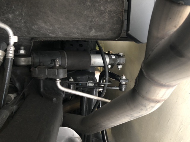

Well those djm endlinks were not needed. Stock ones will work. Just move the mounting bracket as shown. Hotchkis front and rear sway bars. Perfectly aligned. Picture is sideways for some reason.
D8833B4E-2F05-4556-A281-F68AA4F738CC.jpeg 5FC5B7CB-FFFB-43FF-8550-E803560A2C20.jpeg
