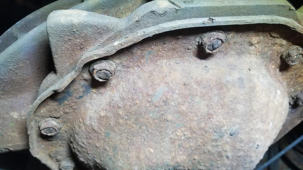

This thing is seriously rusty under the back end. I'm getting the previous owner launched a boat in salt water.

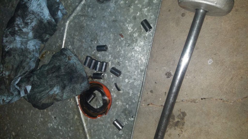

At that point I decided I had to go rent a bearing puller. I slipped the puller into the bearing and started wailing away. What I got was shrapnel. The side of the race blew out and pieces flew.
But not the whole thing. With the roller bearings out of the way I walked the puller around the bearing hammering away all to no avail. A very smart friend had told me that if you run a bead of weld around the inside of the race you're pulling when you're done it'll shrink and practically fall out. I did. It didn't. I finally shoved the bearing puller all the way in through the ABS ring and got it well hooked on that. Finally I was able to pull the bearing race and the now crushed ABS ring.

I got the puller set from AutoZone in their free loaners. Couldn't get the puller to sit squarely on the seal by itself or the bearing. In frustration i just shoved it all the way through the reluctor.
I had to lift the edges of both seals with a cold chisel and roll them in until I could grab the edge with channel locks and peel them out. It's like someone glued everything in.

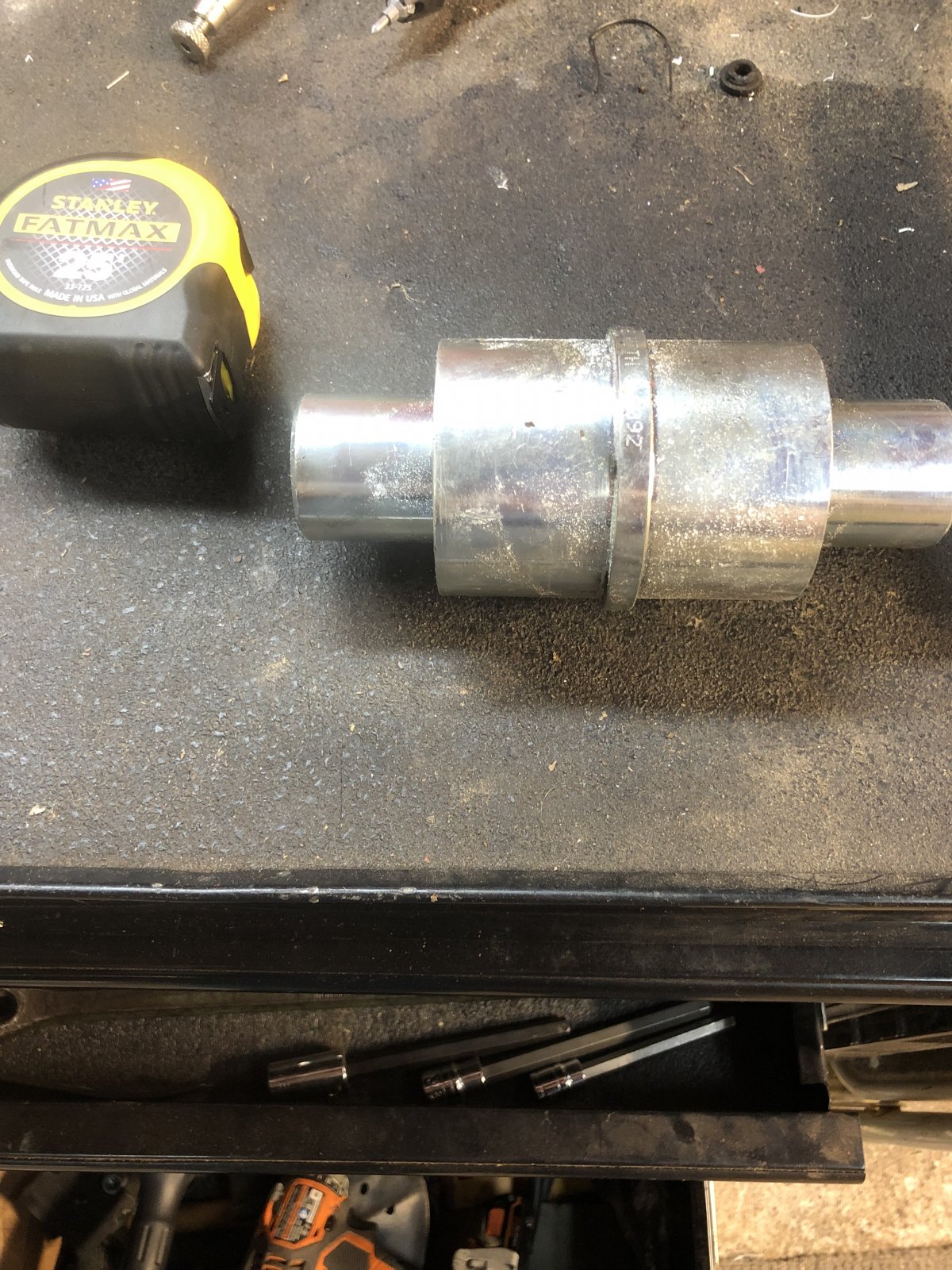

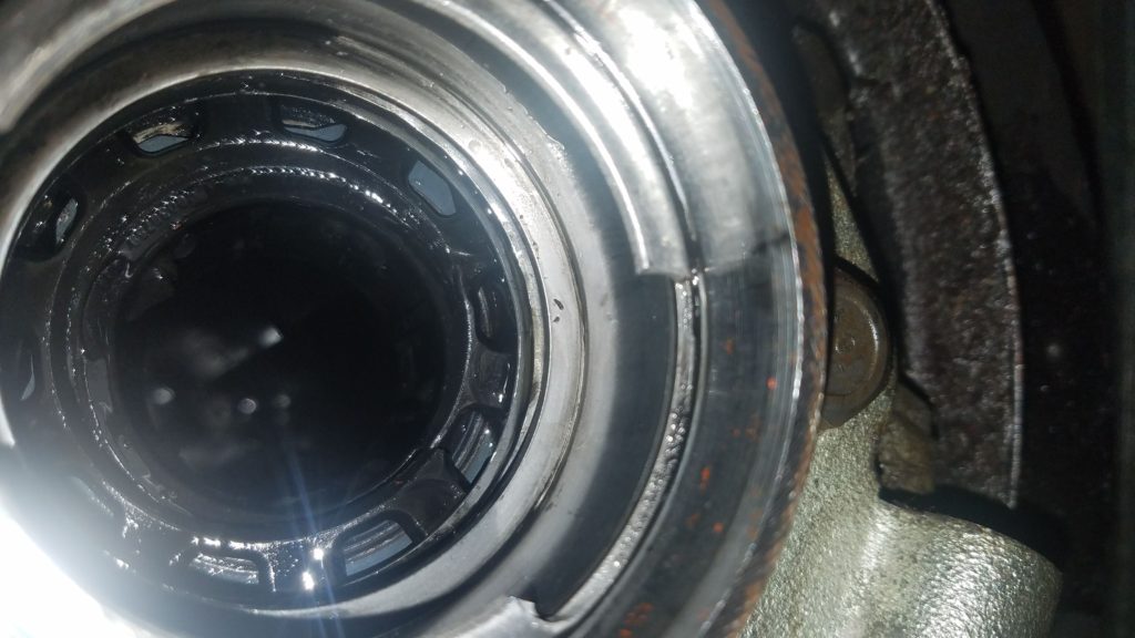

So after getting back after it with all the parts I cleaned up inside the housing and there are stops for each of the Tone Ring, Bearing, and seal. Okay, the seal stops against the outside of the housing.
I had a rented bearing and seal driver but it was a stupid design and I couldn't come close to using it for the Tone Ring (reluctor). I used a large 3/4" drive socket and walked it in with that. Worked fine.

My new diff gasket was rubberized so I skipped the RTV. One of the bolts for the cover is a few threads longer to hold the brake line clip. Got that on there too. Filled the diff with synthetic and a tube of friction modifier. I don't know if I should have used the friction modifier for an Eaton diff. Seemed to be just a little low on oil yet so I guess I get to go buy another bottle.
Putting the brand new rear rotors onto the brand new parking brake ring I had adjusted both sides all the way back in. One side slips right on and seems loose. The other side didn't want to go at all. I figured it just wasn't centered properly but nothing I've done yet seems to get it centered. I pulled it down using some of the lugs. Who knows what havoc will occur the first time I drive it. I did hold the parking brake release and pump that up and down. Needs adjustment. Gotta go look that up next.
To make getting to the rusty bolts on my diff cover easier I took the cross brace off from the suspension. With the axle at full droop I won't get that back in. I'll put my wheels back on and jack up the diff until that's close or lined up.
