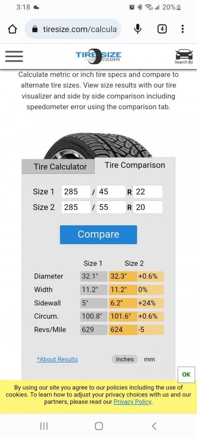

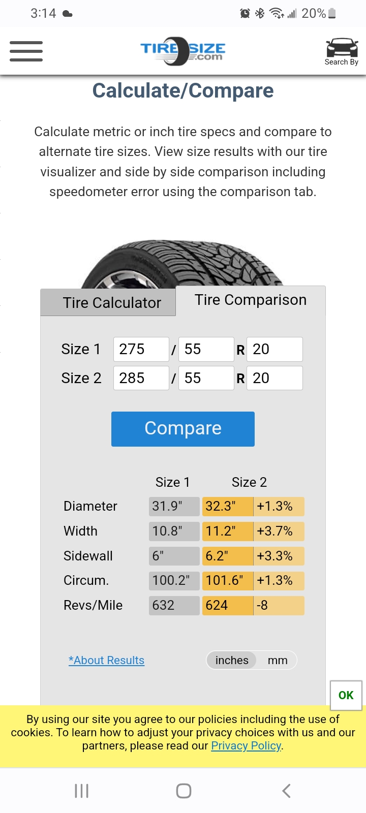

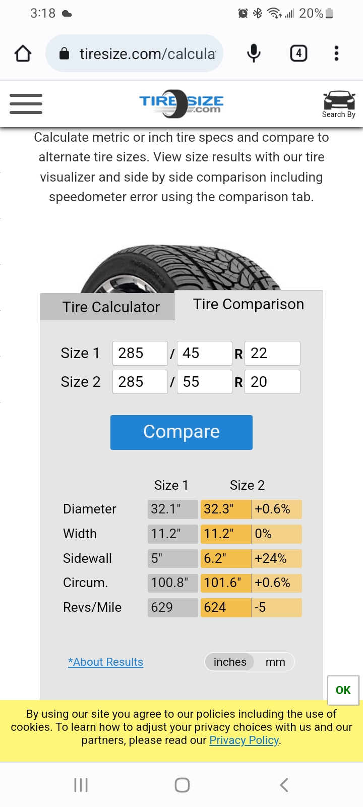

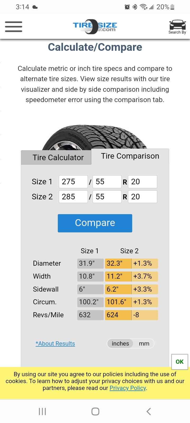

I think the Tahoe would look pretty BA with those wheels and tires. I like tire size calculator for this sort of thing. They should fit just fine. I attached 2 pics of comparison.
My 2017 Denali came with 22 inch wheels and they are almost exact to what the Sierra wheels you found are. No issues at all with my OEM setup, so you should be good.
