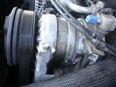

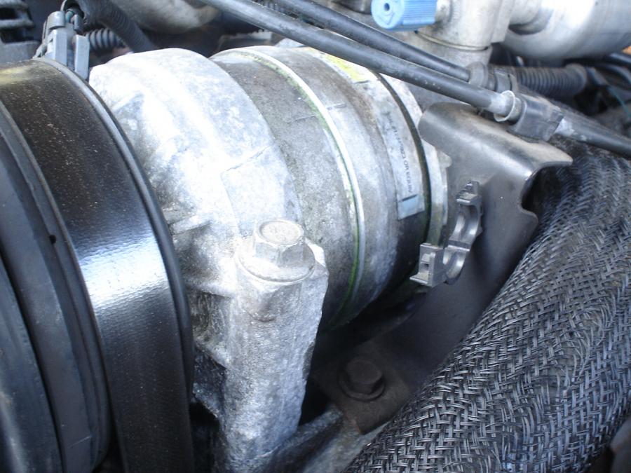

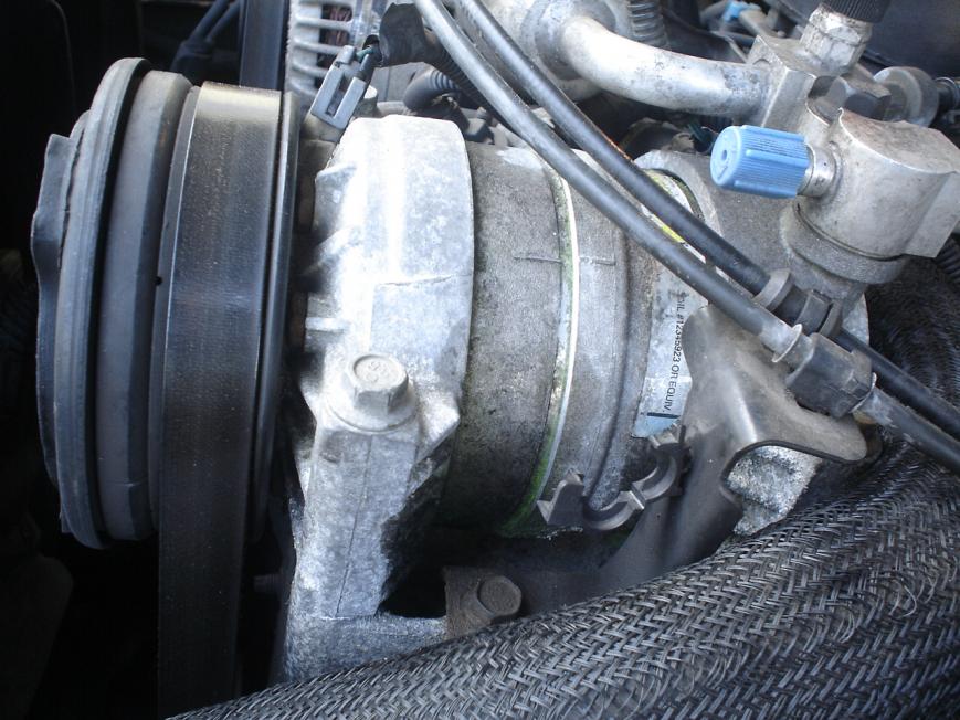

I drove the truck about 75 miles today with the air on and I think I see why the dealer said the compressor is bad.It has had greasy looking areas with a slight greenish tint on it since I bought the truck but I didnt know what it was.I always thought it was just dirty and tarnishing.Now it looks like the green is getting brighter.Is that freon leaking from the body of the compressor itself?It is still cooling really well but this doesn't look right.

Your are leaking freon still and cycling is effected again. You have found your leak I think. The dirt is is most likely gunk building up on the oil leaking out and the green Is most likely a leak detection dye or corrosion. If I am correct plan on changing your compressor. Get in a new accumulator/drier in there as well and recharge. Without needed(and probably borrowable tools for part store) cost should be under $400 in parts.
