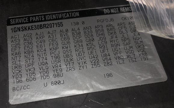

Here are my RPO codes.
The key is 6D6 7D5 and Z55 I think.

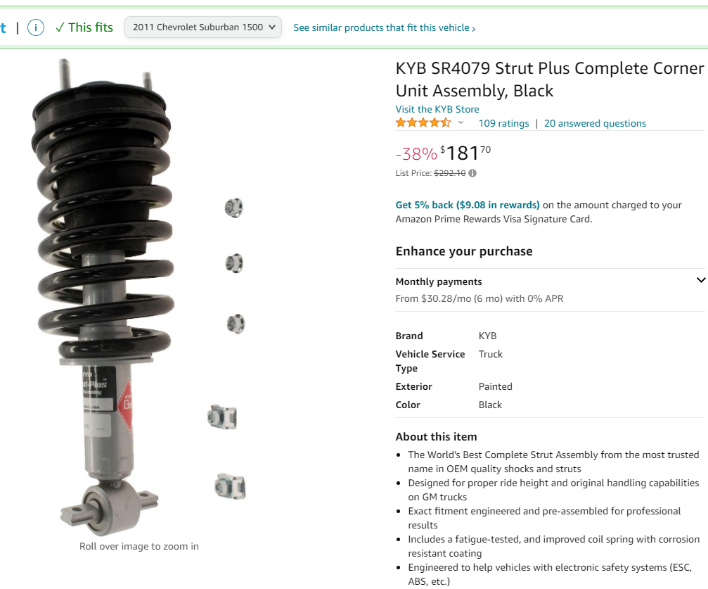

BUT, wondering if the KYB SR4079 with new strut, springs, bearing, boot, hardware for a total of $363.40 would be a reasonable choice?

The reviews on Amazon seem to be really good. But a common complaint I see is that they're stiff. I just looked into them to make sure they weren't the Excel-G line from KYB. Those are junk!

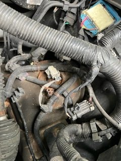

Well I was/am confused. I didn't see a connector on the recommended strut on GM parts giant (or Rock Auto). I do want to stay OEM, so doesn't look like the KYB will work for me. I'll have to pick this back up after Turkey season. Thanks for the replies!

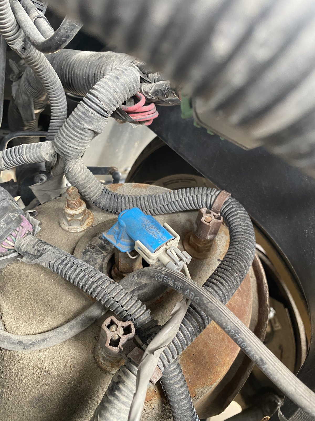

Just to be clear, the connector is on the end of the stem at the top of the strut so it may not be noticeable in pictures.

I would really urge you to verify any part numbers with a dealer based on your VIN before you order anything. There are tons of spring and shock part numbers based on the various suspension RPO codes. I have no idea what the process was at the factory to determine what gets what but some of these trucks have two different part numbers for the front springs left and right and there are also some different shock part numbers based on wheel size. The 2008 and 2012 had the same part number shocks and springs but the 2013 has different shock part numbers and front springs. I would also bet money your springs have sagged/weakened. I replaced the front springs on my 2008 after I lowered it (it was lower than it was supposed to be) and new GM springs raised the front 3/4" and when I did our old 2012 Denali new springs raised the front 1." Hopefully the Chevy does have different springs because I bought that last two of those in the country. The Moog springs cover a bunch of the RPO codes so I don't know if I trust them but if they're the only option, it would probably be better than not changing them at all.

But I definately have electronic struts. I have the level sensors and also the electrical connector on top of the strut.

Unfortunately, the catalogs GM Parts Direct and many of the dealers who sell online are made by a third party and are not all inclusive. Those RPO codes are for the springs, not the shocks. There is a reason all of those web sites want your VIN so they can double check with the real GM parts catalog before shipping your parts. You need to have a dealer look it up by the VIN to make sure you're getting the right parts (you could even try calling Flow Auto Center that run GM Parts Direct). There are different shock and spring part numbers for SWB, LWB, wheel size, etc. The aftermarket makes it seem so simple because they make one part and say it fits all but that isn't the case at the factory. That's why those RPO code descriptions say: computer selected suspension component.
